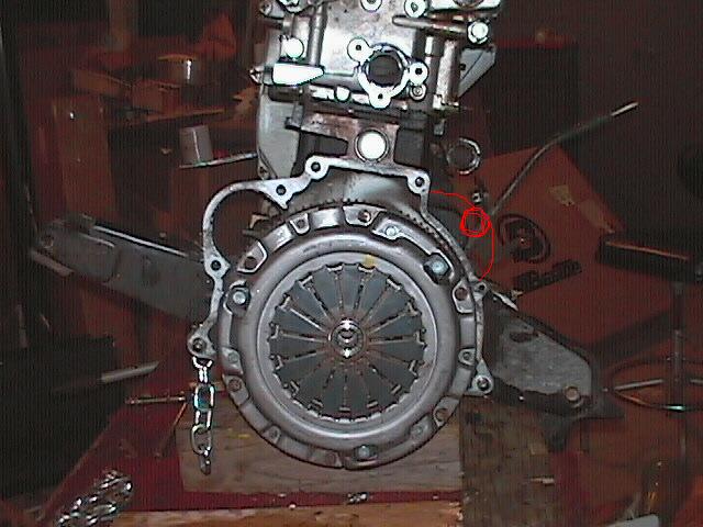

adjsut the clutch, find some real clamps, replace the starter (sounds like a clutch issue) and re-adjust the throttle cable, where it attaches to the intake manifold, so all the slack is out of the cable, but yet not pulling on the cable. You'll be set.

make sure its on there straight, or that you used 2 bolts to hold the starter on..

Check your clutch rod adjustment, 2g's are notorious for ghost pedal which will cause it to pump up.
