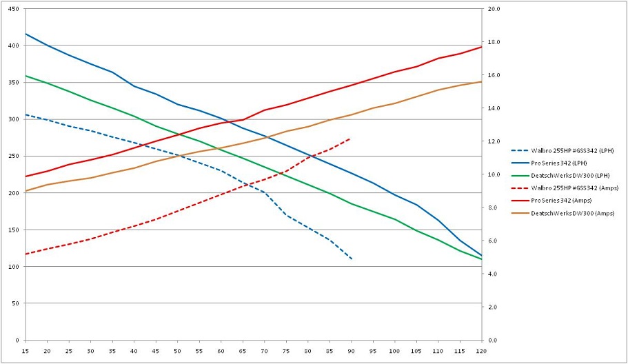

mlomker 05-08-2011 01:12 PM
Re: Evo X upgrades
A flow chart for the Jay Racing "342," which is their competitor to the DW300. I've ordered one of these and I'm going to pull the two 255s out of my Full Blown double-pump that is in the tank. This beast flows over 400lph at low pressures (to fill the surge tank) so having duals would be silly. I think I'll just use the Hobbs switch for the second pump to activate the Weldon pump speed controller when I put that in.
http://www.mitsustyle.com/forums/att...2&d=1304879660
