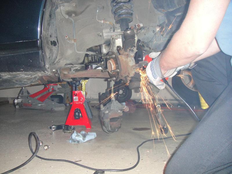

4 Attachment(s)
Got a little bit done today.
This is the fuel tank evap line that went into the charcoal canister which is now under my workbench never to be installed again. I cut this line back so it ends underneath the car. May do something more with that later but it's fine for now. So here you can see that evap line that I removed. Also that is where the stock ABS and charcoal canister used to be, so I have a nice big empty corner there now :) http://mitsustyle.com/forums/attachm...1&d=1291780568 Picked up a Tee Fitting (3/8-24) from Vatozone. So on the Tee side they will be standard fittings, but on the car components they will still be metric to mate up to their respective components. Bought two lengths of 3/16" line from Vatozone as well. This is some sort of copper alloy which is nice to use as it's easy to bend. I still have to flare one end of it but you can basically see how it is routed here. This is the Tee for the front brakes. So it will just leave the master cylinder, go into the Tee and from there two lines will come out (1 for pass side and 1 for drv side). So that is the only line I've made so far, but I consider it a success as I worked slow to try and make it as nice as possible, and it was the first line I've ever made before so it's not perfect, but not bad for the first time :) http://mitsustyle.com/forums/attachm...1&d=1291780568 http://mitsustyle.com/forums/attachm...1&d=1291780568 So 1 line down. Figure I can slowly just work on and aim for 1 line a day, and then the brakes should be done. |

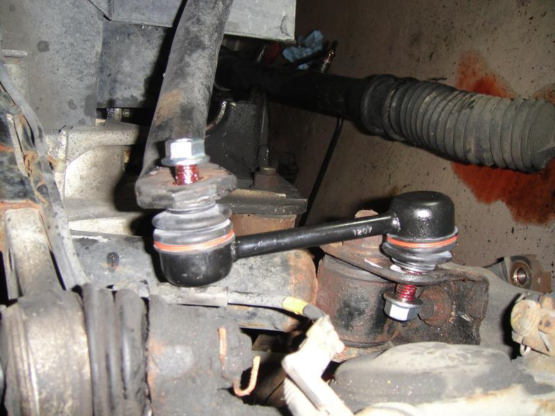

10 Attachment(s)
Front brake lines are all mocked up. All I need to do is some flaring which I think is going to suck, haha. Here's some pics, showing how the line is routed.
http://mitsustyle.com/forums/attachm...5&d=1291951586 http://mitsustyle.com/forums/attachm...1&d=1291951601 The line from the bottom of the Tee, coming down then bent right under the brake booster, then bent straight again to continue going towards the front of the car http://mitsustyle.com/forums/attachm...1&d=1291951601 Same bend as shown above, but from further back so you can see the last bend that takes it through the gromet and into the fender well http://mitsustyle.com/forums/attachm...1&d=1291951601 http://mitsustyle.com/forums/attachm...1&d=1291951601 Drv Side Fender Well, mating to the stock flex line that goes to the caliper http://mitsustyle.com/forums/attachm...1&d=1291951601 Back to the Tee, showing the line that runs along the firewall towards the passenger side http://mitsustyle.com/forums/attachm...1&d=1291951601 Line along the firewall, now on the passenger side. http://mitsustyle.com/forums/attachm...1&d=1291951601 Showing the bends that take it into the fender well http://mitsustyle.com/forums/attachm...1&d=1291951601 http://mitsustyle.com/forums/attachm...1&d=1291951601 Pass side fender well. http://mitsustyle.com/forums/attachm...5&d=1291951801 |
