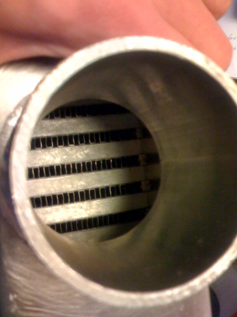

I hate e85 right now. Bought some really clean used BlueMax 1350s about two months ago, put around 600 miles on them. And I get this shit, even though they are e85 "safe".
I'm going to do a tank of pump gas during motor break in and see if they clean up. Apparently people on the dsmlink forum have had good success with that cleaning them up. I'll also clean them up best I can with some carb cleaner.
I never had a huge issue with the 1600s building up goop, maybe it's the Iowa stations that have this junk in them, I always go to the same one here.
