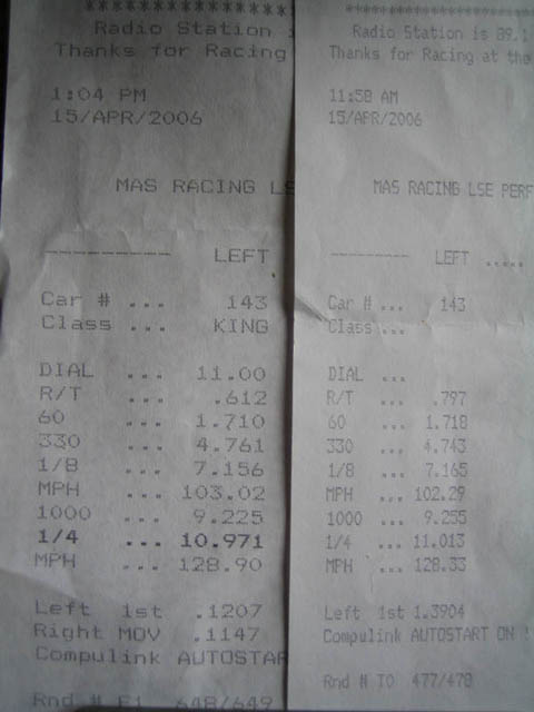

Yesterday the Eclipse finally ran a 10 second pass at the track with the FP3052. The 60ft times were low 1.7s. After about 15 passes and a few issues involving crappy driving the car finally ran a 10 second pass. The end result was a 10.971@128.90 and it was backed up with a 11.013@128.33. There was no nitrous used, the boost was at 31psi, AFR was around 11.9:1, timing maxed about at 18 degrees and the car weighed 2980 with driver.
The mods are: Engintecs Built 2.0 (Ross/Eagle, FP2 Cams, Double springs), Quartermaster twin-disk, DevoTuning built tranny, 850cc injectors, Aeromotive AFP, Supra pump, DSMLink, Magnus SMIM, Spearco 2-216, MAFT, Zeitronix Wideband, KYB AGX, Falken Azenis 205/55/16. Here are the timeslips: |
