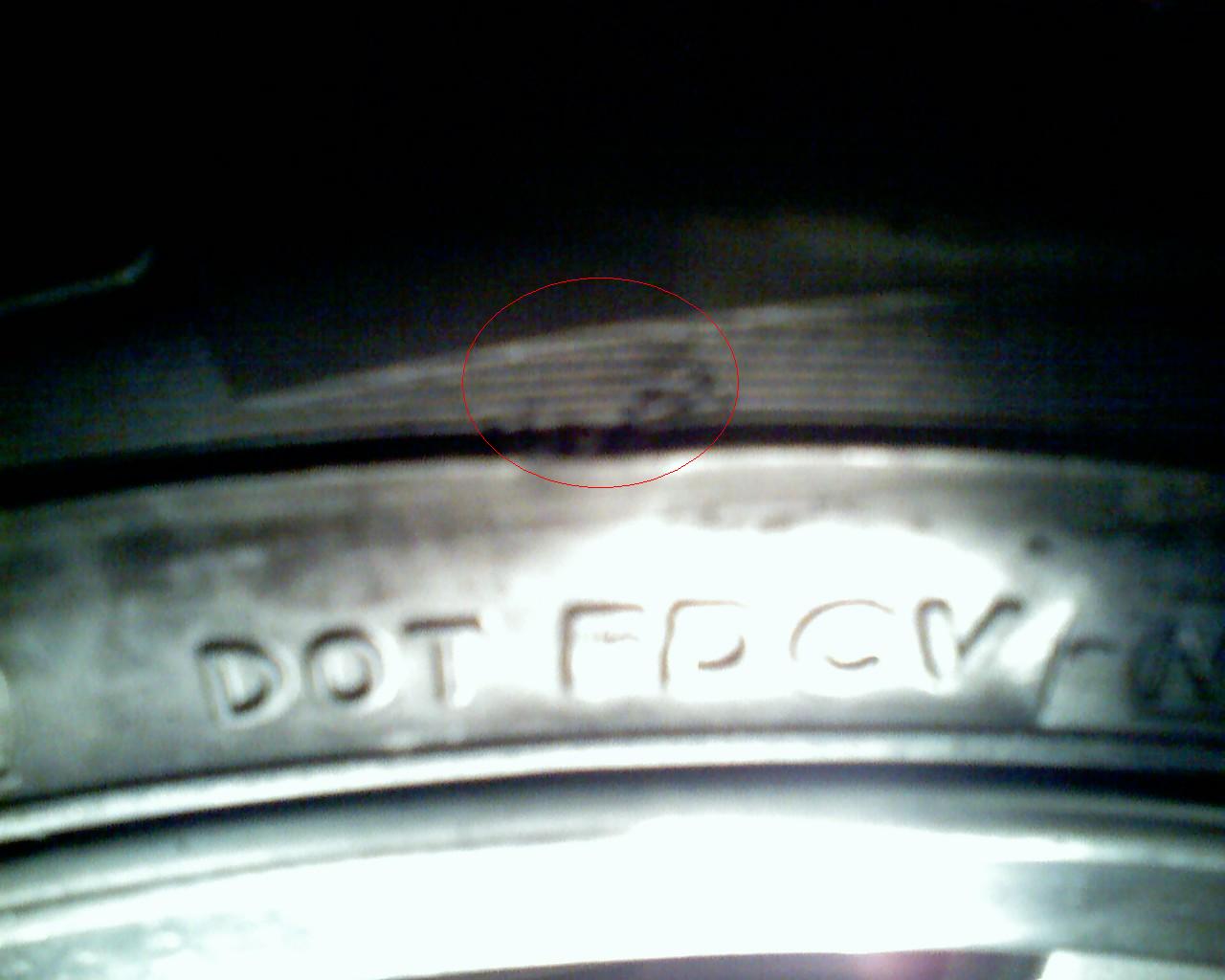

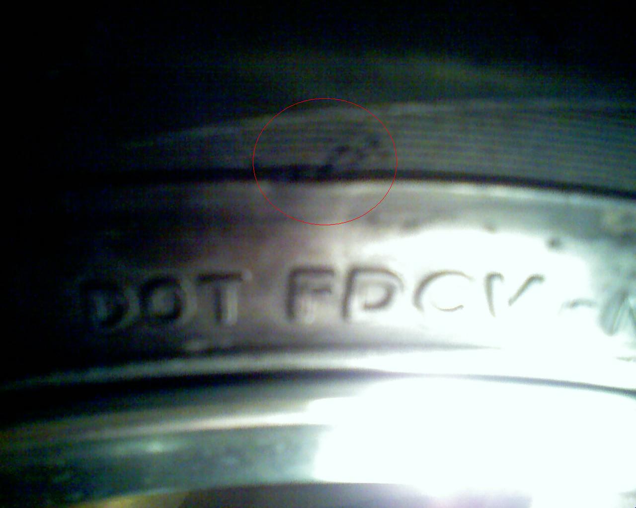

Hey guys, one of my front Yokohama Parada Spec2 tires has been losing air. I filled it on Sunday to 35 psi and yesterday it was down to less than 15# so I took it off to inspect it. Couldn't find a single issue with the road surface of it. Here I found about a 3/4" cut just above the normal side wall. I already ordered a tire on Monday but since this tire only has 3500 miles on it, I'd like to know if it could be repaired as spare. I don't know if where this cut is, that there are steel belting or whatever. The are not deformaties(bulges) of the sidewall from the damage the cut made. I've been read about patching from the inside where they run a patch from bead to bead. At $170 a tire I'd really like to use it later on down the road if needed. See attached pics.
Thanks for any info.

Well just by looking at those pictures it is sort of hard to tell where the cut exactly is. Depending on how high it is on the sidewall, it would be possible to put a patch-plug on it, but it's not 100% that it would hold. The patch that you are talking about that goes from bead to bead is called a boot. Not too many tire places use a boot anymore, and I dont think that would help you in your situation anyways. If I could get a better idea of exactly where it is at I could help you a little more on your situation.

Where your cut is at is not going to be repairable according to RMA (rubber manufacturers of america) standards, and there are no steel belts there either. I wouldn't fix it. Sometimes shit like this just happens, but it's not worth trying to half ass it and just fix it and risking the tire blowing out on you. Where'd you buy the tire at?

that tire does not look repairable. i doubt a plug would hold, and even then i wouldnt use that as a spare. sorry man, shit happens.

It is not repairable; generally the hole or tear has to be atleast 1" from where the tread ends towards the inside of the tire. If you plug or even patch it from the inside and its even close to where the tire flexes it will not stay plugged generally.
You would have to do it yourself as well if you wanted to fix it because most tire shops will not patch them unless they meet certain requirements.
