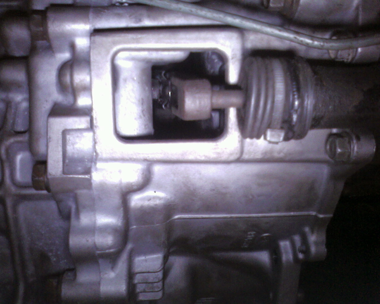

I have a L4 Competition Clutch w/fidenza flywheel, all new.
I drove the car, but the clutch was not dis-engaging properly, so I red up on TREs website, and it says that you have to shim the pivot ball in order for the clutch to work properly.
So i pulled the trans off, threw a couple washers under it and put it back on the car, so here is a picture of how the clutch fork sits.
What i NEED TO KNOW is: is this the right resting place for the fork? keep in mind this clutch is completely different then a mitsu or an act clutch , the fingers on the pressure plate are almost completely flat
I DO NOT WANT TO PULL MY TRANS AGAIN, IT WAS GAY.
so, is this the correct?
Thanks alot!
4seasons69 11-20-2007 11:43 AM
Re: Clutch Problems
it looks alright. it should be towards the drivers side of the center line of the release fork. look on vfaq theres a good bit about it on there.

iceminion 11-20-2007 01:44 PM
Re: Clutch Problems
I have pulled at least ten transmission with ease on DSMs
This is on a GVR4, which is a hybrid DSM/3000GT platform, something is difficult which made this just a little more difficult, I am used to doing the transmissions on the ground and this time I am doing it on a drive on hoist, that might also account for the difficulty. Anyways, its gay and I dont want to do it again.
I couldnt get the clutch to let go when it was un-shimmed, I put a socket on my slave cylinder rod, which allowed me to shift in to gear (barely) and thats how I got to drive the car.
Now, after the shim, my socket extension removed, I can get the clutch to let go, but still dangerously close to the floor (I tested this out by putting a 1/2 racket on the crank bolt, and trying to turn as hard as possible, and having my brother push down on the clutch pedal.
Straight from TREs website: "...and don't be tempted into trying a lengthened clutch slave cylinder rod. The only way to properly correct the clutch offset geometry is by shimming the pivot ball. By properly shimming the pivot ball your clutch will work much better and your transmission will thank you."
So now that I have corrected the geometry of the clutch, one would assume that it all works out fine, WRONG, still screwed.
so, how do i get this damn clutch to let go about 1/2 way through the pedal travel?
I can try putting the socket on the end of the slave cylinder rod, and since that helped before the shim, one would think it would help after the shim.
anymore input anyone? the system has been bled properly, master and slave are not leaking, do you think I should replace the master? I have a new one, but its not easy for a huge motherf*cker liek myself to get down there and unbolt everything.
Thanks

Pushit2.0 11-21-2007 04:16 PM
Re: Clutch Problems
Bent throw out fork is my guess.
~John
iceminion 11-25-2007 12:53 PM
Re: Clutch Problems
sadly, I dont have another fork to compare this one to, it doesnt look bent to me.
If this is my stock fork, it worked great with the 2600, if it is NOT my stock one then it has to be out of a car with a less then 2600. All my dsm parts kinda got mixed up when I had all the cars taken apart....
but chances are its not bent, can you tell from the picture? I assume its going to be a tiny amount of bending.
I have my cannon with me now, I can get a higher quality pic, assuming that you can diagnose a bent forlk when its in the car...
