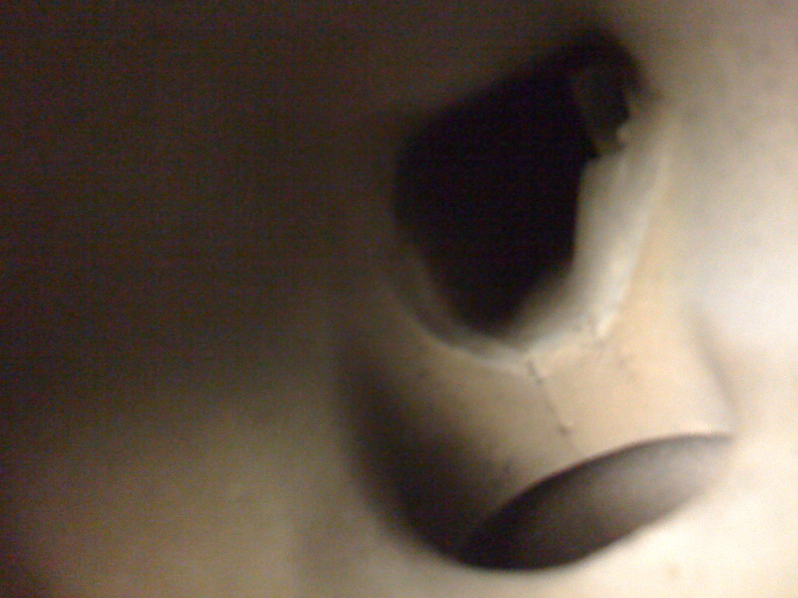

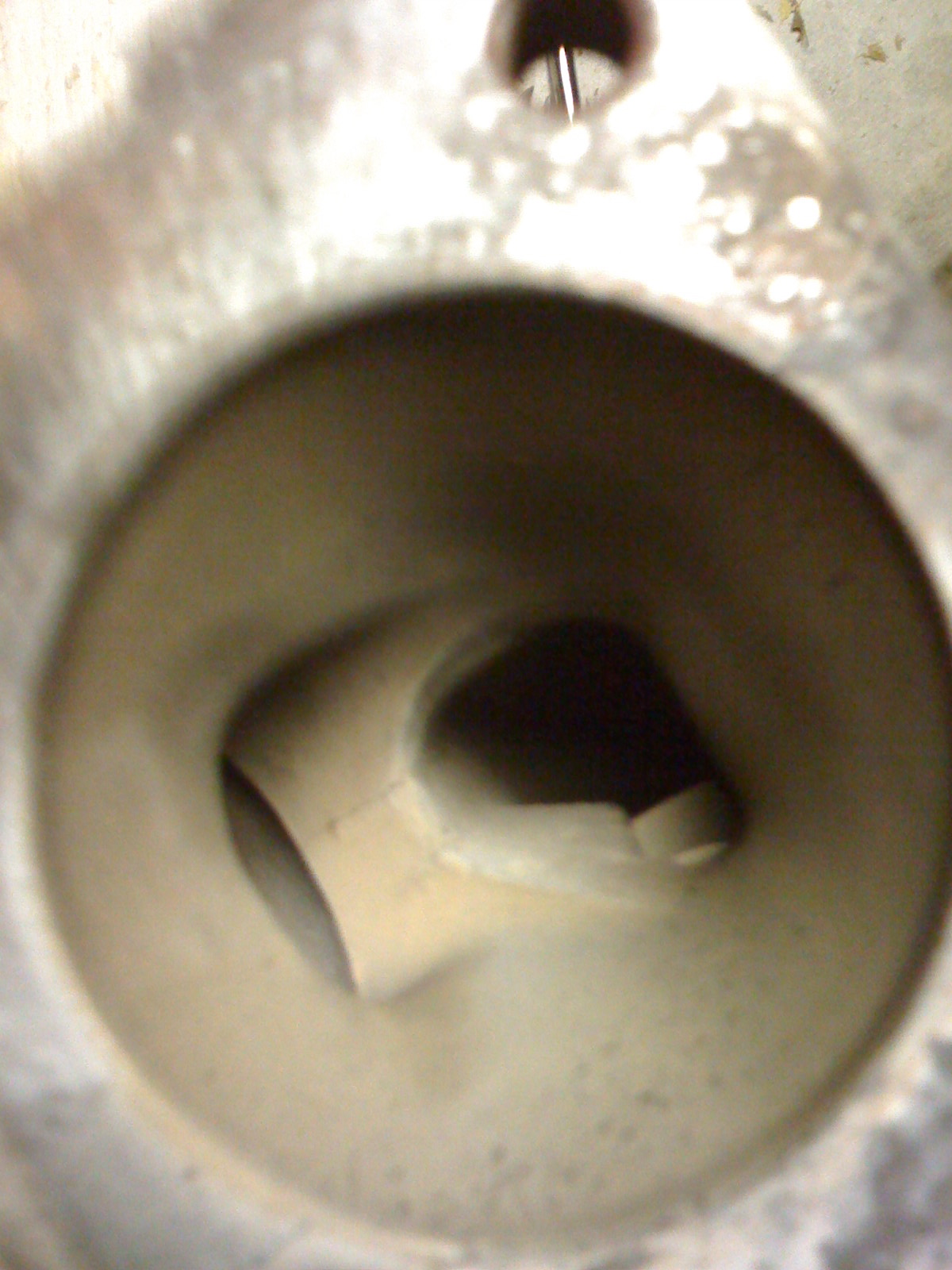

Re: Turbo problems
Take another look at the turbine wheel, is there something up with that?

^^ Not sure what you mean, but I took better pics from the inlet showing the wheel, also some from the side showing the crack on the wastegate hole and also of the turbine wheel.

1 Attachment(s)
I was talking about this. It might just be the angle.
asshanson 11-25-2008 11:09 PM
Re: Turbo problems
Ah I see now. I just checked it and the little notch is part of the housing, like a small casting nub. You can see it in the other pics.
