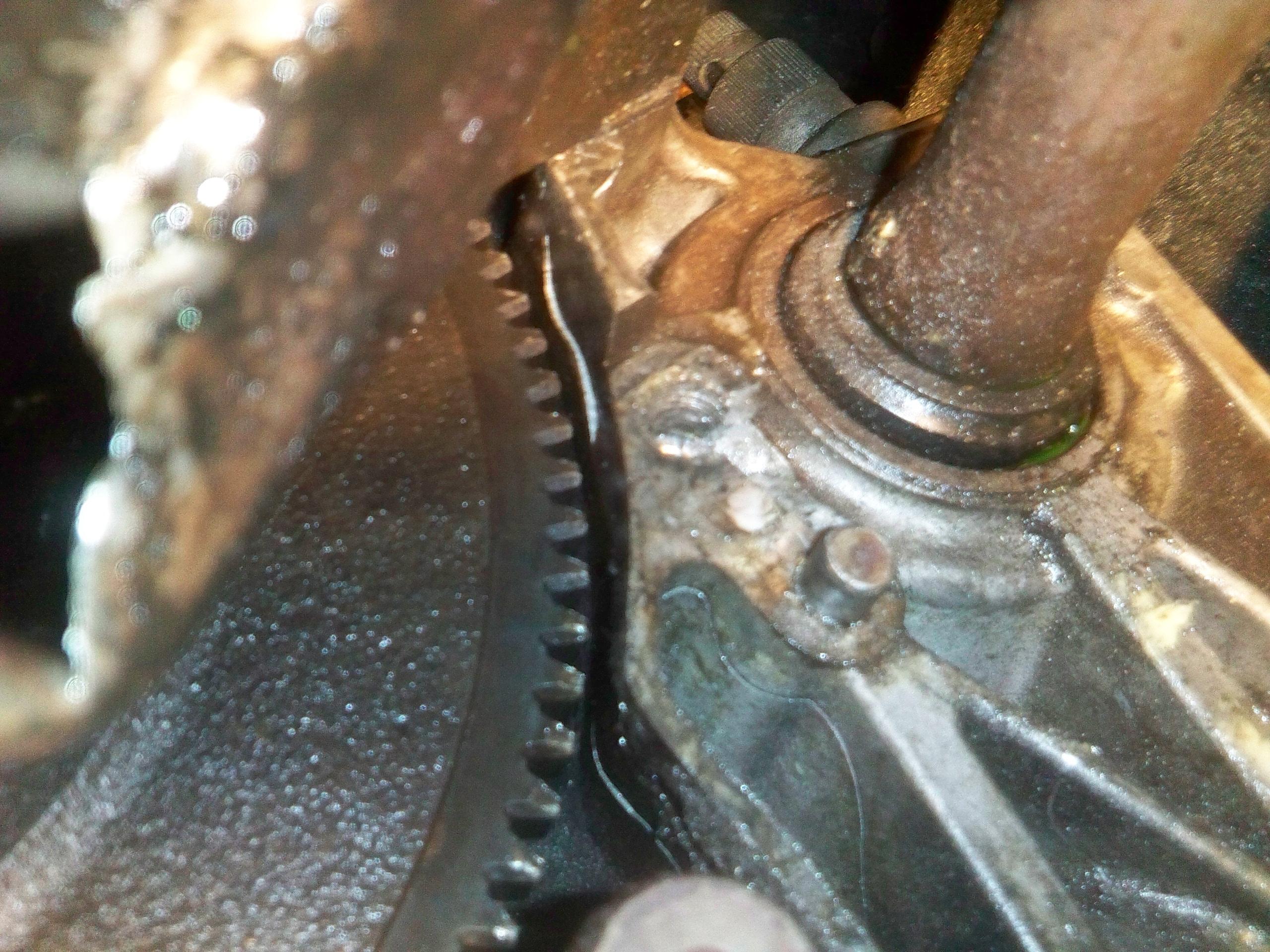

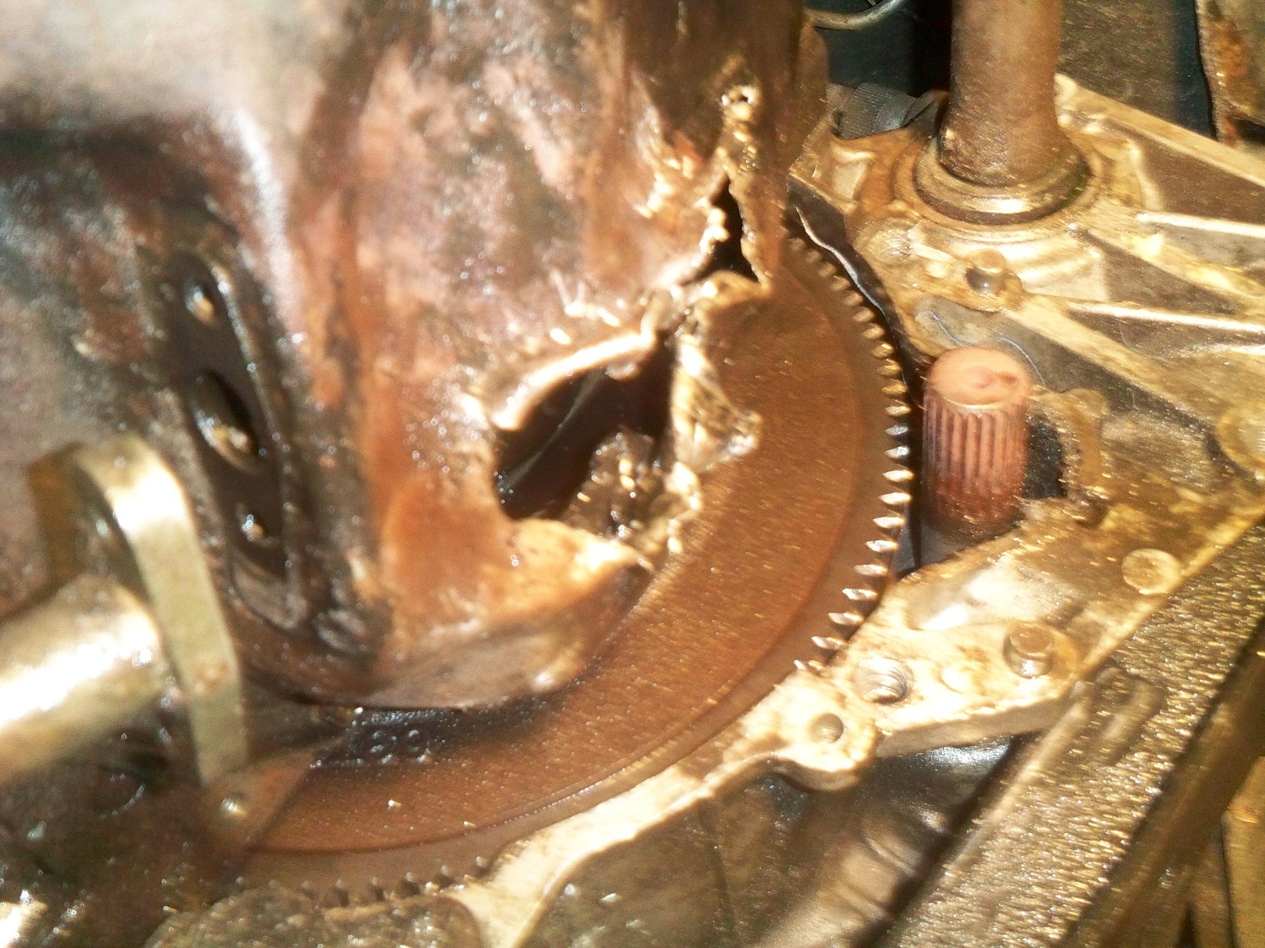

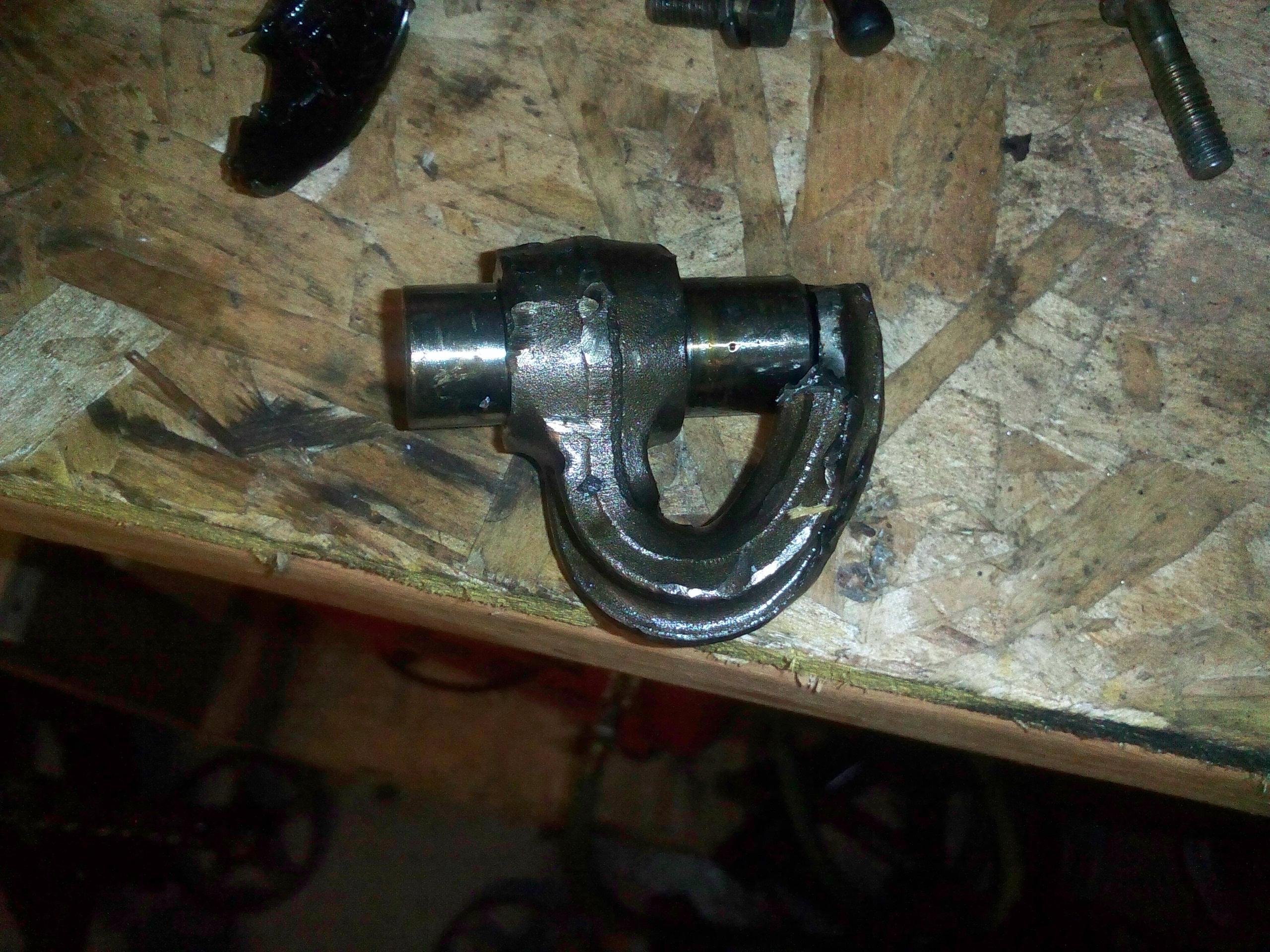

3 Attachment(s)
yeah here are some carnage pics Attachment 9295
Attachment 9296Attachment 9297

Is that 3rd pic a rod!!
way2fastalon 10-13-2009 12:18 AM
Re: dam dsms
i guess it went boom she said ... yea that is a rod the piston is shattered in a million pieces i don't even want to pull the head off to look inside the balance shaft is locked up i know that for sure on the t belt it took about 13 teeth off and then snapped

Damn, the second and third picture... that would be my avatar. I can't even begin to imagine how the rod in the third picture got that way. I feel for ya man.
