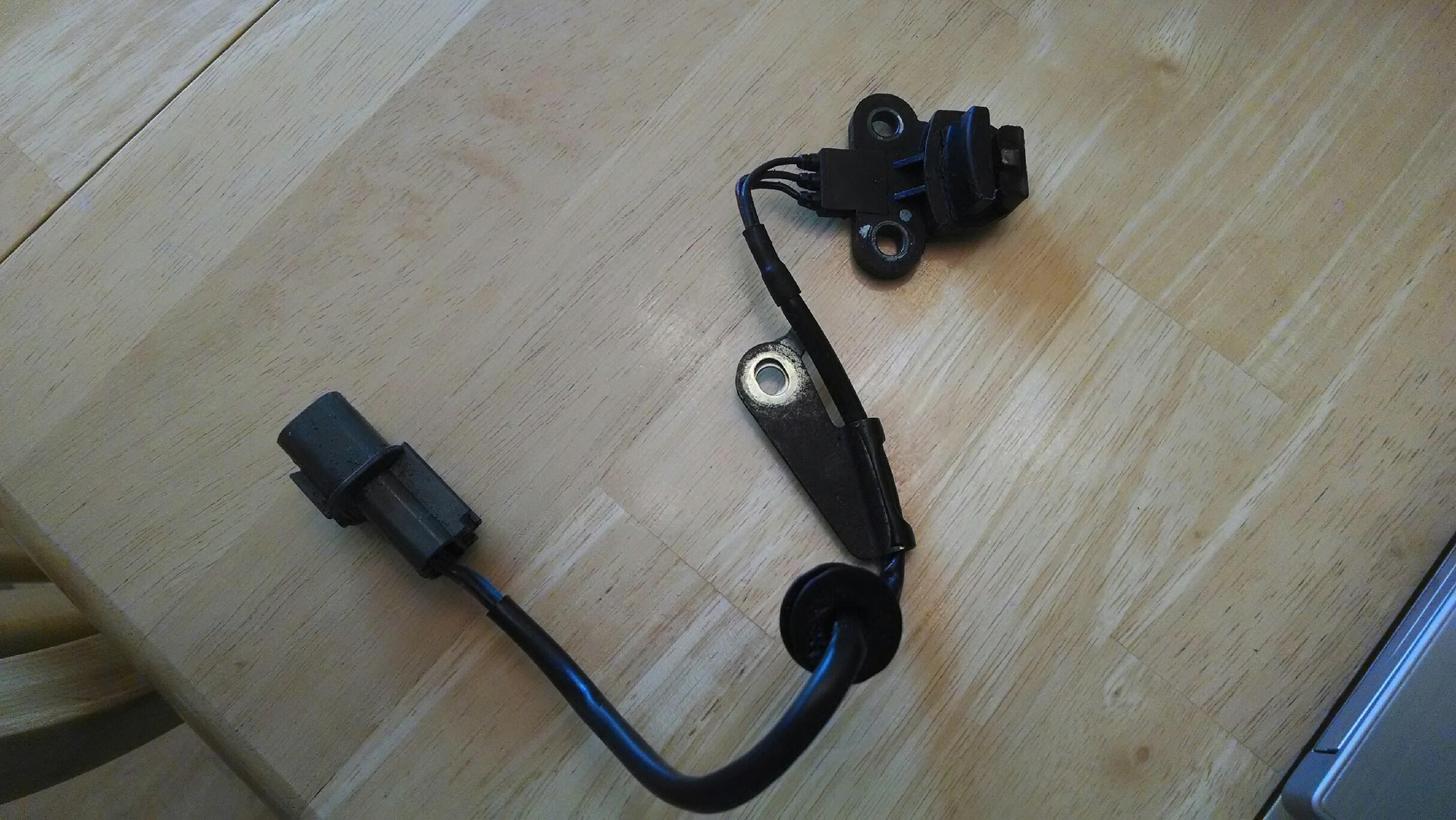

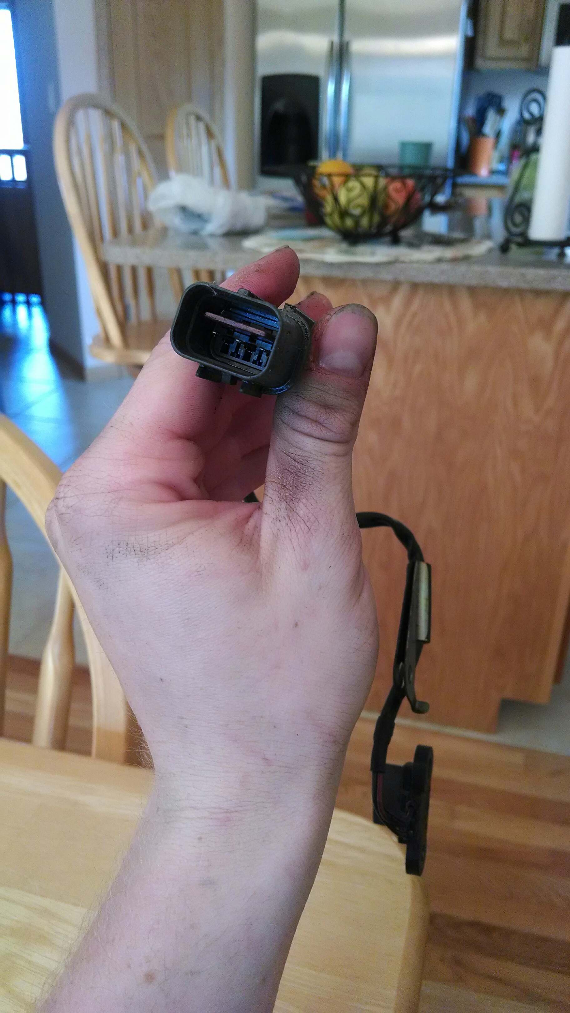

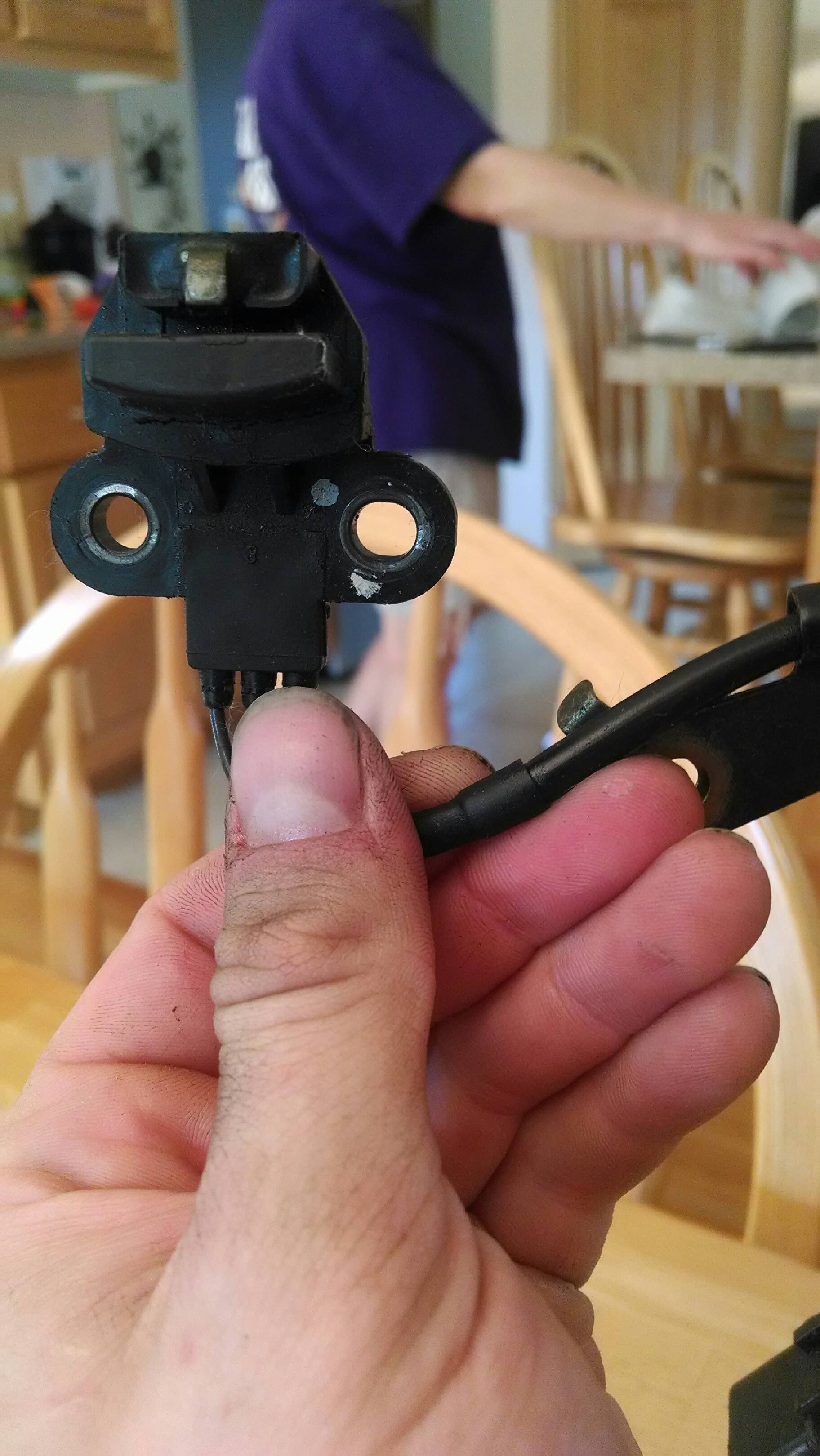

I am almost done putting my car back together after having the head off. I cannot figure out where this hooks up to. I know it is the cam position sensor and it sits behind the intake cam, but I have no idea where the connector plugs into.
Please help! Im hoping to get this running asap.
Thanks,
Cole

I think it might have been on there still from when the previous owner put a JDM engine into it. It has the CAS on the passenger side of the intake cam and that is actually hooked up.
So my question now is, do I even need this?
TkrPerformance 07-05-2014 08:03 PM
Re: Where does this sensor go?
If you have a 1g cas you do not need that one

so this pic is the crank sensor right? I feel like missing something here, but if I truly have no need for the sensor behind the cam gears and only the sensors in this post then I can take that out? no harm to anything?
carltalon 07-06-2014 03:24 PM
95 and 96 had the cam sensor behind the cam gear. All others had it on the end of the cam. It looks like you have a 97-99 style cam sensor so you shouldn't need the one behind the gear.
