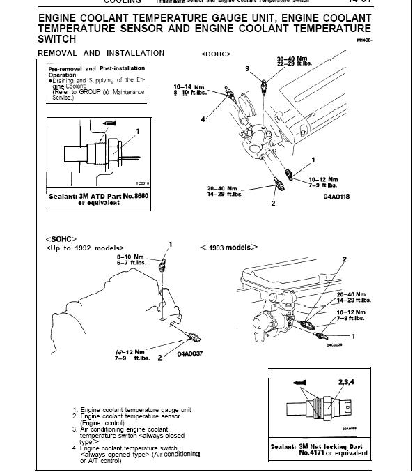

I don't think there is easy way to check the FIAV.Its not bypassed or hacked is it? If not, I would just clean the hell out of the TB/FIAV/ISC and see what happens.

And by that diagram, it looks like the sensor I am seeing is number 3, so it shouldn't really matter if the wires are semi broken on that one as it is just for the AC. The AC doesn't work in this car anyways.
