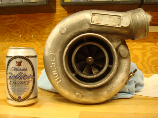

I decided to go with an HX40 (actually and H1E but it has the 8 blade 58mm inducer compressor wheel), 1600cc injectors, V3, E-85 on speed density running around 25 psi for now being that i'll be running on a stock 7 bolt bottom end right away in the spring. After a full build and tranny work i'll be over 30psi. No real power/timeslip goals yet, just gonna go with the flow and see where time and money takes me. I'll be happy once i pass the 500whp mark. Here's some pics and thanks for looking guys!

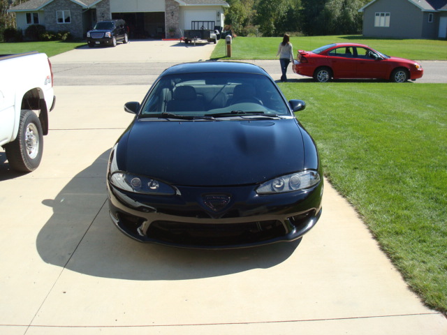

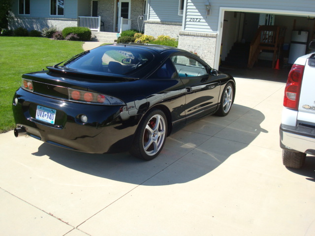

Here are pics
