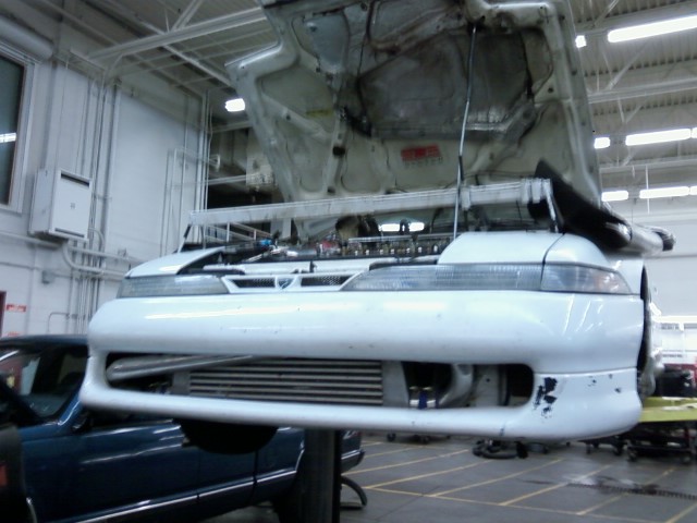

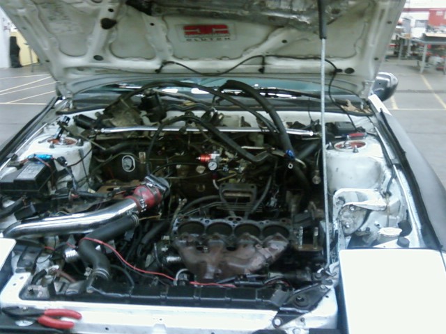

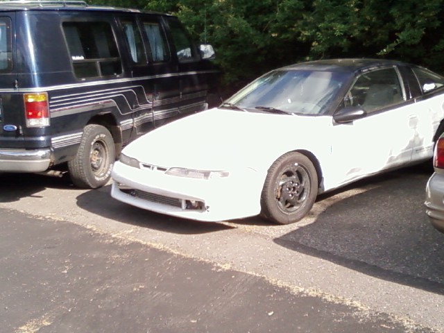

here's my little project

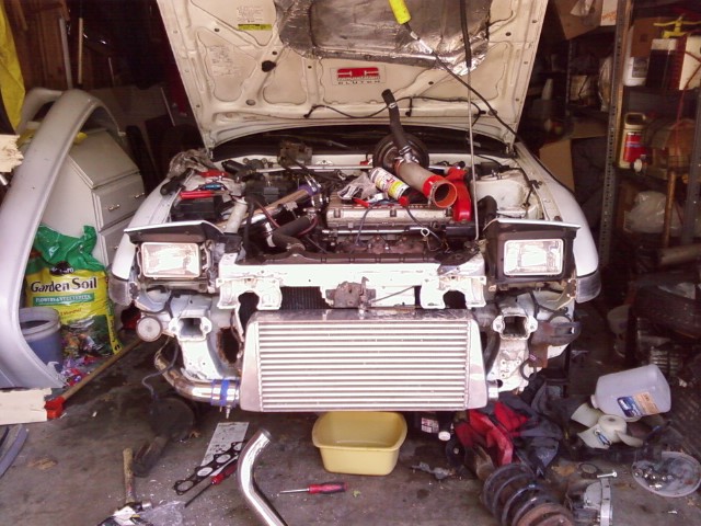

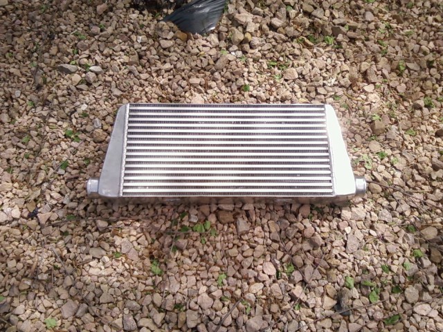

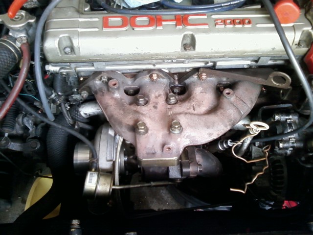

well I guess I've been working on this thing long enough to share a little bit with all of you. when I bought it it was bone stock. I've done lot's of maitenence like everyone else. but as for mods lets see I'm running a bullseye power t04b vtrim turbo, ported o2 housing, 3in turbo back exhaust, fmic with 2.5in piping, gm 3in mass airflow sensor, maf-t, 2g throttle body elbow, walbro 255lph fuel pump, aeromotive fpr, 650cc injectors, safc2, stage4 clutch (it was cheaper than the stage 2), fidanza aluminum flywheel, and ksport coilover kit. I think that is most of it for the mods

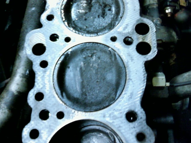

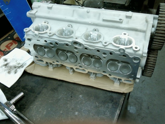

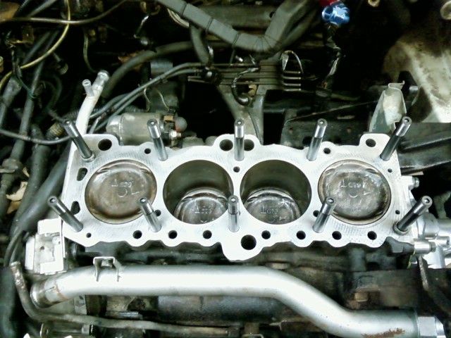

Re: here's my little project

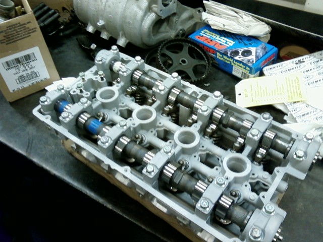

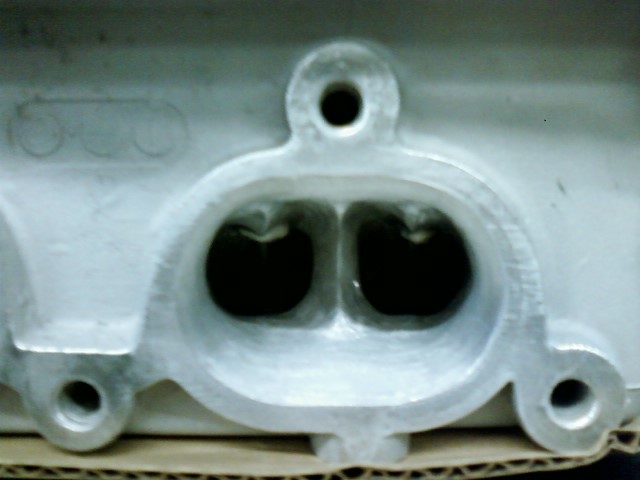

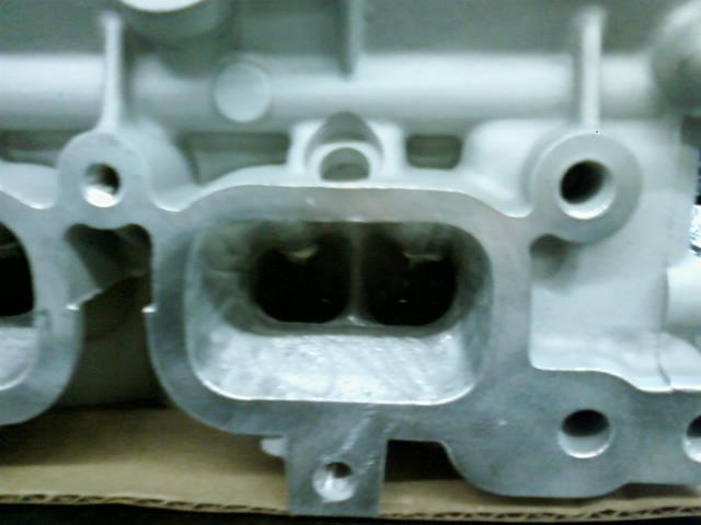

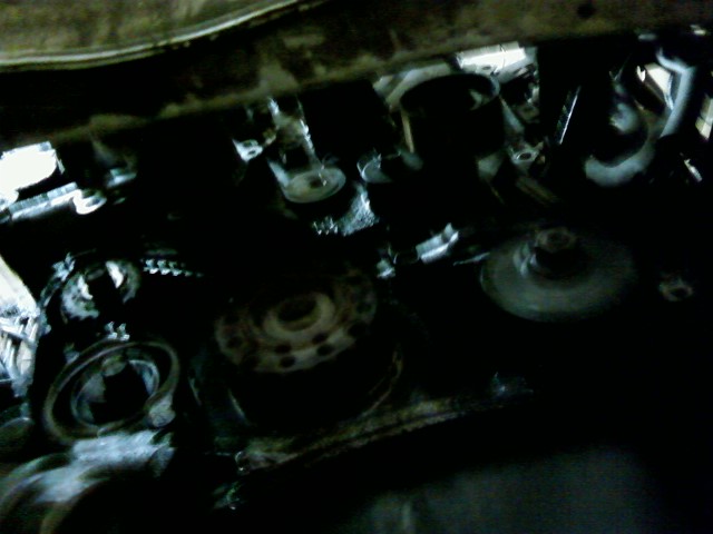

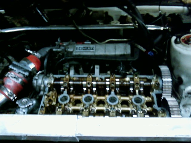

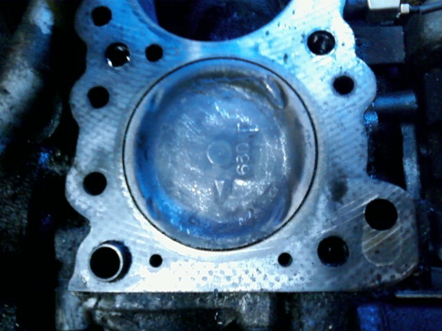

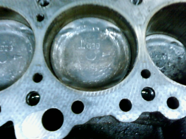

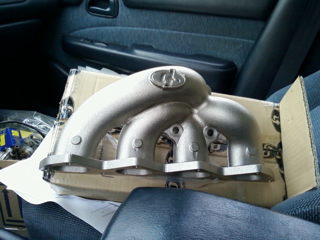

now here is what I've been working on at school the last week. I had the head rebuilt ported and polished, bc 272 cams, and an fp cast race manifold. a cometic head gasket and arp head studs will be going in as well. I've never been able to get this thing to run quite right but when we were taking it apart the timing on the intake cam was a little bit off and there was a ton of carbon build up on the pistons

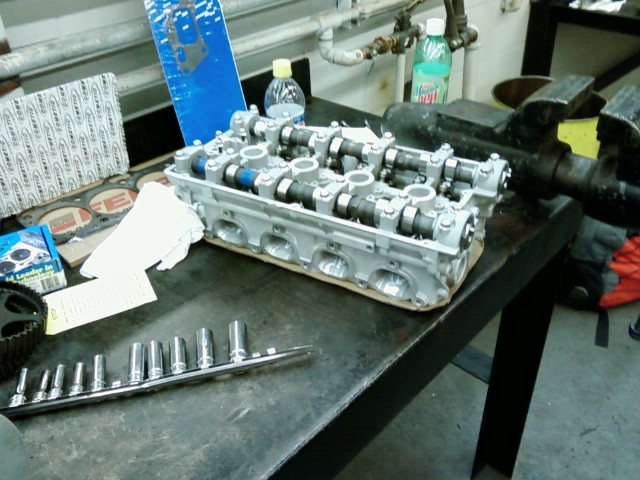

I just got the head back from the head shop on friday (cylinder head express in blaine they do awsome work) so it will be going back together soon. I'll get more pics and info as we are putting it back together

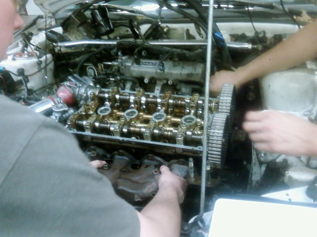

well here are some more pics and an update. we got it back together last thursday but we started it up and oil was pissing out the side by the cams. turns out the head shop didn't put cams seals in when they put the cams in and we made the mistake of not catching it before we put it together. but cam seals are going in on monday and then it should be back on the road
