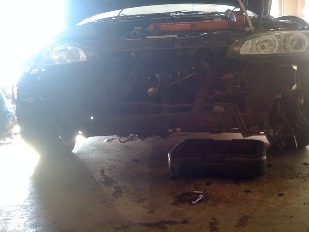

Tearing out piping and AC

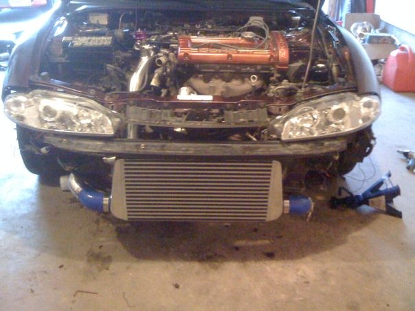

The new piping

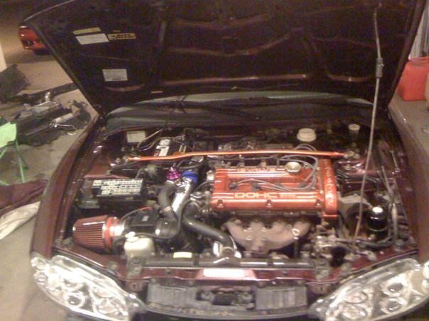

Gotta love a free knock off BOV, its temporary, but at least its better then the plastic stocker

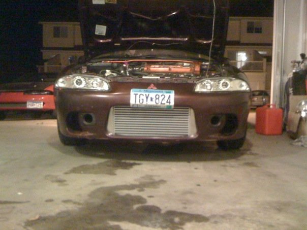

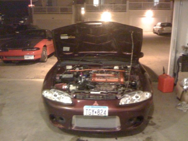

All done
Just having some fun
