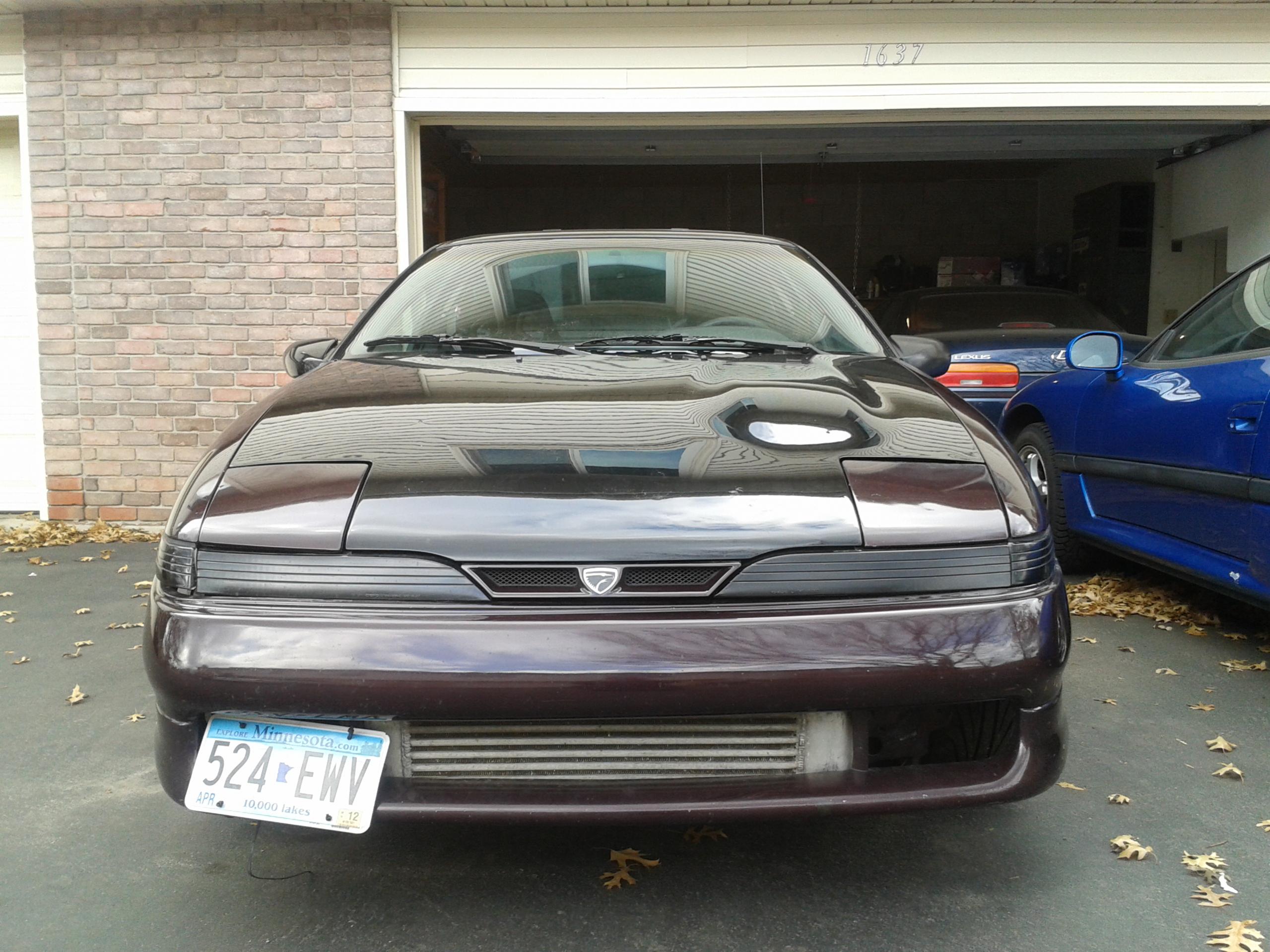

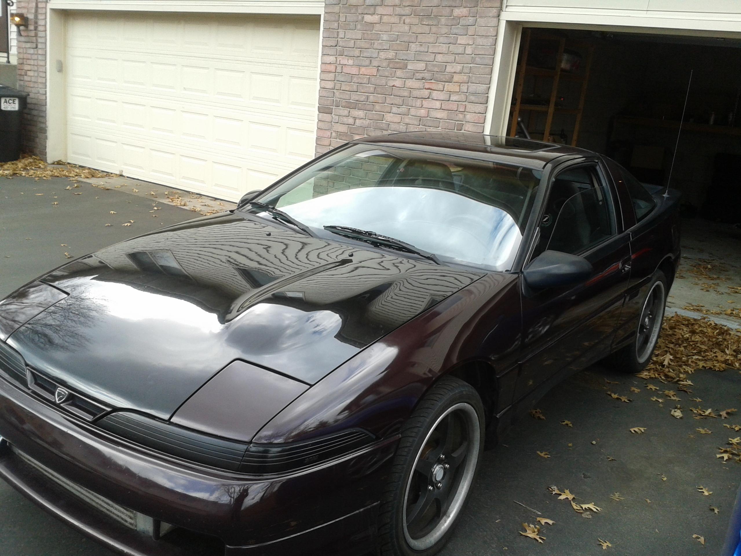

So this build thread is long overdue and should have been started about a year and a half ago when i originally bought the car.
And so the story begins roughly 1.5 years ago when i bought a beautiful maroon 91 talon tsi shell from Halon. That winter i swapped out the drivetrain from the current 91 talon tsi i was driving (Thanks to pushit2.0 and his crew for doing all the work while i sat around). The swap was a success and after a random no-start issue and the help of turbotalon1g got it running again.
After all that i ended up moving and with work, i was just to busy to give it any love except from time to time. after having issues getting it to run right, poor alignment, rattling pieces, and eventually giving the t-case death whine. I lost interest in the car and along with a lack of funds decided to trade it for a good DD in the form of a lexus sc400 and some cash on top.
A few months later it was up for sale again at about $2k more than i traded it for. I missed the car and all but i wasnt going to spend that much money. another few months after that it was for sale a 3rd time, however this time it was less than i sold it for. The issue was that it was running horribly and not firing cylinder 3. The kids mechanic told him compression was 150-150-130-150 and the low compression was causing the problem stating a bad head gasket. after a short test drive i decided to take the risk of buying a poor running dsm and had it towed home.
Got her home and started my own tests. compression was 150 across the board, spark was good, along with all 4 injectors being good. but cylinder 3 just wouldnt fire. spark plug came out wet and the cylinder was wet. after sitting for a few days stumped as to why a cylinder with compression, spark, and fuel wouldnt fire it dawned on me to pull the ecu. low and behold, ecu damage!
Grabbed a socketed eprom ecu from 93gtpeater that day and had her running on all 4 later that night, WOOT! The fuel injector seals are still junk and causing boost issues but that will be fixed shortly. seals are already on the way.
The end result is that i ended up getting the car back for less than i let it go for, with about 2 grand of extras done to the car. got it back with some nice 18 inch rims with good rubber, upgraded from painted stockers with crappy rubber. a set of corbeau seats that fit my fat ass. an alignment. nice catchcan. and a few other misc goodies here and there.

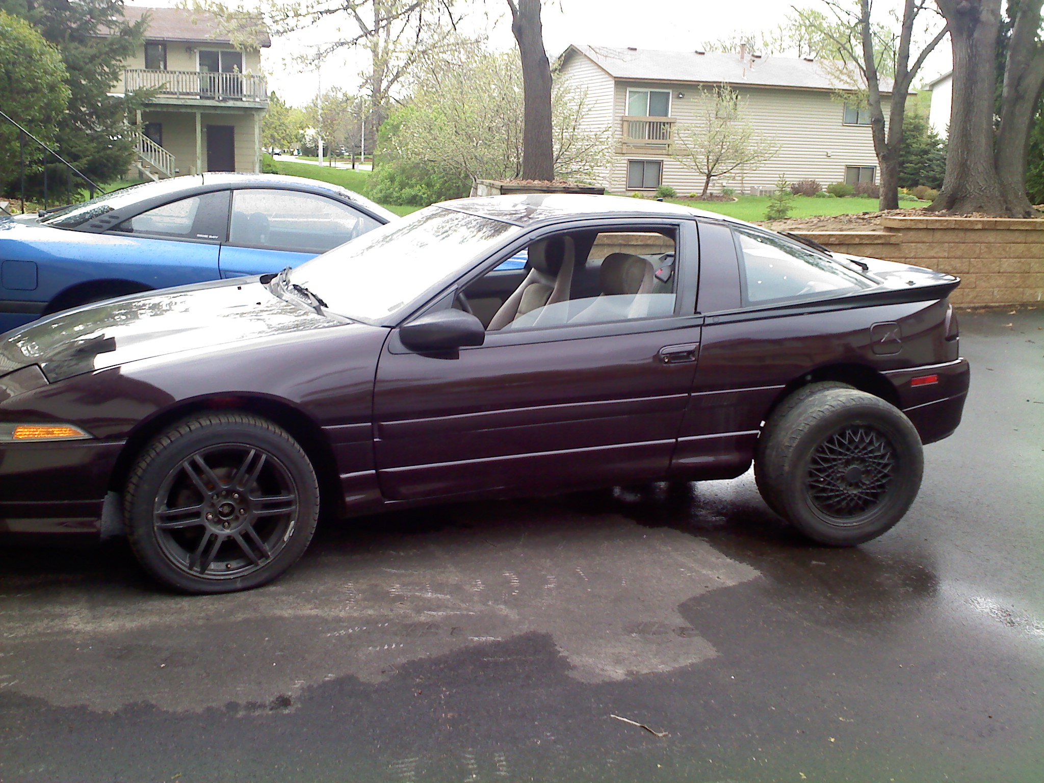

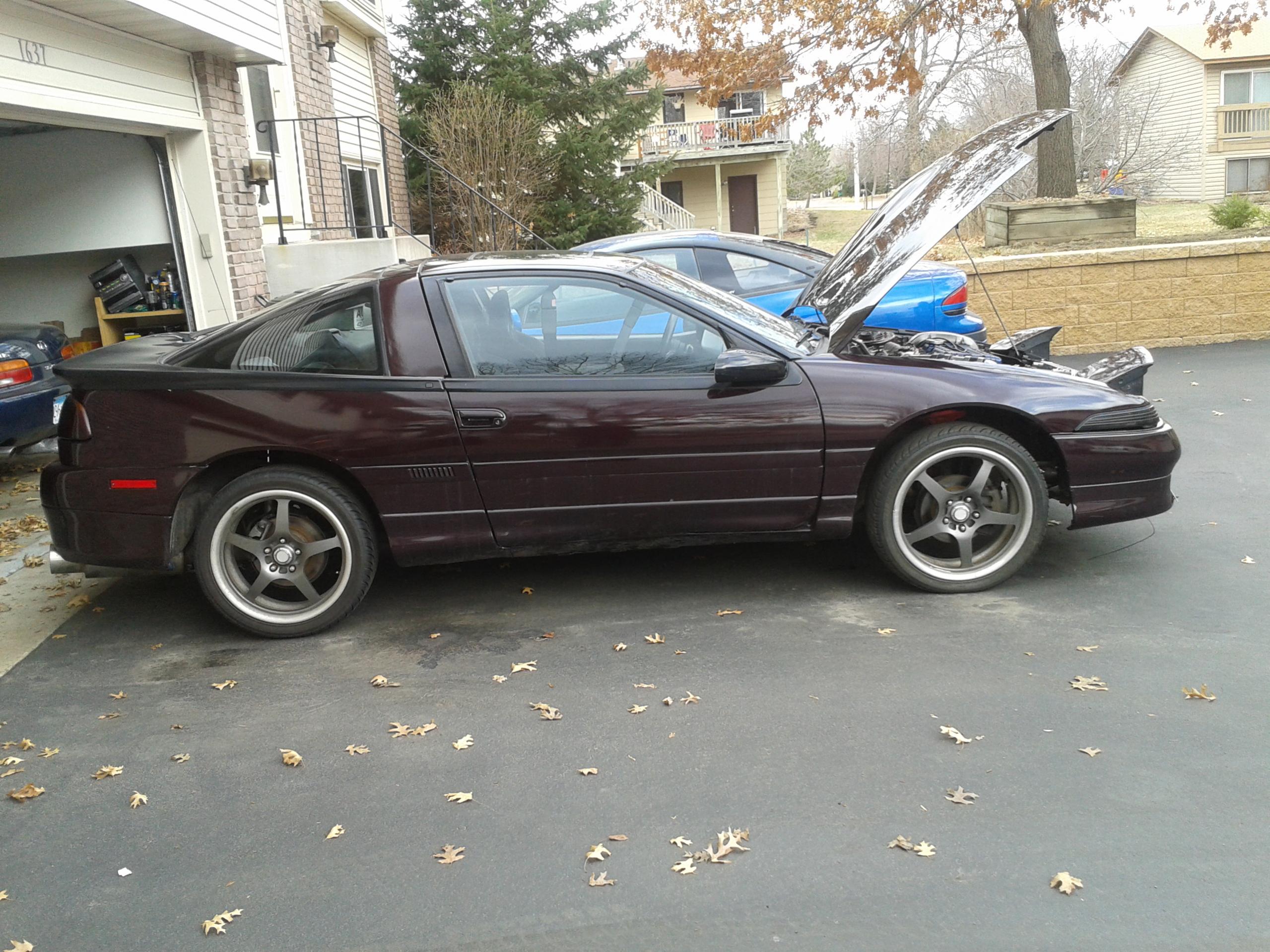

These are from before i let the car go.
ID:	12317   Click image for larger version
ID:	12318   Click image for larger version

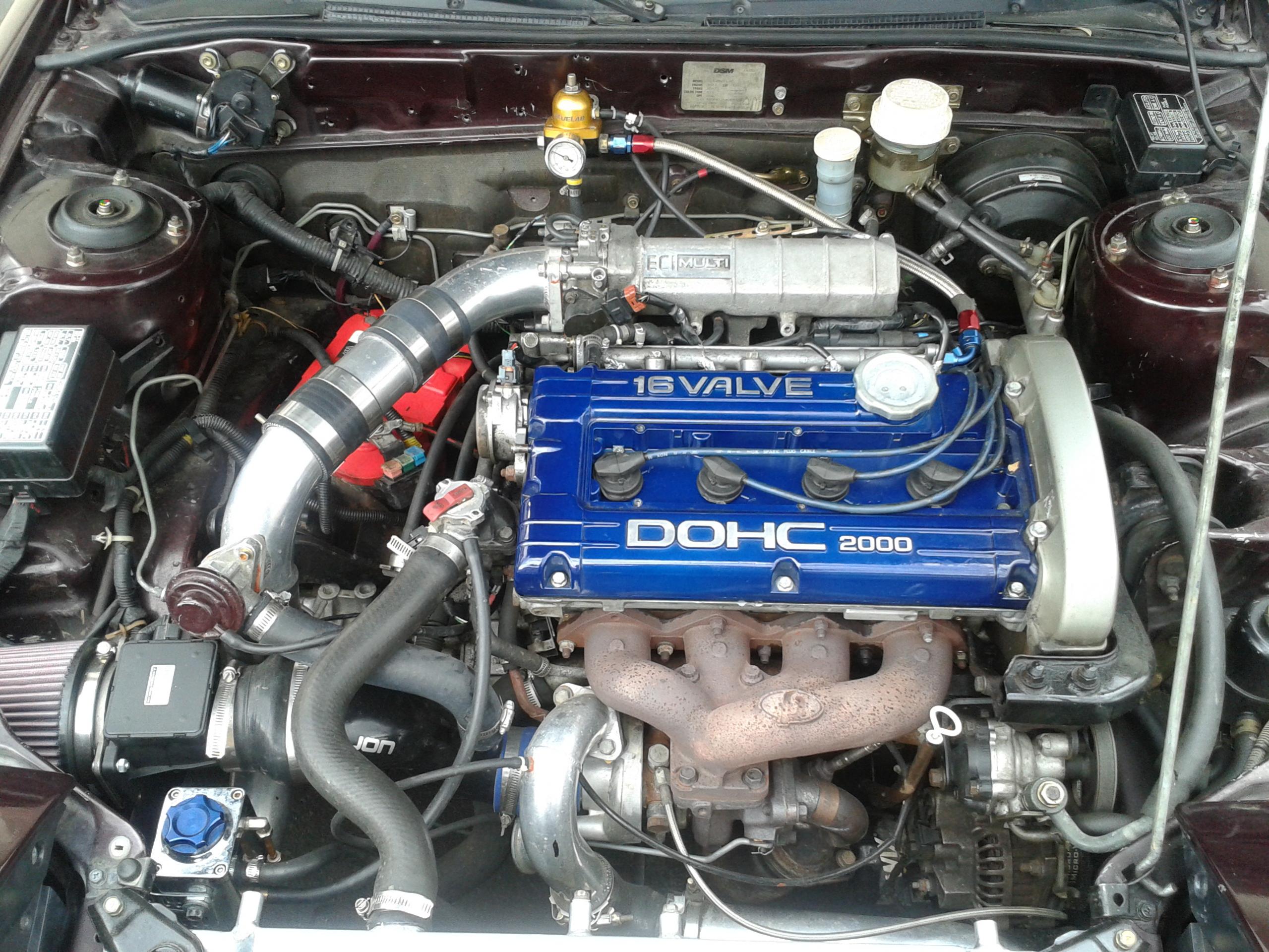

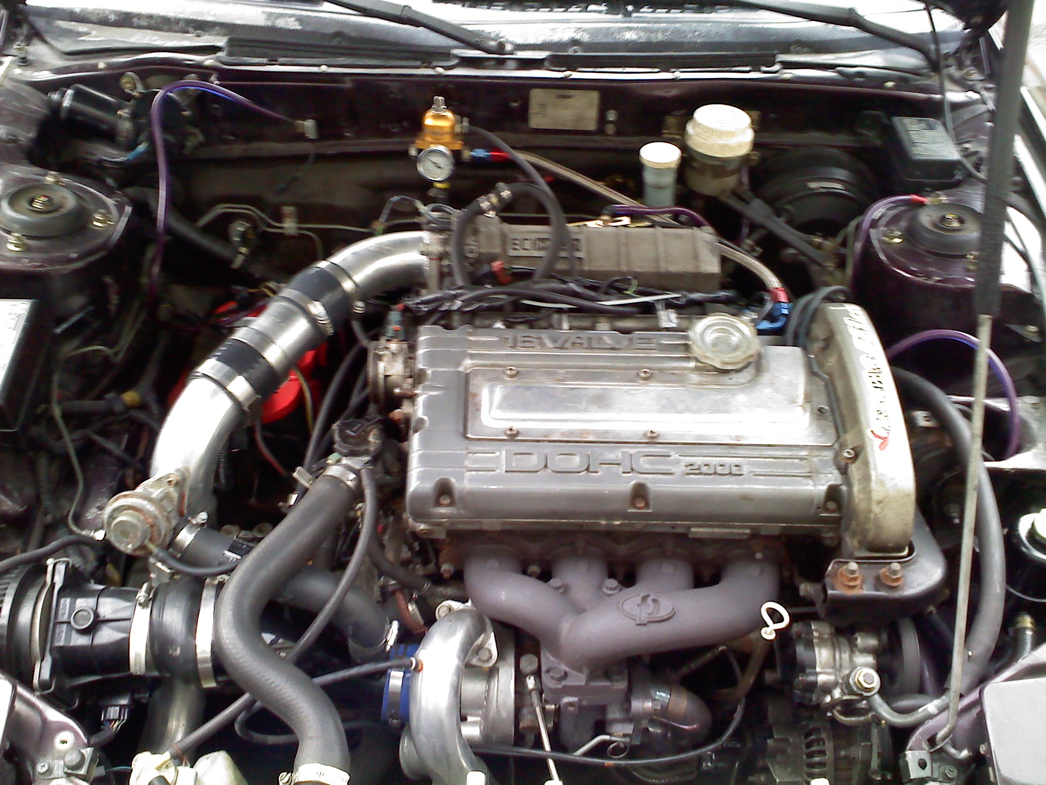

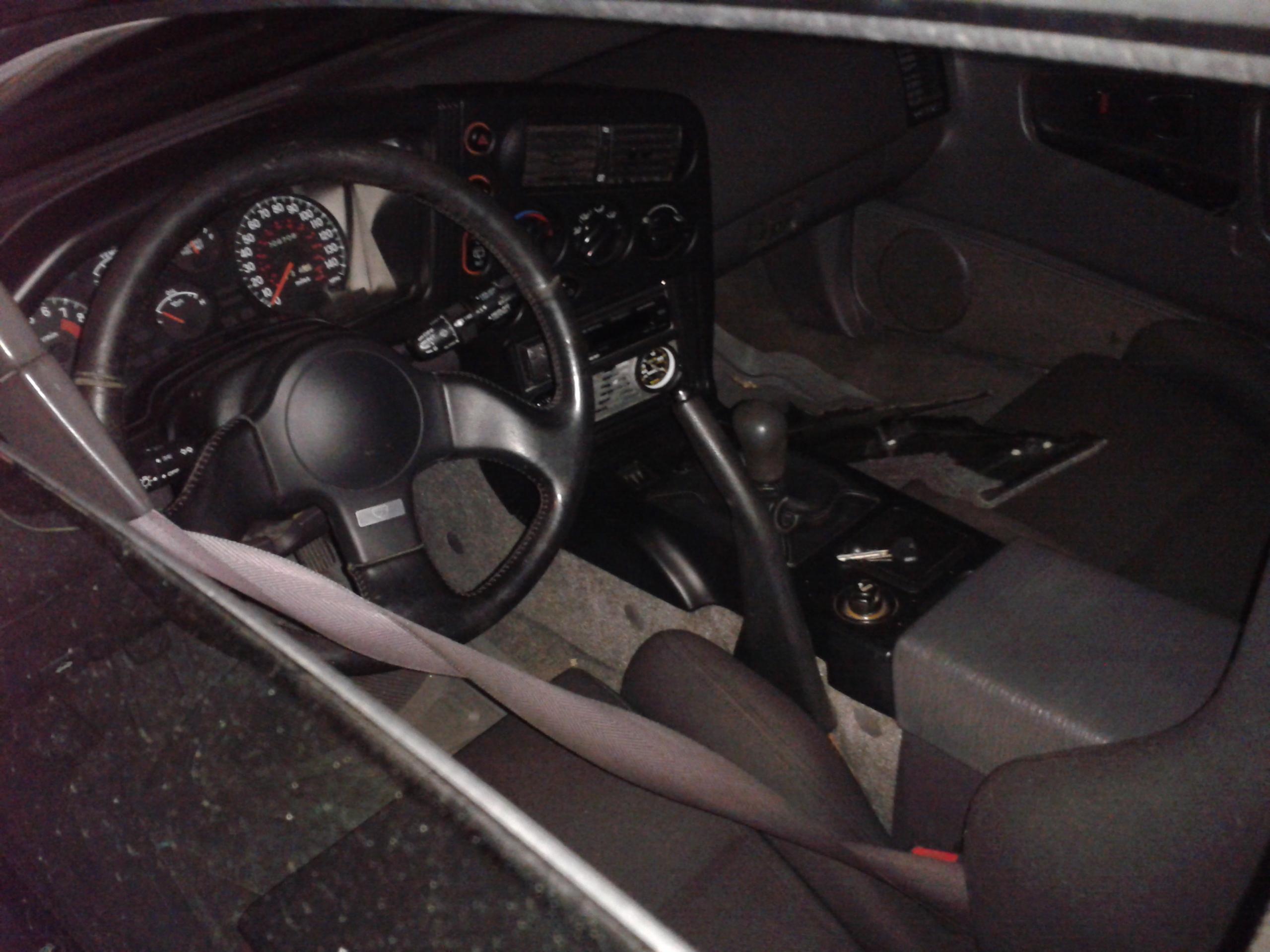

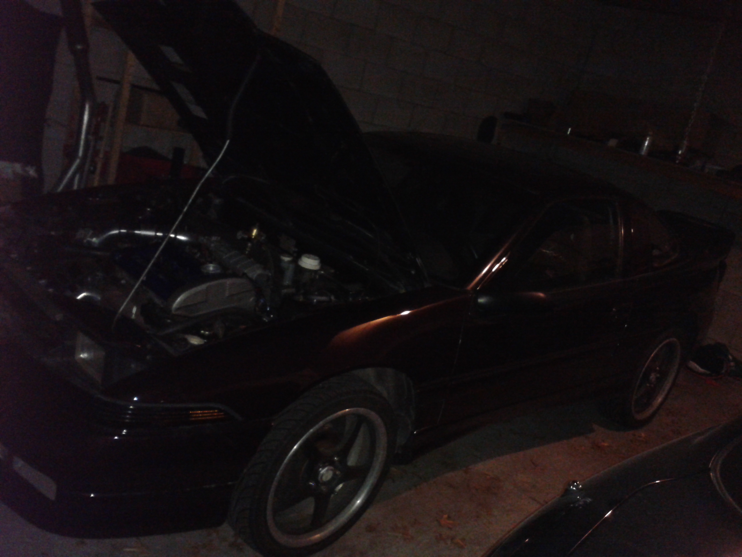

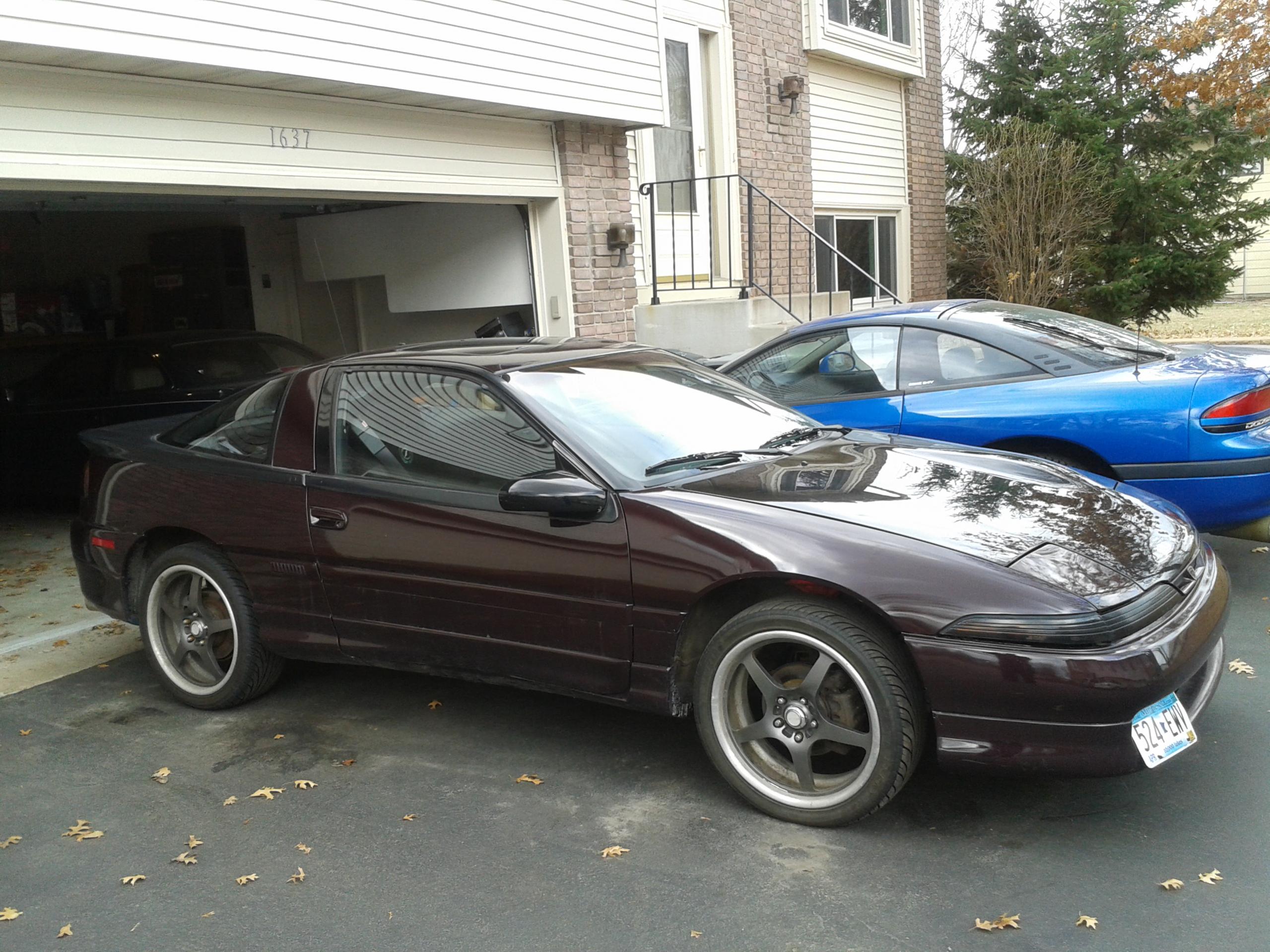

Here are some more i took just tonight. obviously after buying the car back
also i did the wire tuck around the fuel rail the day before selling the car.
Gotta say, even with all the problems these damn cars have. i sure did miss it.
Will also be grabbing some more tomorrow when the light is better. there isnt shit for lighting in my garage.

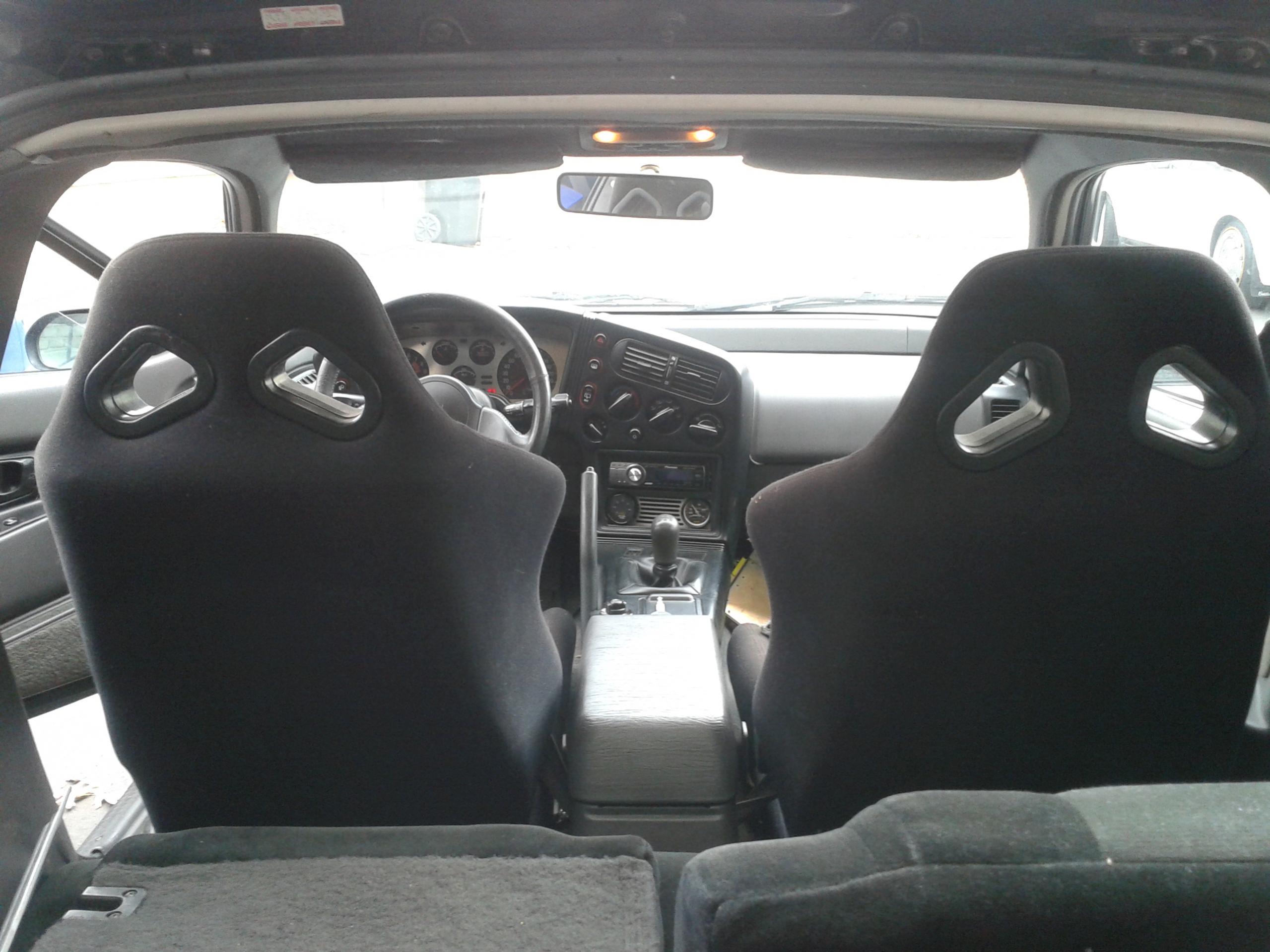

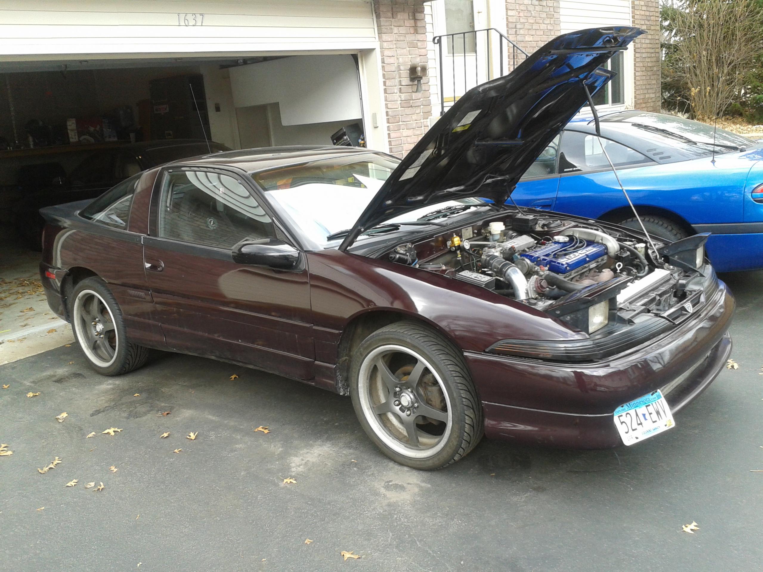

just grabbed these. she needs to be cleaned for sure.

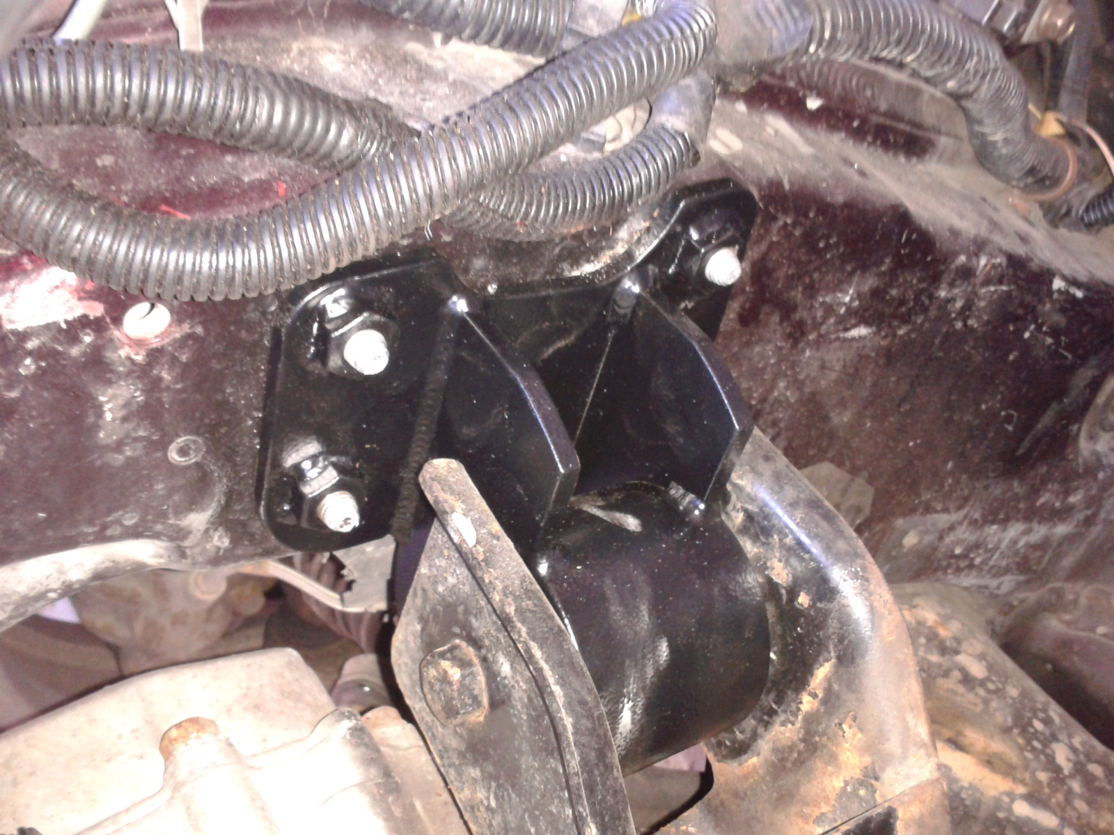

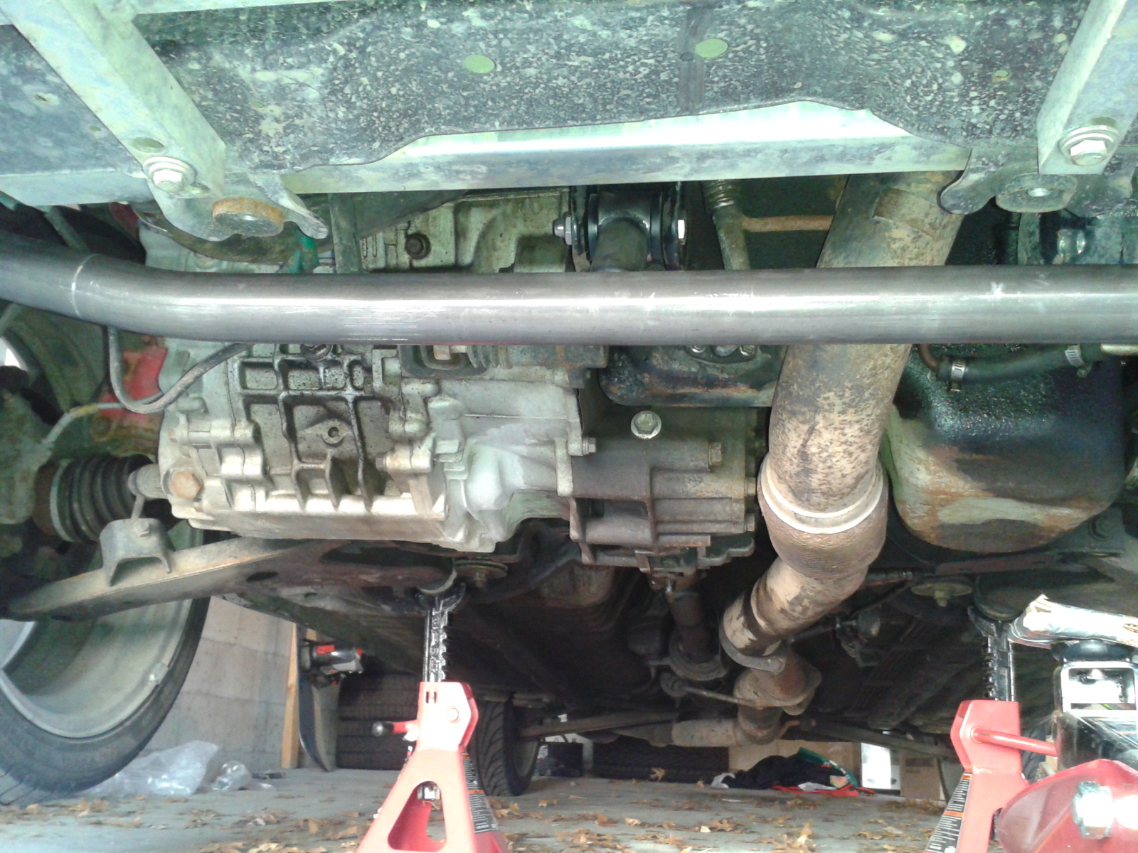

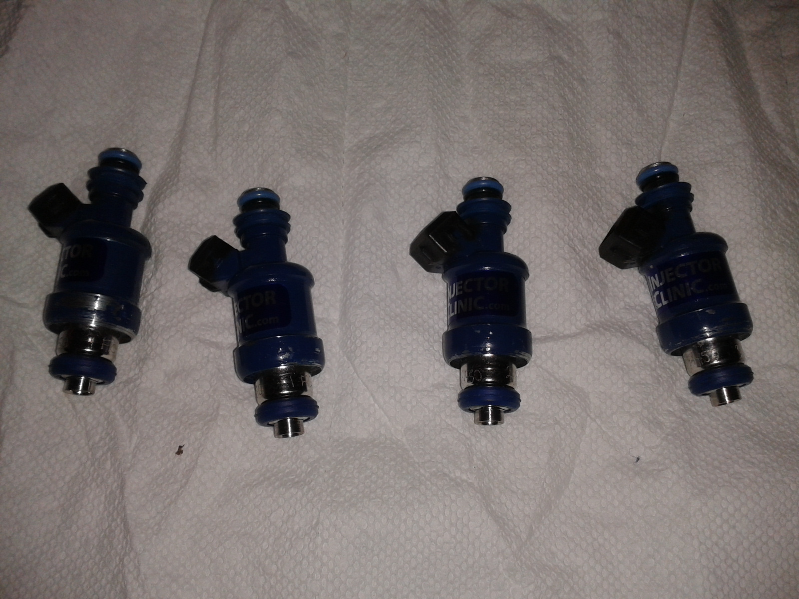

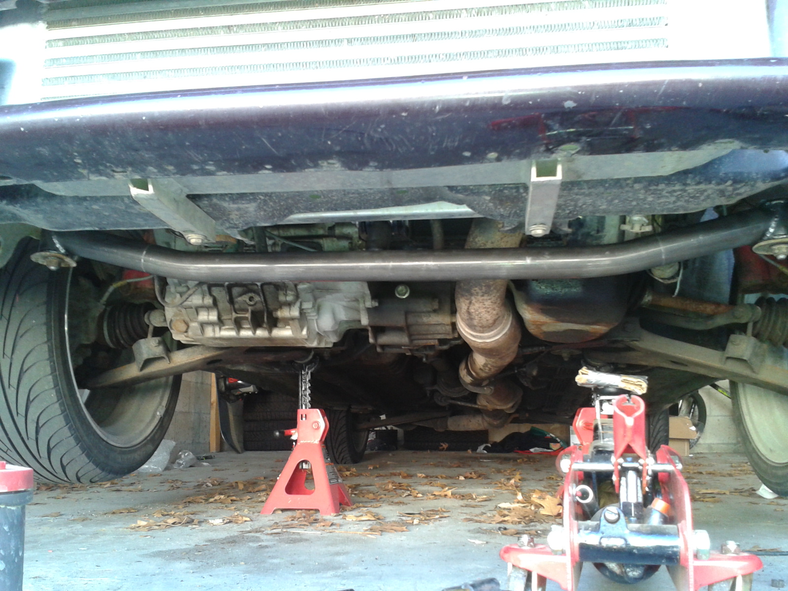

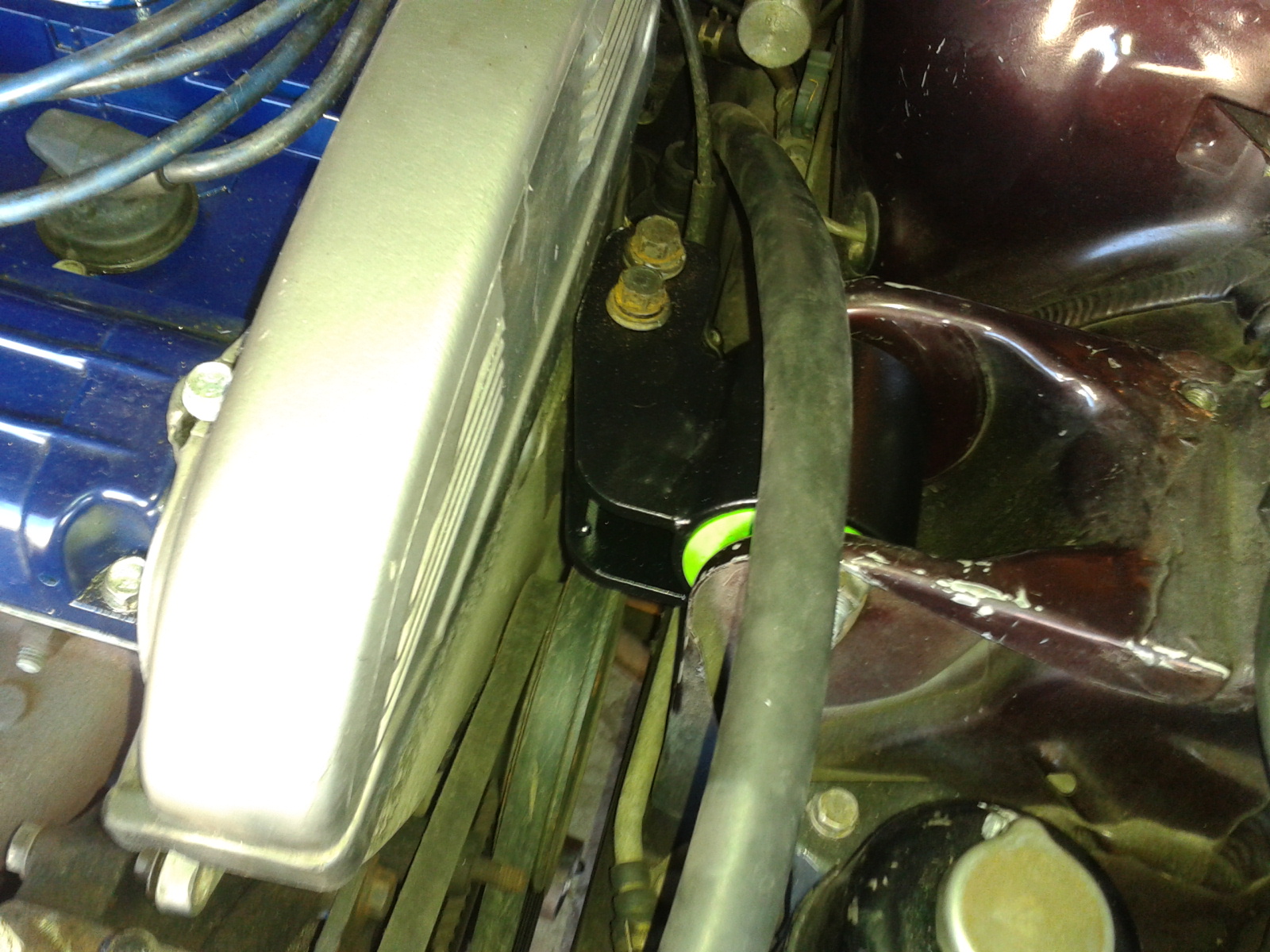

well ive been collecting goodies over the past couple weeks
front and rear strut bars. drop engineering motor mounts. tubular from crossmember with poly bushing, and fic bluemax 1450's
the fuel injectors went in a few days ago and motor mounts and crossmember in today. couldnt break the bolts on the rear mount with the engine in the car, got those soaking in pb right now though.
gotta say with the front crossmember from bulfab. it is a great piece. i got the single piece bar. and it cleans up a shit ton of slop vs just running the stock front crossmember. the stock crossmember alot causes the engine to pivot back and forth because of the rubber mounting bushings. the tubular front crossmember has solid mounts to the car and does not pivot as the stock piece did. very stable and offers A LOT more room to get to things from under the car.

Those drop mounts are pretty good. Drop sent a set when they first came out. I didn't get to drive with them much, but they're darn nice looking. I almost wished the bushings were a little softer though, as with cams, it did have some vibration at idle. Much better than solids though lol. It's nice to see more than a few people doing the tubular front cross members, they look pretty nice.
Old 04-03-2012   #20
viridionplague
Posts: 788
Re: The car i bought twice.
yea they are pretty nice. i think the avid mounts are a little nicer looking but they are 25% more money. the avids do however have selectable "stiffness"
