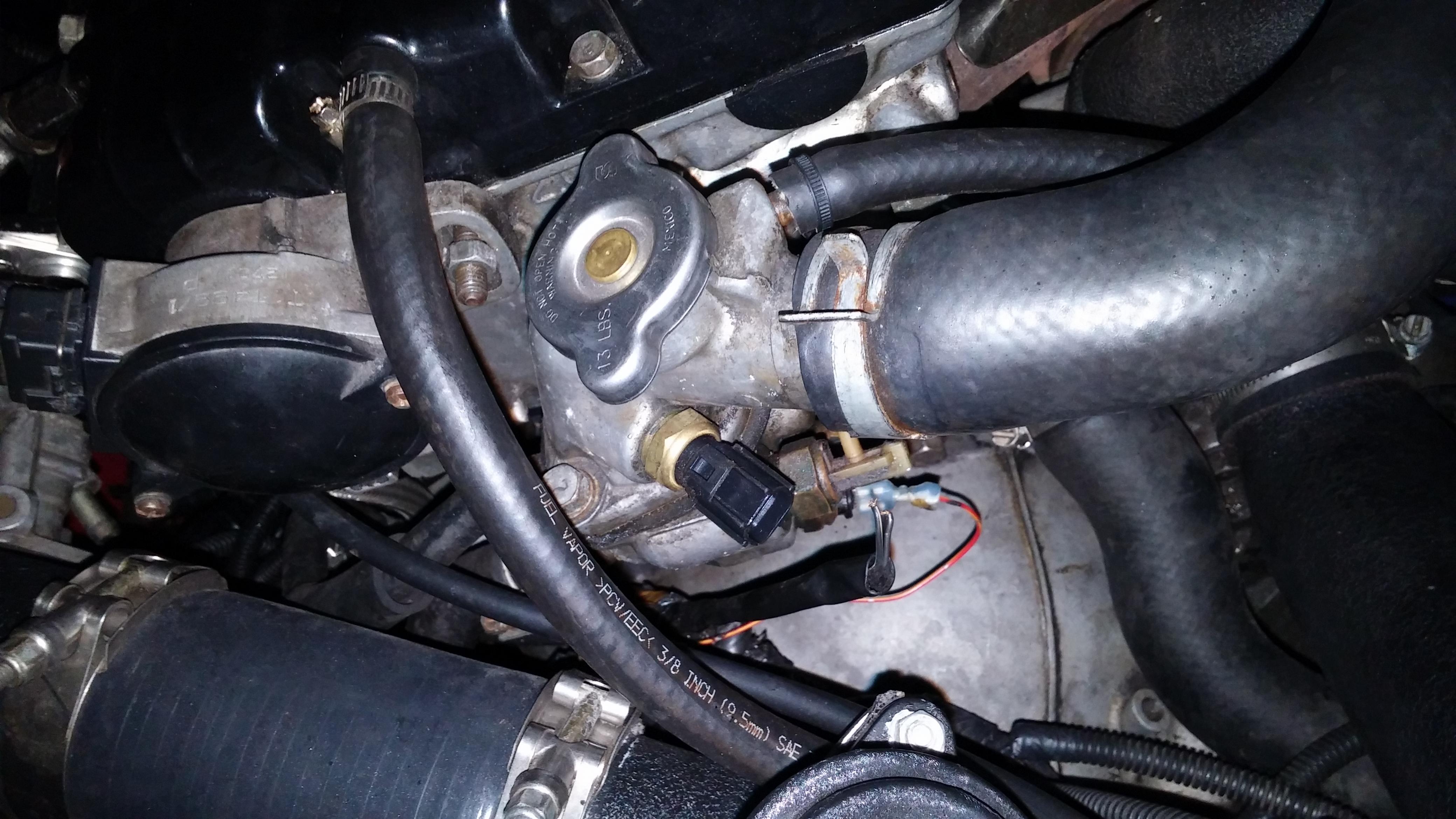

Heres a pic to make sure im explaining this enough.

So th plug that plugs into the black connector right ontop of the water neck has the two wires out of it somehow.
But that is the temp sensor correct ?!?!?
Tyler
2011 Subaru Sti 11.0 @135mph
Old 12-10-2014   #16
Re: Will not cold start
that would the one.
I have a good pigtail
I had the same issue with my colt, the sensor was fine, the wire just had a dead spot, I bypassed it with those blue splice clips and ran a new lead and she started right up.
