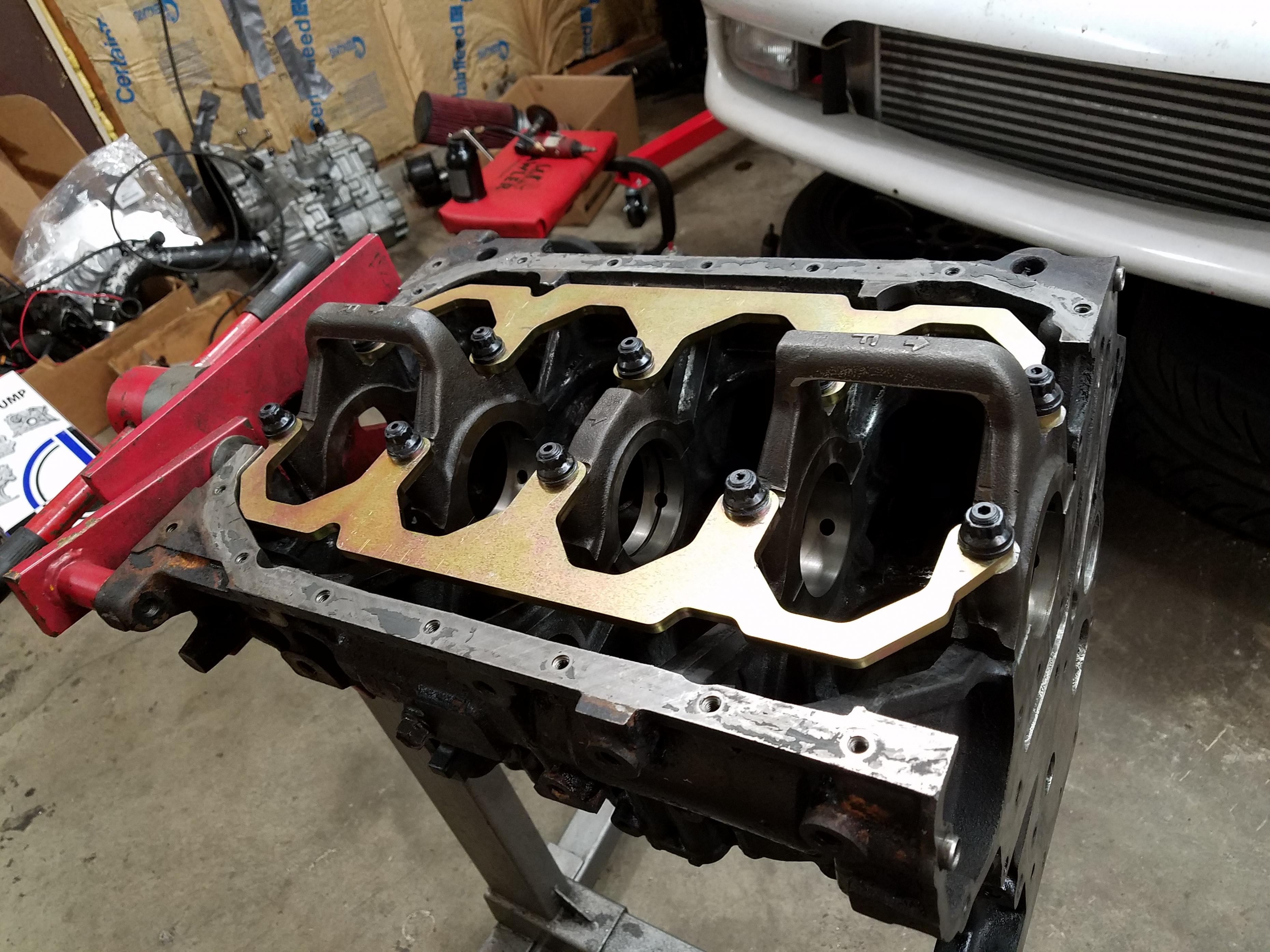

Everything is going to plan. Blocks at Gosh, for deck and oring. Since I was next door. I put a timeline to this heap of parts to go on the dyno.
While that's gone, time to clean up all the little things. Bigger fuel line from the tank up, bushings in the shifter, replace the bell housing, and take the grinder to my turbine housing. I've decided I'd rather try and make a single 450LPH pump work than try to stuff 2 in there and suck air below a half tank. Which means I need more injector and the bigger line.

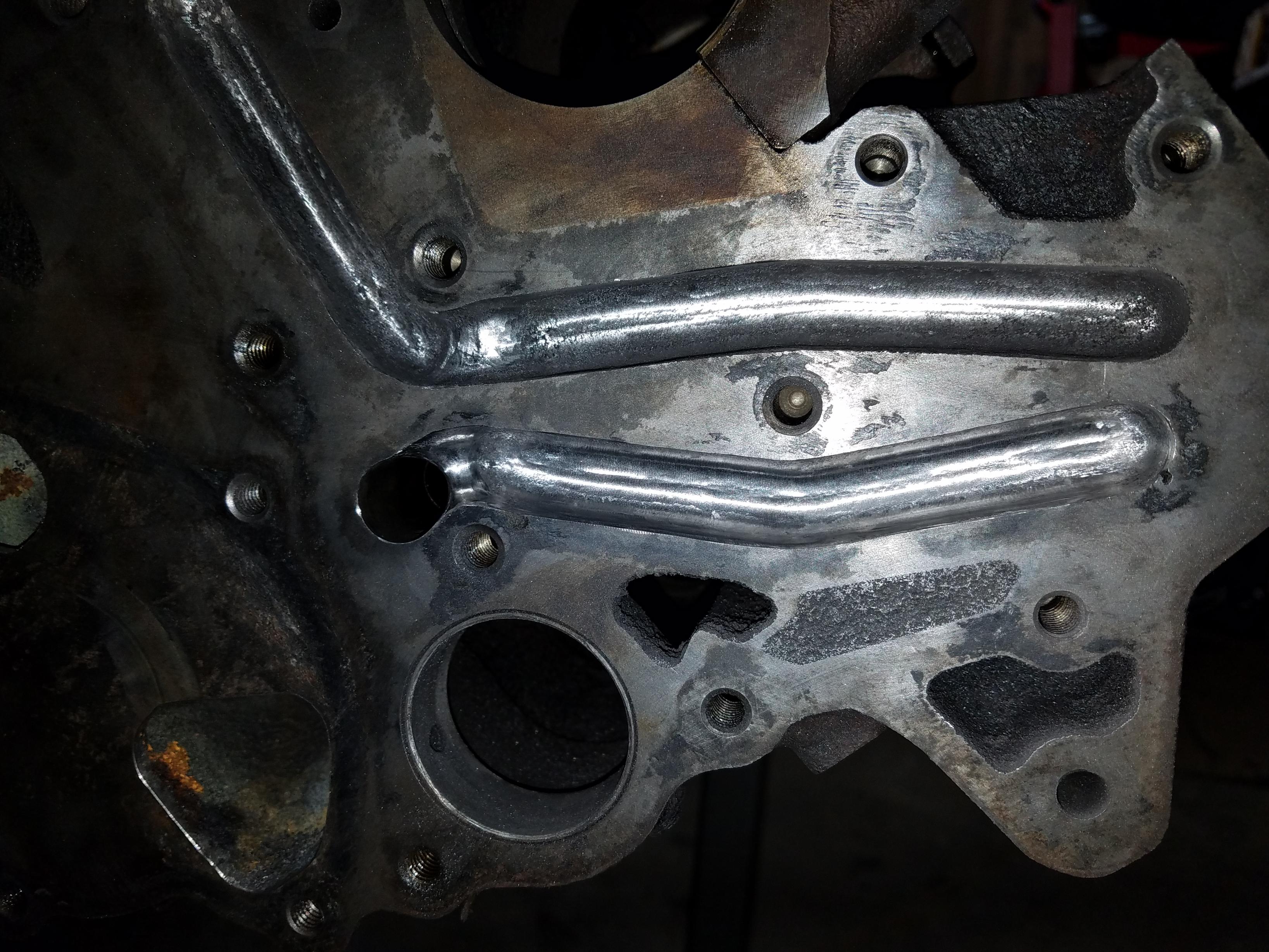

The oil pressure is actually pretty good, till it sucks air. It's 15-20psi at idle, and around 80 at higher RPM's and seems to flatten off without overrunning the relief valve. But I ran .003" clearance bearings so it plenty of room to escape.
It had issues on say a left handed clover leaf, the one time in particular I remember I decided to exit in 2nd, so it was at 6700ish for a lil bit, then I come out on the throttle, I remember the pressure gauge jumping around, and thinking, oh wire must be loose... You know how you justify away major issues, well I can say looking at the parts the wire to the pressure gauge wasn't lying.
So I'm hoping an HLA, venting the block, and a bigger maybe better pan will help the oil drain back, and the extra volume provide more forgiveness for spirited left turns. Cause this was with tires that had the grip level of a brick before, now with 255 wide 200 class tires it really dives around corners. I know people have this theory that DSM's can't corner, and they really don't do well stock. But good coilovers and toe eliminators totally change that.

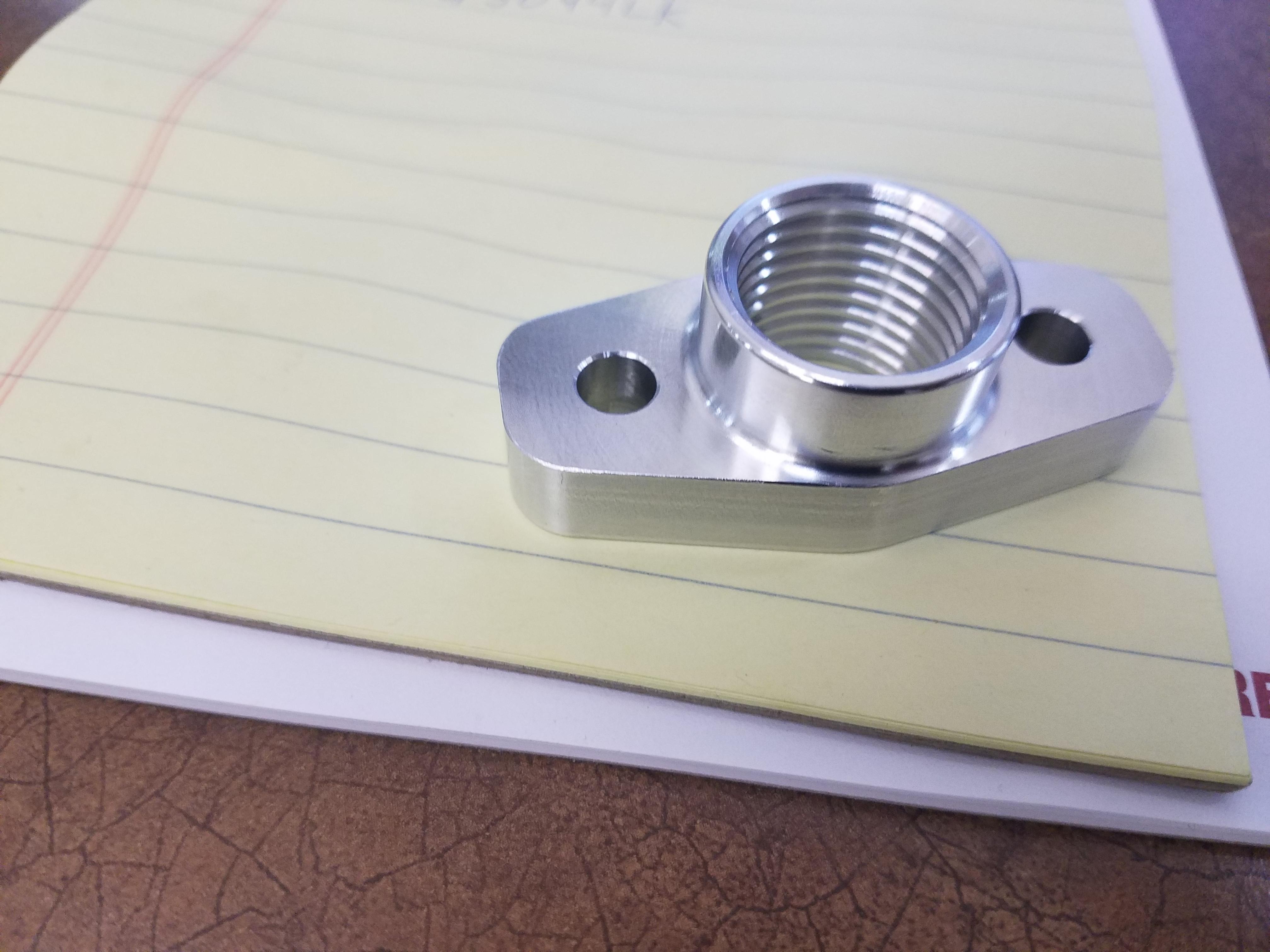

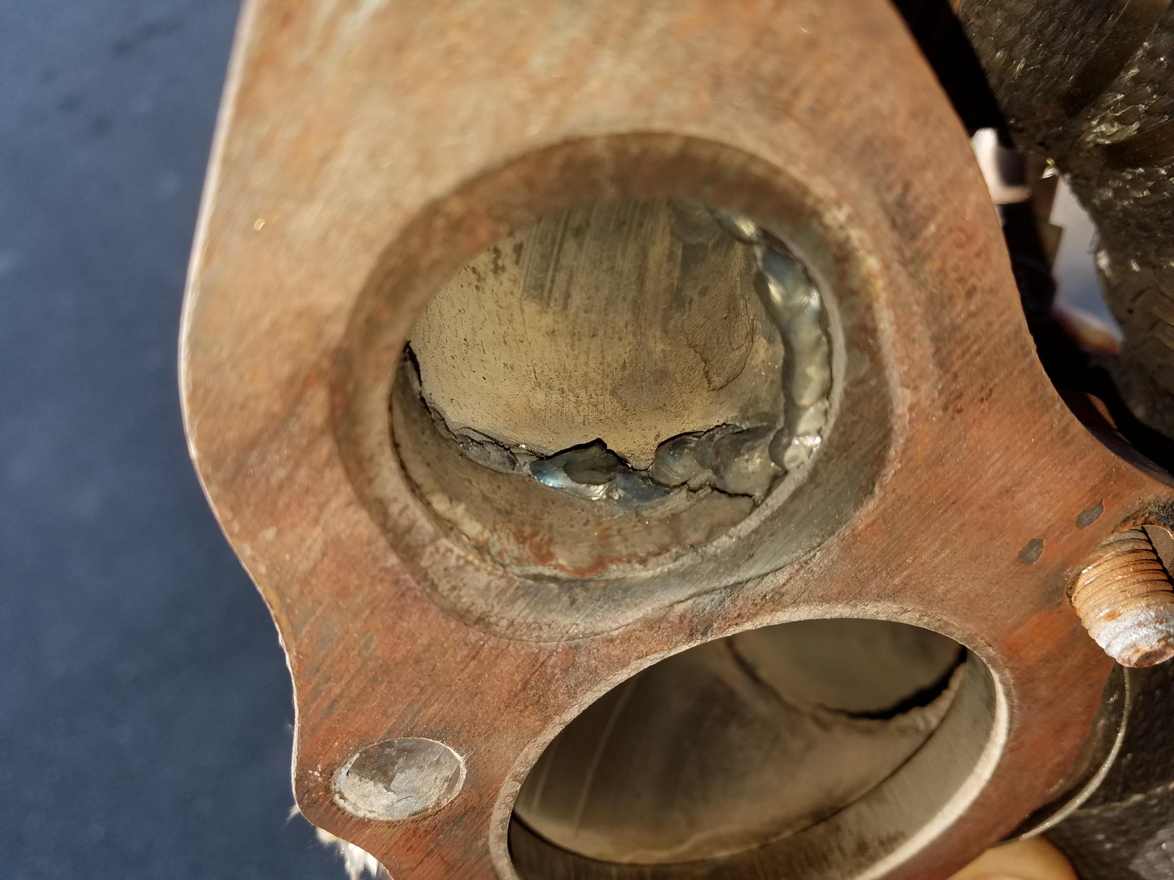

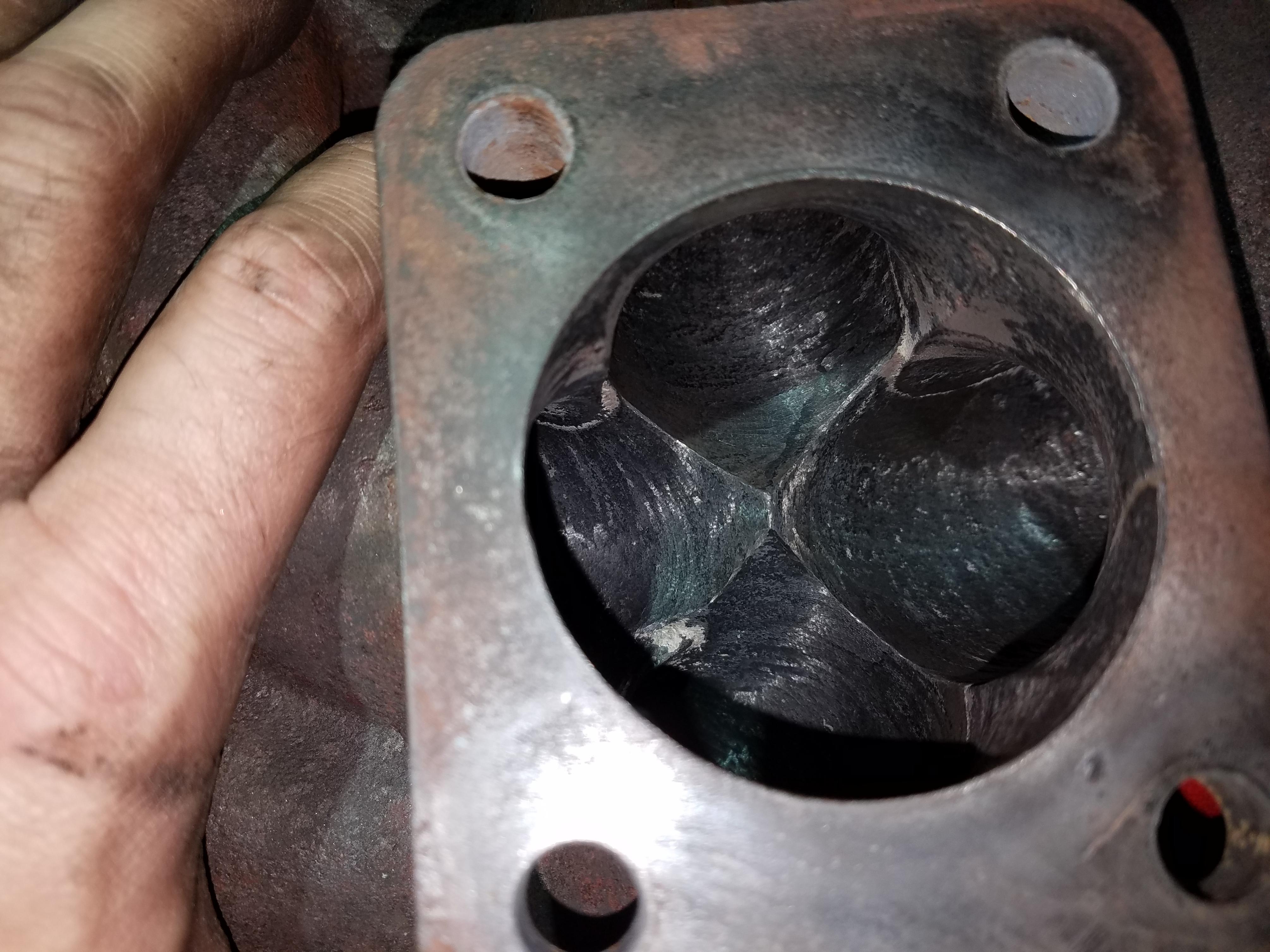

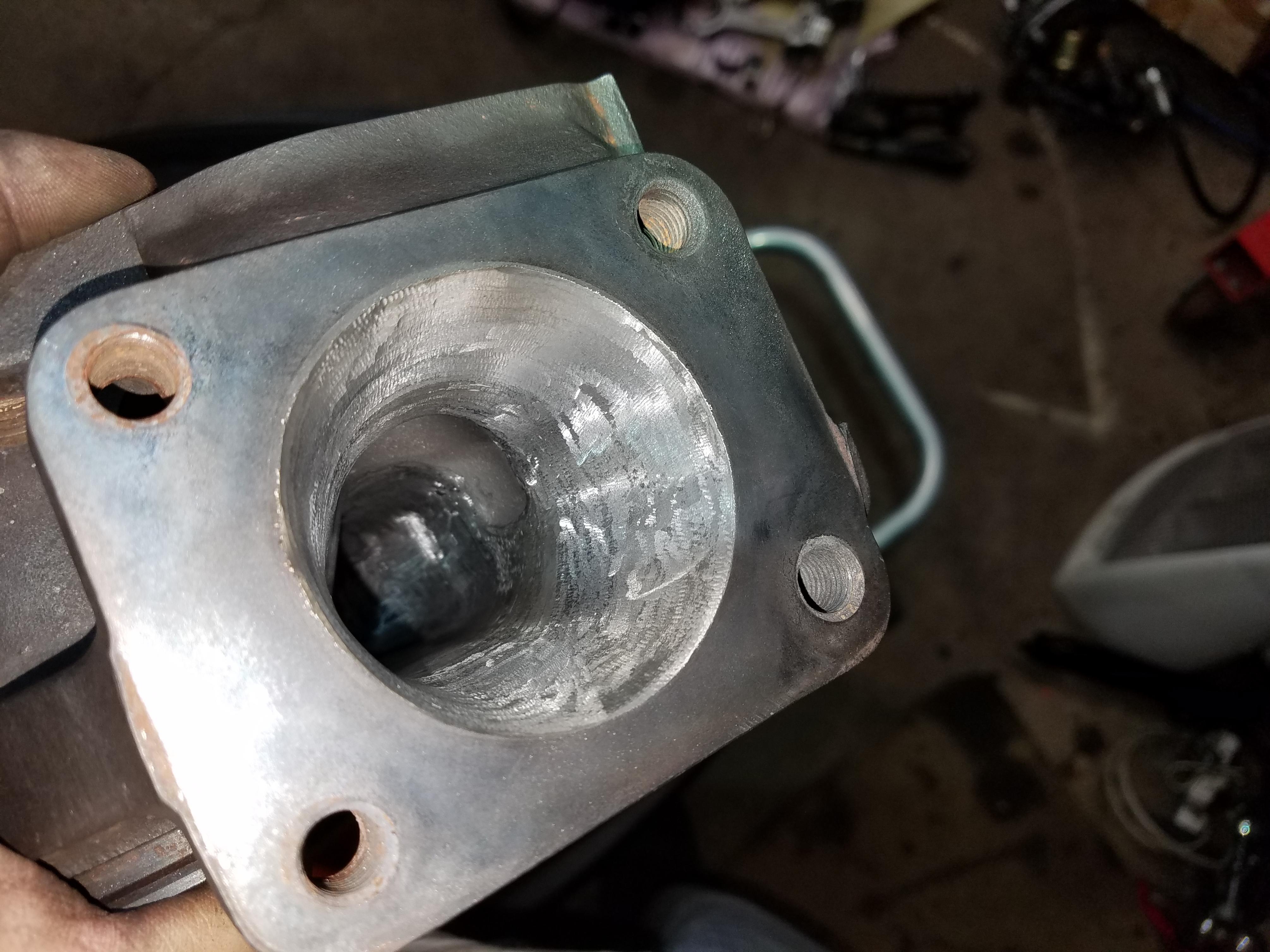

Been a busy past few couple months, but I have a few updates for the dsm. In an effort to help this tiny 8cm housing breathe better with the huge compressor strapped to the other side, I took the grinder to it. I tried to open up the narrow part just after the waste gate vent as much as I dared. Manifold I didn't do much more than take the gating off a couple of the runners and smooth things out, didn't figure there was much to gain there.
Block is back from Gosh. Did a nice job with the rings on that, don't mind the hone job, it wasn't mint to start with, making hp, and piston sealing has never been an issue with any dsm I've had.

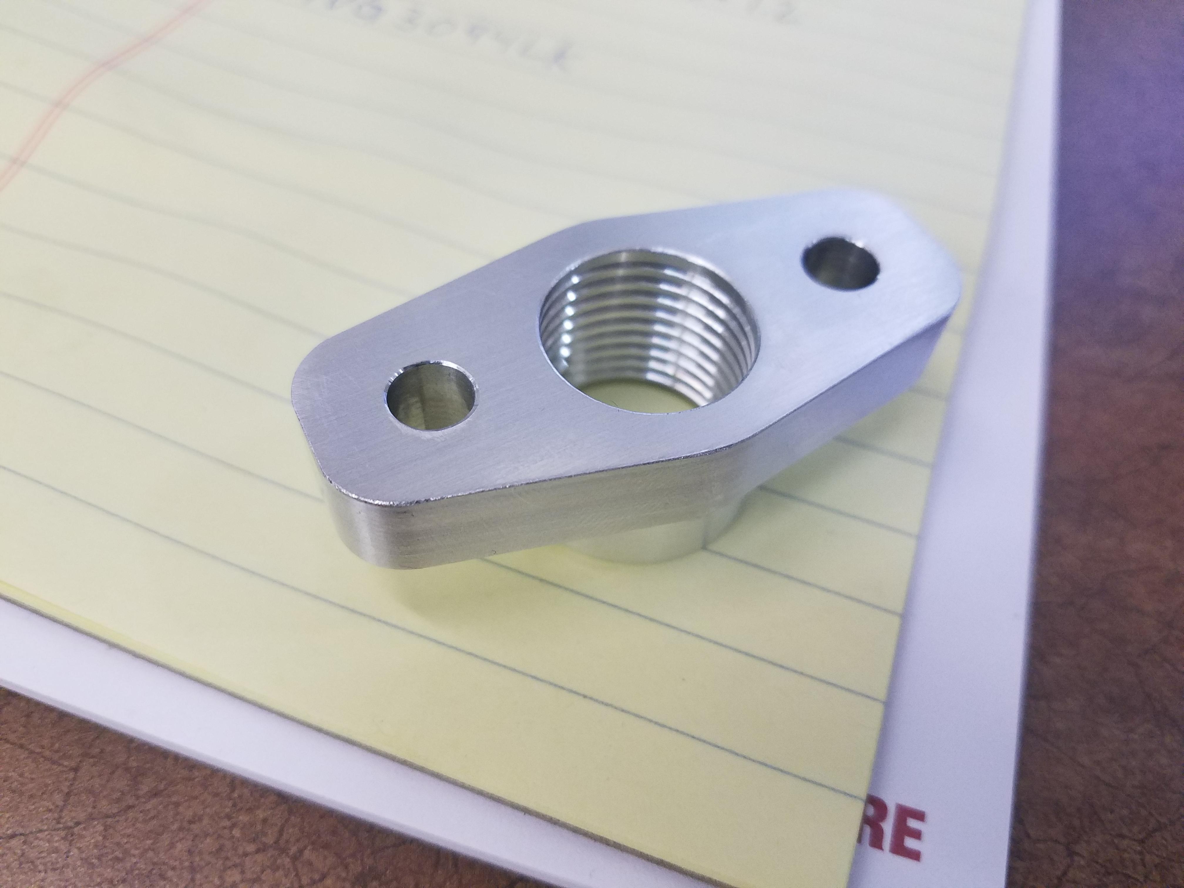

And I don't know about anyone else, but I have yet to find a good drain flange for a mitsu housing that actually worked. So I did what any machinist/car guy would do, I made my own. It's 1/2 NPT, I made it wider than the 1" ones you normally get, and I stopped the threads just short on the ID so the flange side hole would be smaller, to give it more width to seal on the gasket. Along with giving it the proper hole pattern to make it fit the mitsu without a mile of slop. I ended up using 7075, hopefully it doesn't corrode too bad. If I had a piece of 6061 I would have just used that. Reassembly should start next week. Still have to install the fuel line setup, and run some better wire from the CDI box to the coil pack so I don't loose any spark energy from that.
Oh, and does anyone have any 1.5" 321 stainless pipe around? Looking to redo the short part to the wastegate flange on this O2 housing with the right material so I don't have to re-weld it weekly.

I like that drain flange, i need to buy one. I'd like to make a complete .7mm+ drain line for my new turbo once i finish with the 16G.
Nice work.

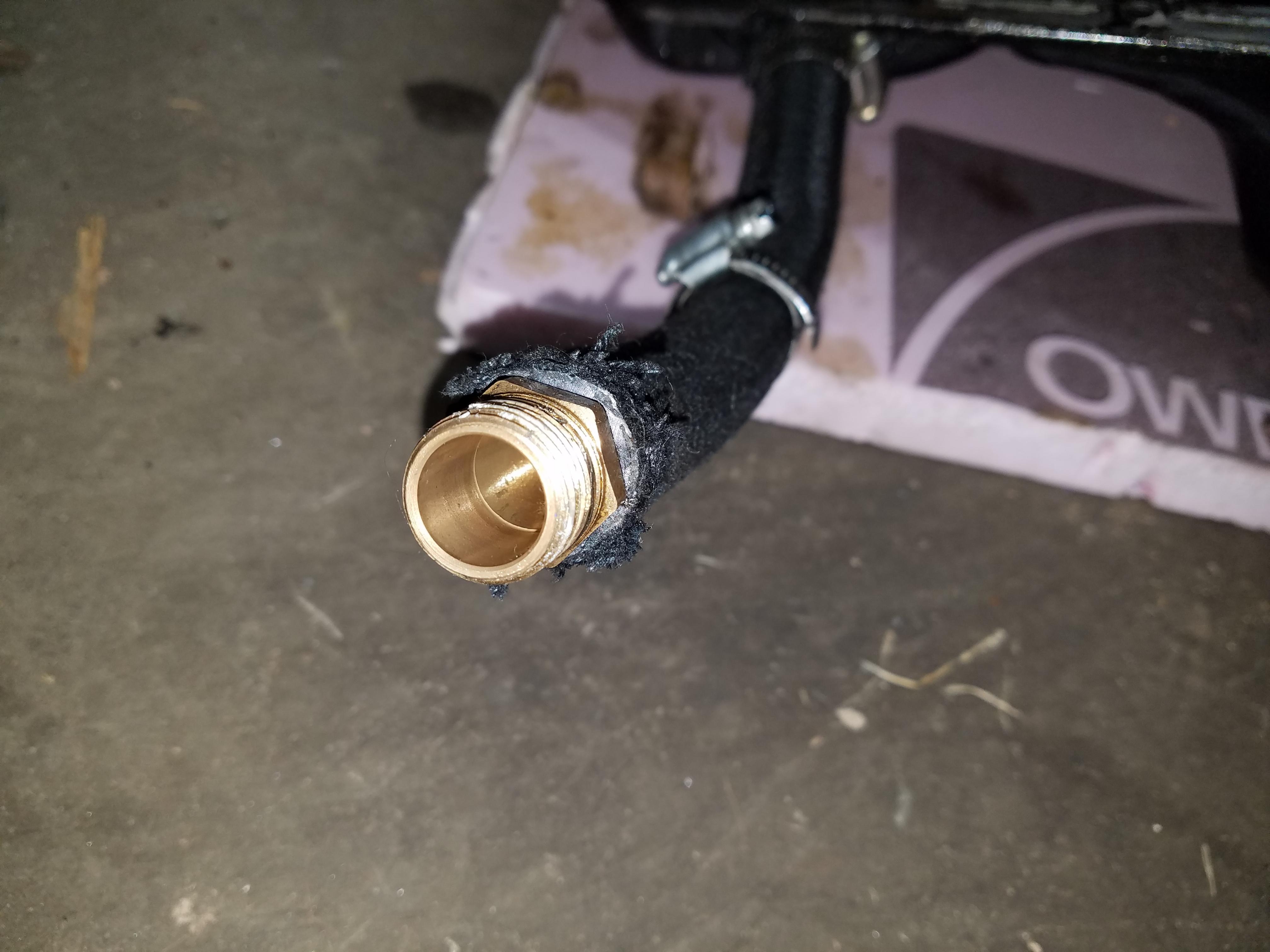

My drain line is 3/4" push lok hose, have a 1/2" NPT to 3/4" barb that I get from Ace for like 7 bux, and I am going to have an alum barb welded to my moroso pan now. I'm not sure how picky the FP black is with oil returns being that it's a mitsu style housing, but I've ran a garrett that was so I don't want to start going small again and create problems.
