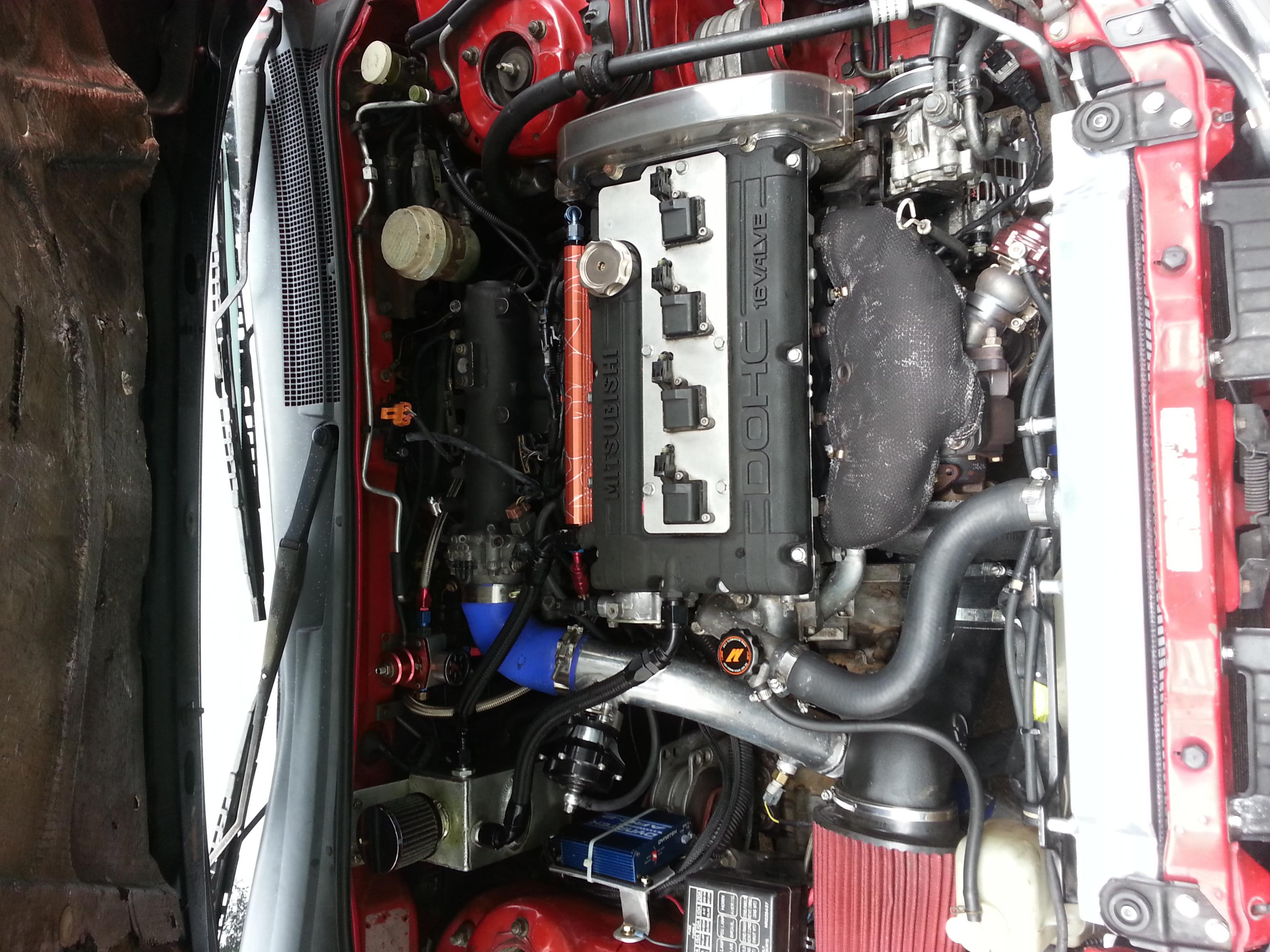

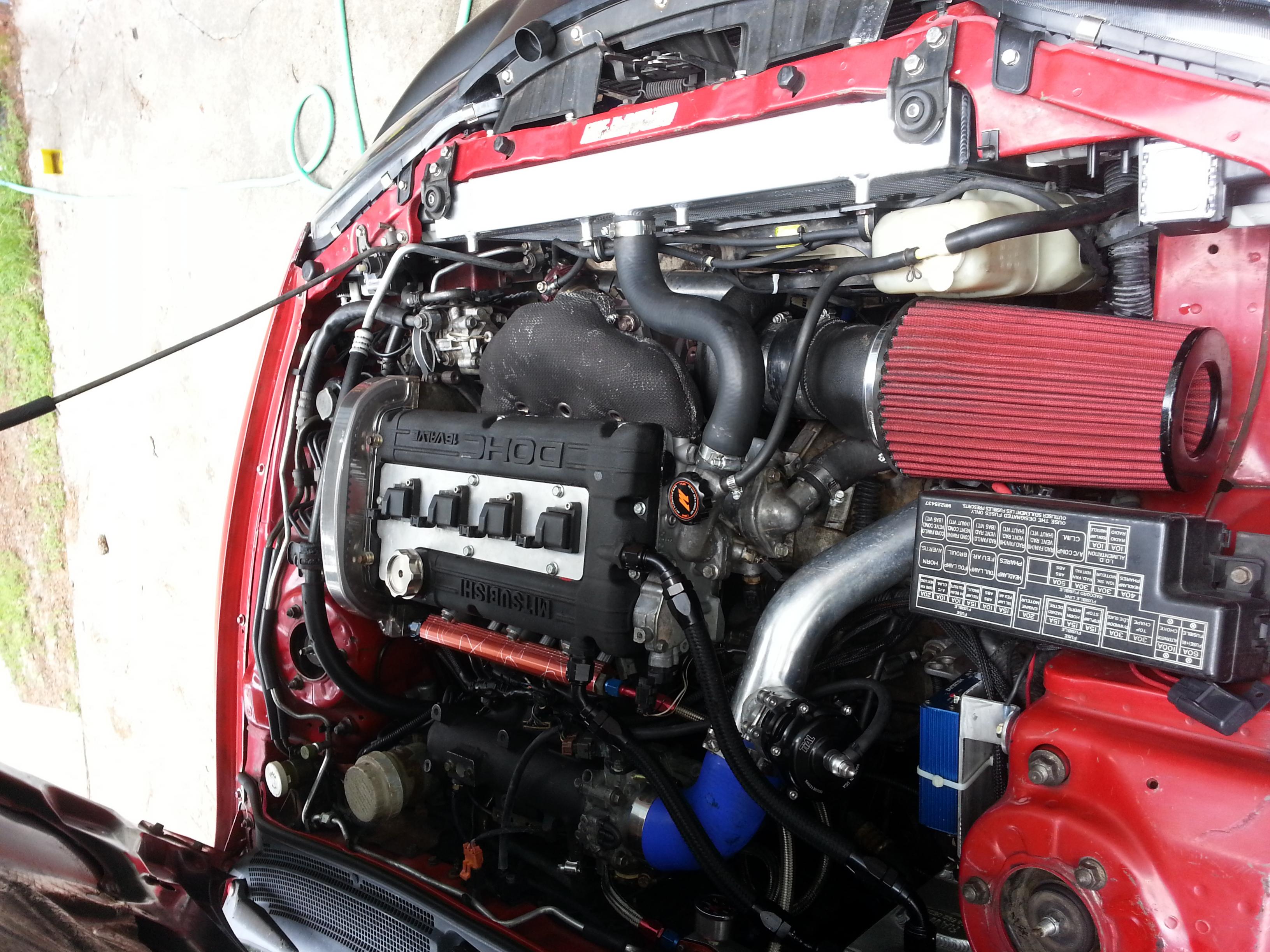

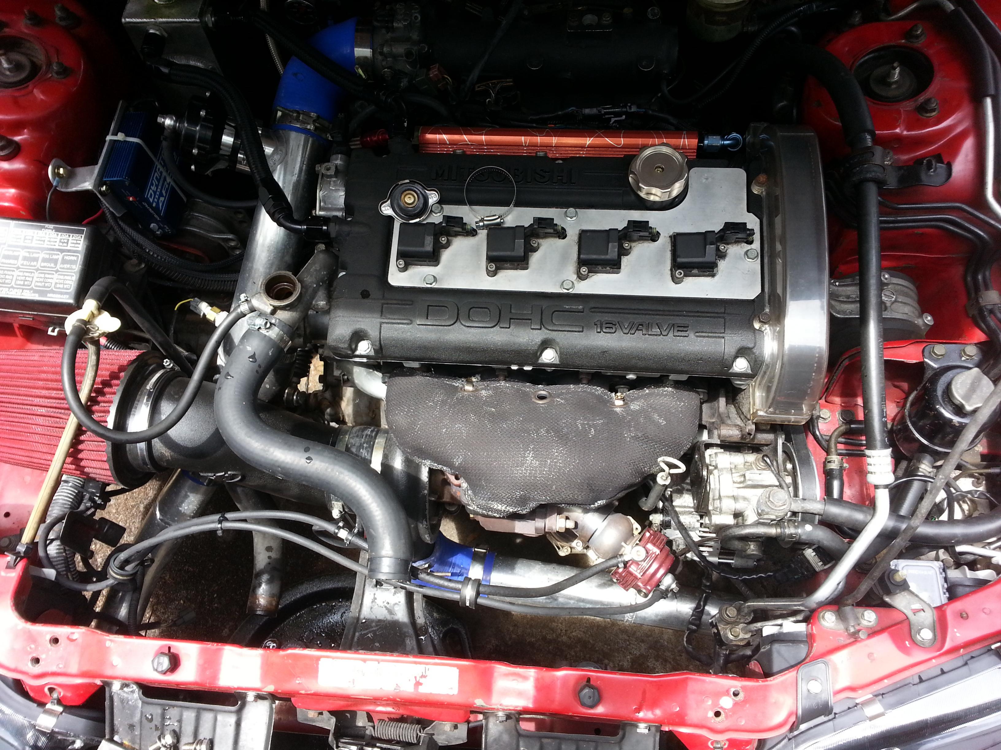

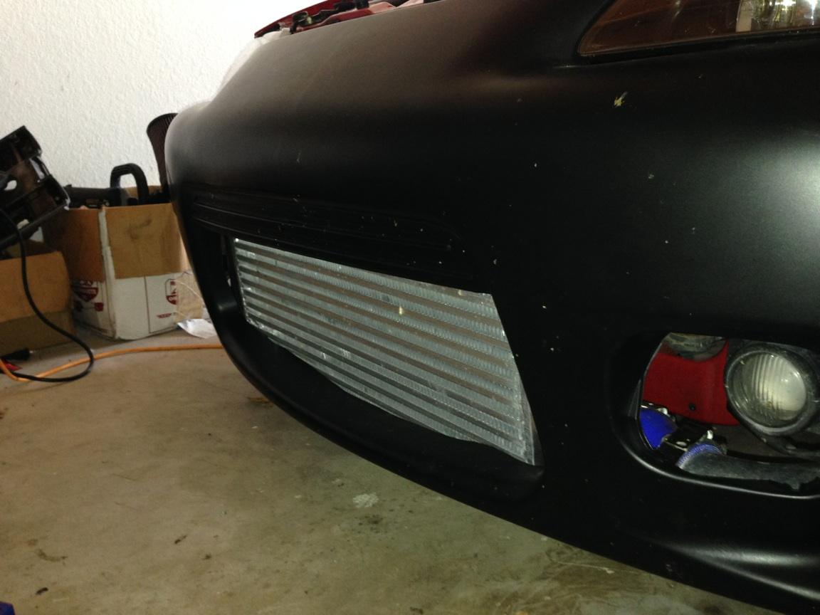

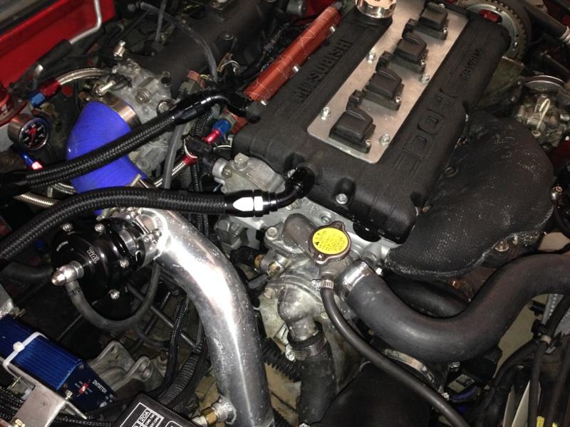

Onto the current list of Mods on the car and general background of it:
To start the previous owner bought this car as a project and after looking at the photos of the day he picked it up boy was it ever. Still needs some work but it has Zero rust that i could see from all his photos of the underside as well as exterior and engine compartment other then on some bolt heads.
Car was built at ASAPerformance - was given photos of the build at there shop with his car in the background (license plate visible) first person i've talked to in 7months that could produce picts or a reciept for build.
General Mods:
Bolt-on Modifications:
FMIC, 2.25" IC piping, Tial BOV, Evo III Intake Manifold, 1G NT throttle body, FP Race exhaust manifold, HX35 w. BEP bolt-on turbine housing, Punishment Racing 02 housing converted to v-band, 3" SS downpipe, 3" SRS R1 SS exhaust, Bosch 2000cc injectors, aeromotive fuel rail, Aeromotive AFPR w/ gauge, Race Parts Solutions in-line SS fuel filter, SS fuel lines, Walboro 450 E85 pump, Buschur COP with Dynatec ignition box, Fidanza cam gears, FP 4" intake, Tial mvs 38 wastegate, forward facing oil filter housing, crushed water pipe welded at the end, obx alternator and power steering pullies
Engine Management:
ECMLink v3 on Speed Density, AEM wideband gauge, AEM Boost gauge, Ingersoll Rand Boost Control Solenoid controlled by ECMLink
Engine Internals:
6-bolt block .020 over, ARP classic head studs, Wiseco 9:0 pistons, Eagle H beam rods, ARP main studs, BSE, Kiggly crank trigger, Kiggly HLA pressure regulator, Fel-Pro HD MLS headgasket, HKS 272 cams, Crower valve springs, Crower Titanium retainers.
Drivetrain Modifications:
Stock 5-speed tranny, SS clutch line, ACT 2600 PP & 6-puck disk , 12-lb chromoly flywheel, Stock Rear LSD, Prothane mount inserts, solid shifter cable bushings, Torque Solutions Drive Shaft Bushings, Fluidampr crank pully, ARP crank pulley bolts.
Suspension Modifications:
HP Design RP5's 18x8, 235/40/18 Nankang el Cheapo tires, Hawk HP pads, Outlander Brake upgrade with SS brake lines. drilled and slotted rotors all around, Tokico HP shocks with Tockico springs

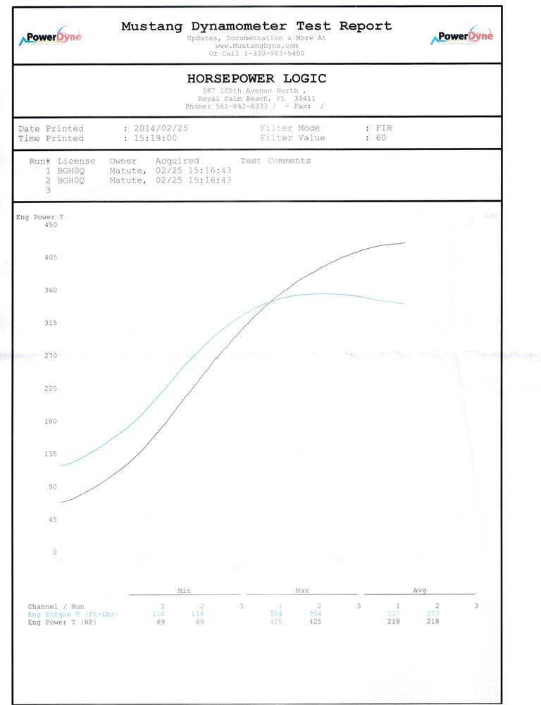

dynod 425awhp on a mustang dyno on 30psi and E85.

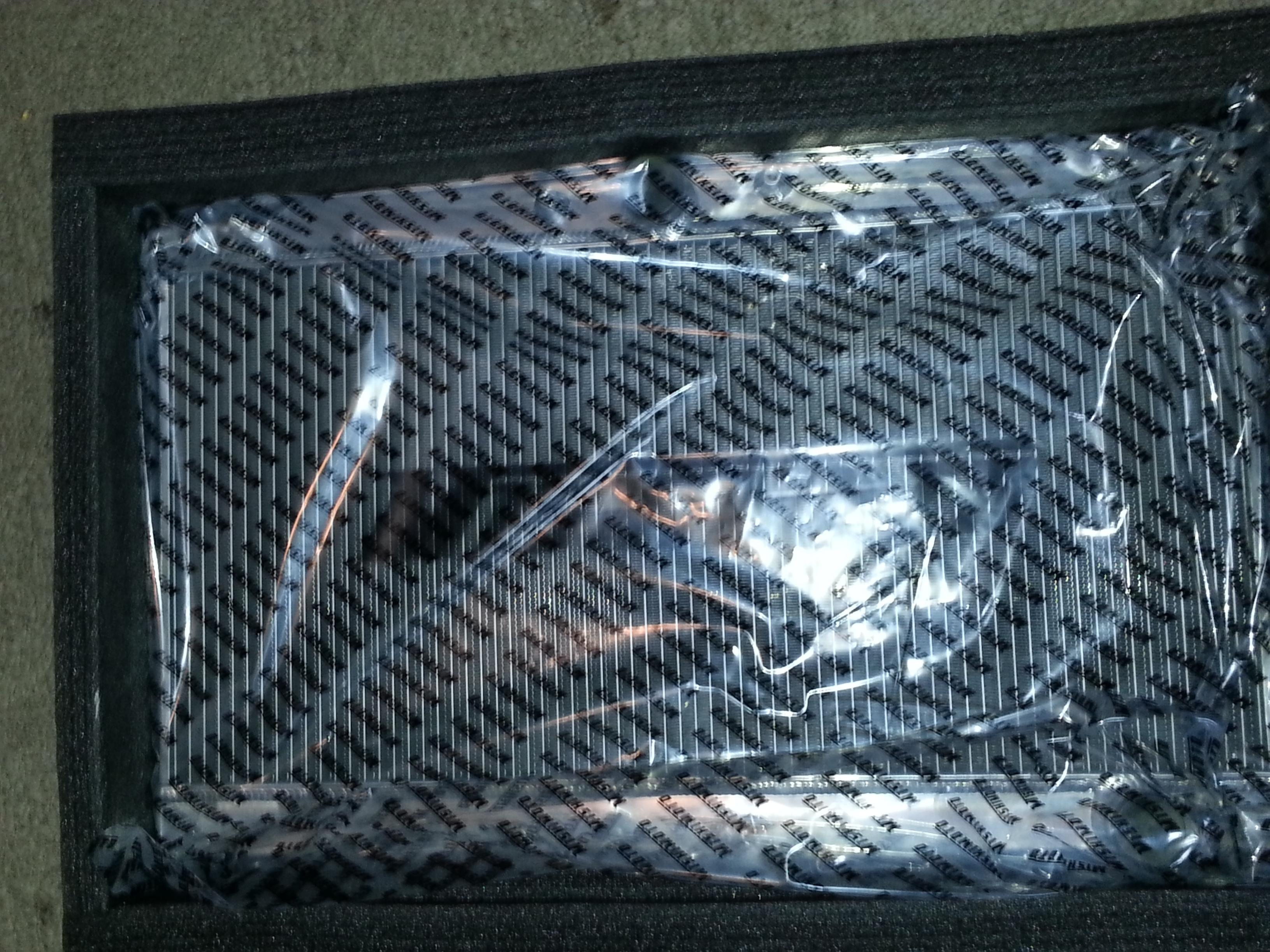

Old 07-17-2014   #3
Here is the List of mods I am thinking about doing as money/time allow. Will be a slow process but I'll try to keep things posted as I do them.
Mishimoto x-line Radiator - 7/19/2014
Mishimoto Radiator cap - 7/19/2014
Mishimoto thermostat - 5/8/2018
Mishimoto 25 Row Oil Cooler kit - 6/1/2016

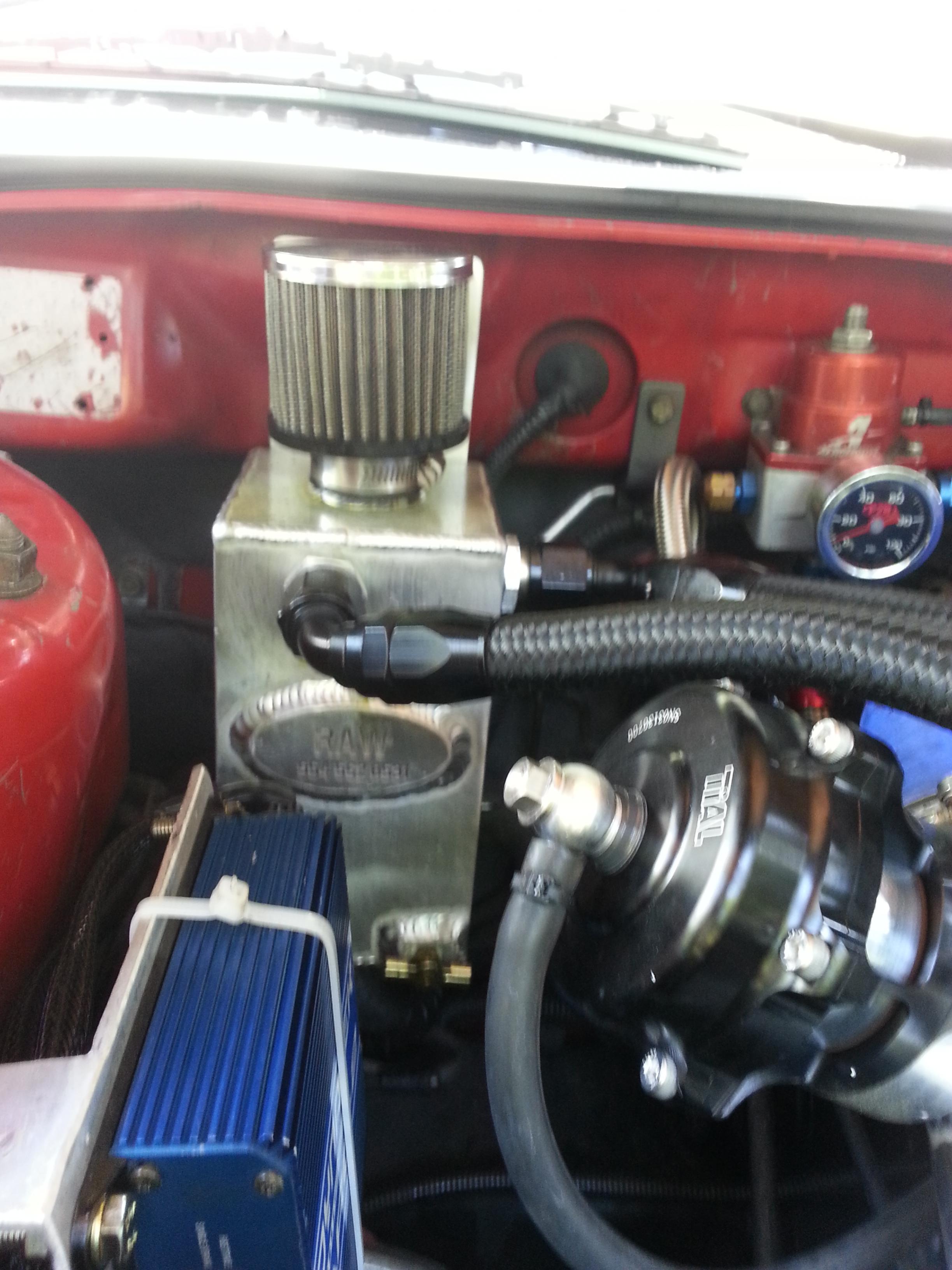

Old 07-17-2014   #6
Halon, I hear ya on the mod list. And it is almost exactly where I wanted the car to be which was a selling point for me. That is why my mod list is so small most of my money will be in fixing the body and paint.
I realize my car isn't fully tuned yet (more details to come on a lot of things) but so far the smim and tb will be replaced if it seems to be a hindrance at the Track or if the r.r. thing doesnt work out. So far the power band is from 4500-6500. (24psi and 48-50lbs/min)
The oil system has me worried to be honest especially with my brother at the wheel, to this day I won't get in a car hes driving at the track, he travels all over doing instructional stuff now a days it seems, and I just can't handle my fear of needing to slow down long before he ever hits the brakes.
I will know for sure once we actually hit the track for the first time and hooks up all his stuff to see what the car does. From there well see if the car will stay focused on road racing or just go back to fun street car to replace my bike. In which case if I ever upgrade the turbo the car will be probably be set up around the FP Black.
As for the Magnus fuel rail, that is just personal preference only. The car has an unknown fuel rail which I am sure will handle what ever I need but. Some things I want to do are just for me and my tastes if I go with the Magnus smim the fuel rail will be ordered at the same time.
It goes hand and hand with the aem gauges.... I could go autometer or some other cheaper brand but I want AEM to match the rest.
But you'll see some of the "why's"... will get answered during the build thread as it progresses I hope.

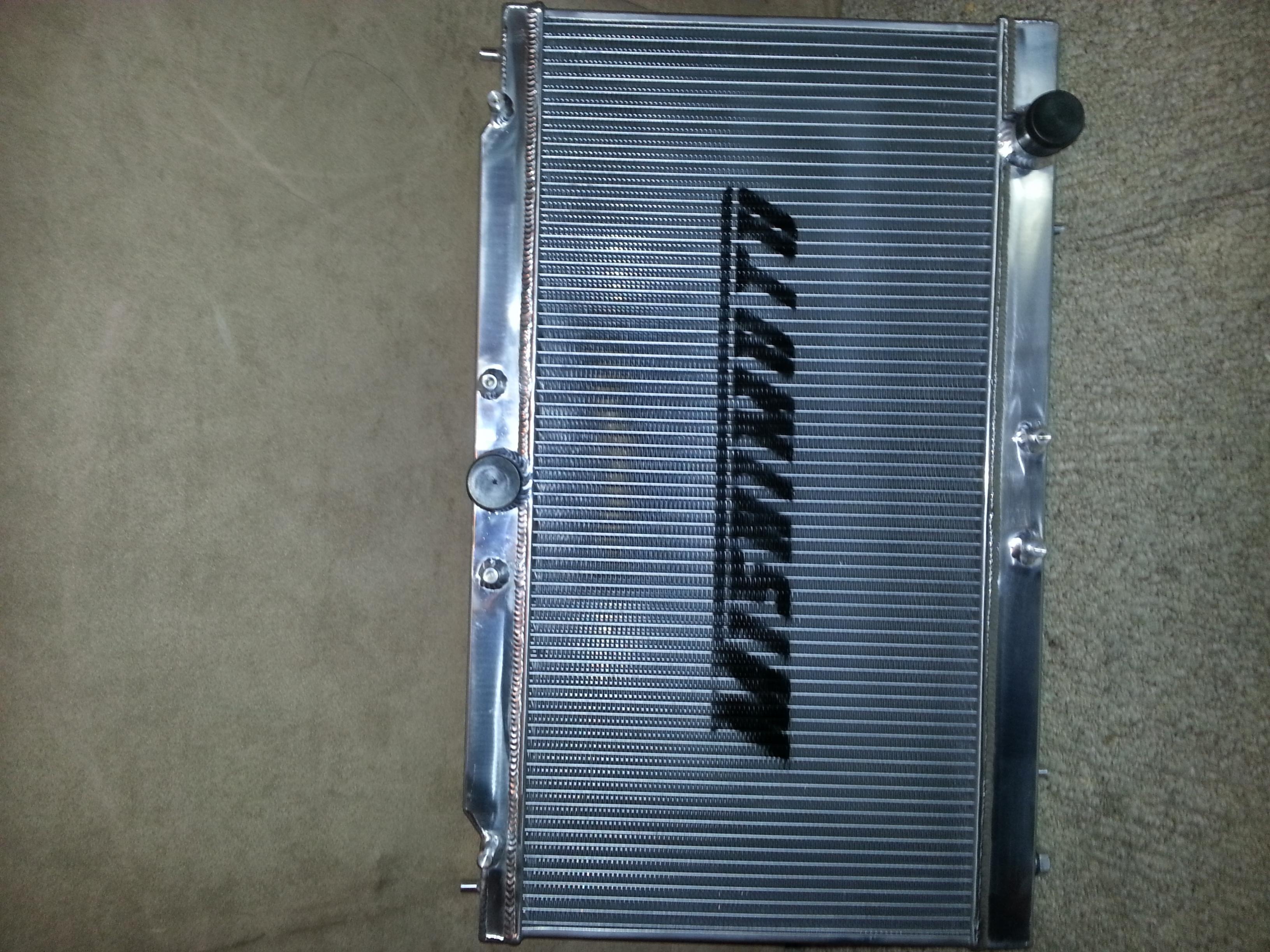

Old 07-17-2014   #10

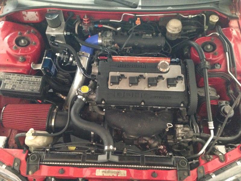

Well back to the build thread.
"Agent Ezzard" from tuners (previous owner) had left the DMV after an hour with things to do. With out him or I remembering to load all the settings in my laptop, me not knowing anything about speed density, running an wide band instead of a front O2 sensor, having not used dsmlink in 7 years, and having nothing setup in my laptop correctly other then the downloaded software and drivers for v3. Leads me to getting a crash coarse in tuning, thankfully Jery1234 on ecmlink forums has been a huge help with basically walking me through set up and tuning my car.
So after a few weeks of setting up, cruise logs, wot pulls etc. It became quite clear that in the South Carolina heat which stays in the 90+ range for almost 4 months straight and two of which are usually 100+. The cars cooling system was not going to cut it, i was seeing regular temps at 223-229 while cruising around.
So after long debate on what's the best first step. I took the advice from members here and went with a new 180 thermostat, 15% coolant, distilled water, and water wetter.
To start with i drained the system and flushed it out. Pulled the thermost to find that the previous owner cut the entire middle section out of it and basically was just using it as a gasket. After that did an Oil change using Mobil 1 5w-30w and stuck with the same type/brand filter that was on the car. While I was under there I noticed the flywheel inspection cover is missing and I quickly noticed why the previous owner mentioned he just replaced the starter. Flywheel teeth are all chewed up so a new flywheel is now added to the list of things to replace. And drained the oil catch can.
So finished up, warmed up the car and went for a drive. Temps were sitting around 206-213 for the short trips around town... temps were lower but still no where near where they need to be.
First day back to work temp was 106 outside and coolant temps were at 229 by the time I got through all the speed bumps and parked the car at work.
So something had to be done. Back to the boards I went with the question....do I get fans or do I get a radiator.... Once again took the advice of members here and ordered up a mishimoto xline radiator and radiator cap. The hope is that the 25% larger radiator coupled with the 1 stock fan will solve the issue.
I had a week to wait till the parts arrived from "map". In the mean time its been raining a lot and temps have been in the 70-80's... and all logs show 193-206 temps when outside temp is below 90. But I know this is south carolina and temps won't stay this low so feeling confident in my first major purchase for the car.
So walking threw the door yesterday found this waiting for me.... woot my first upgrades.

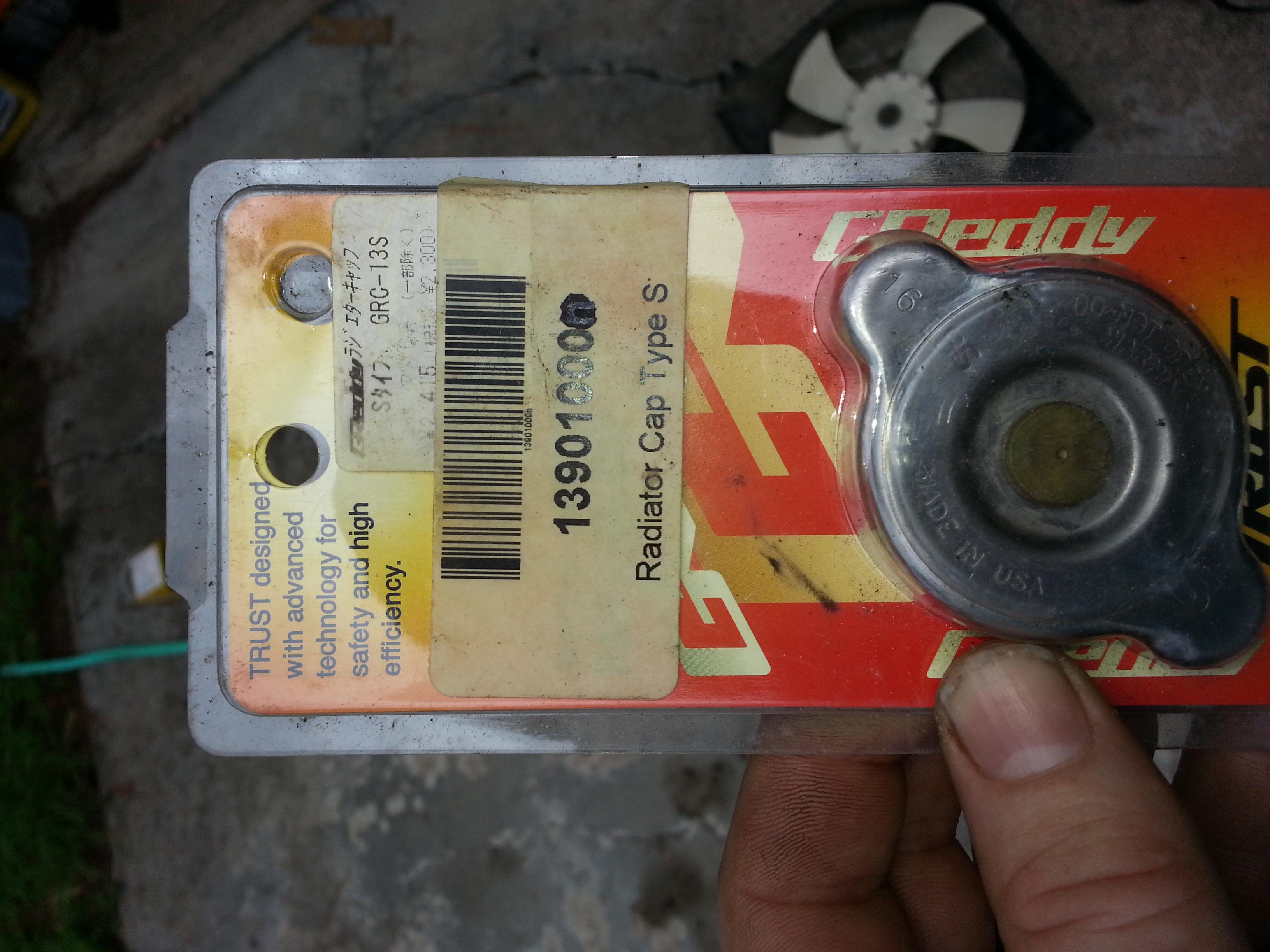

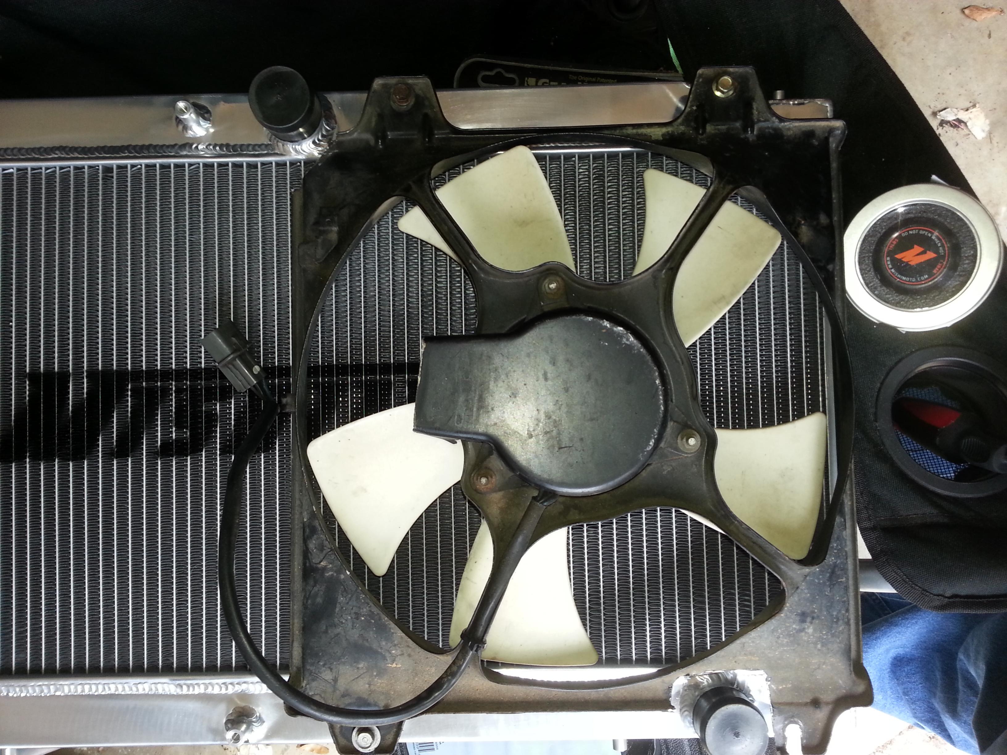

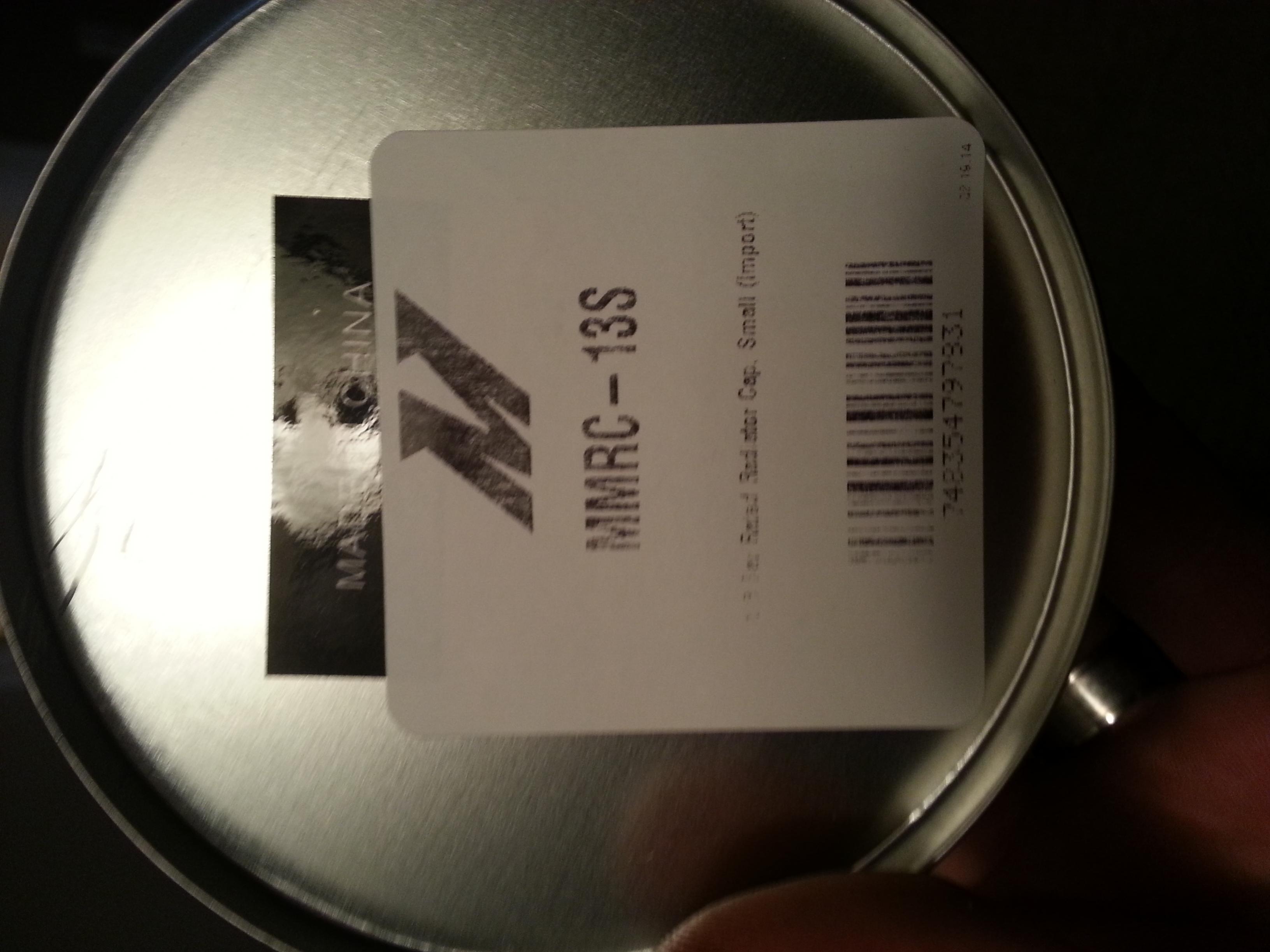

Old 07-19-2014   #15

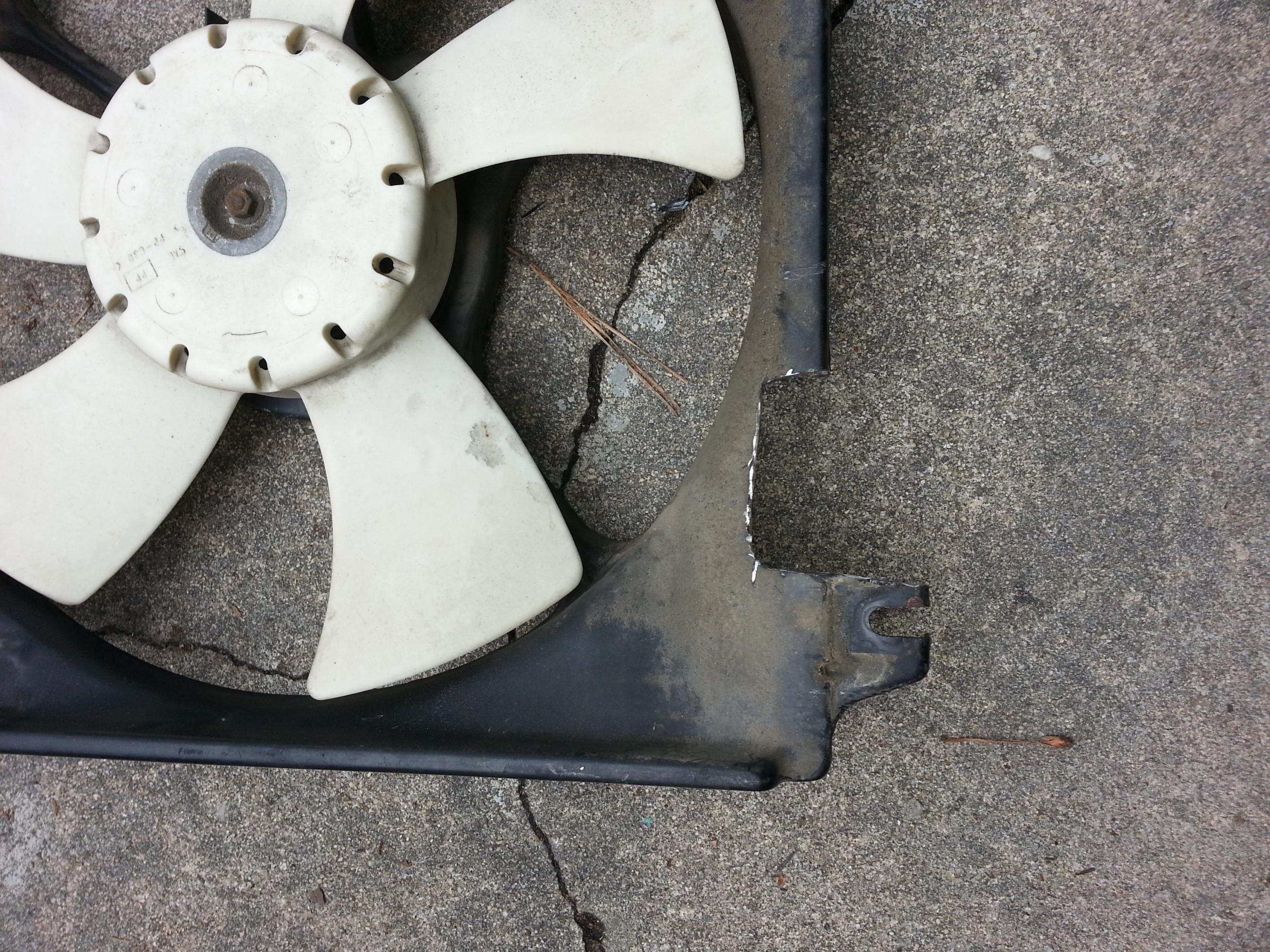

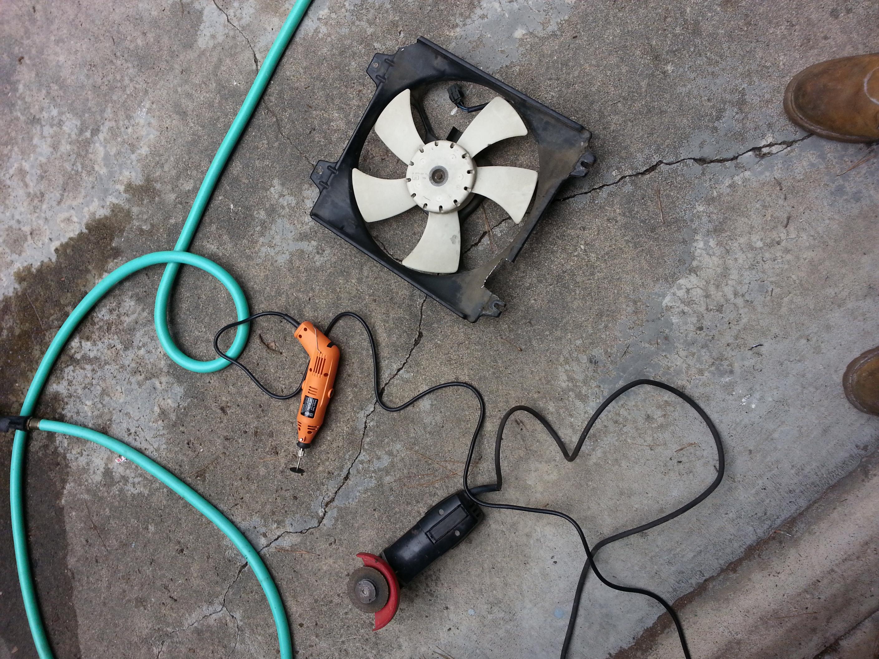

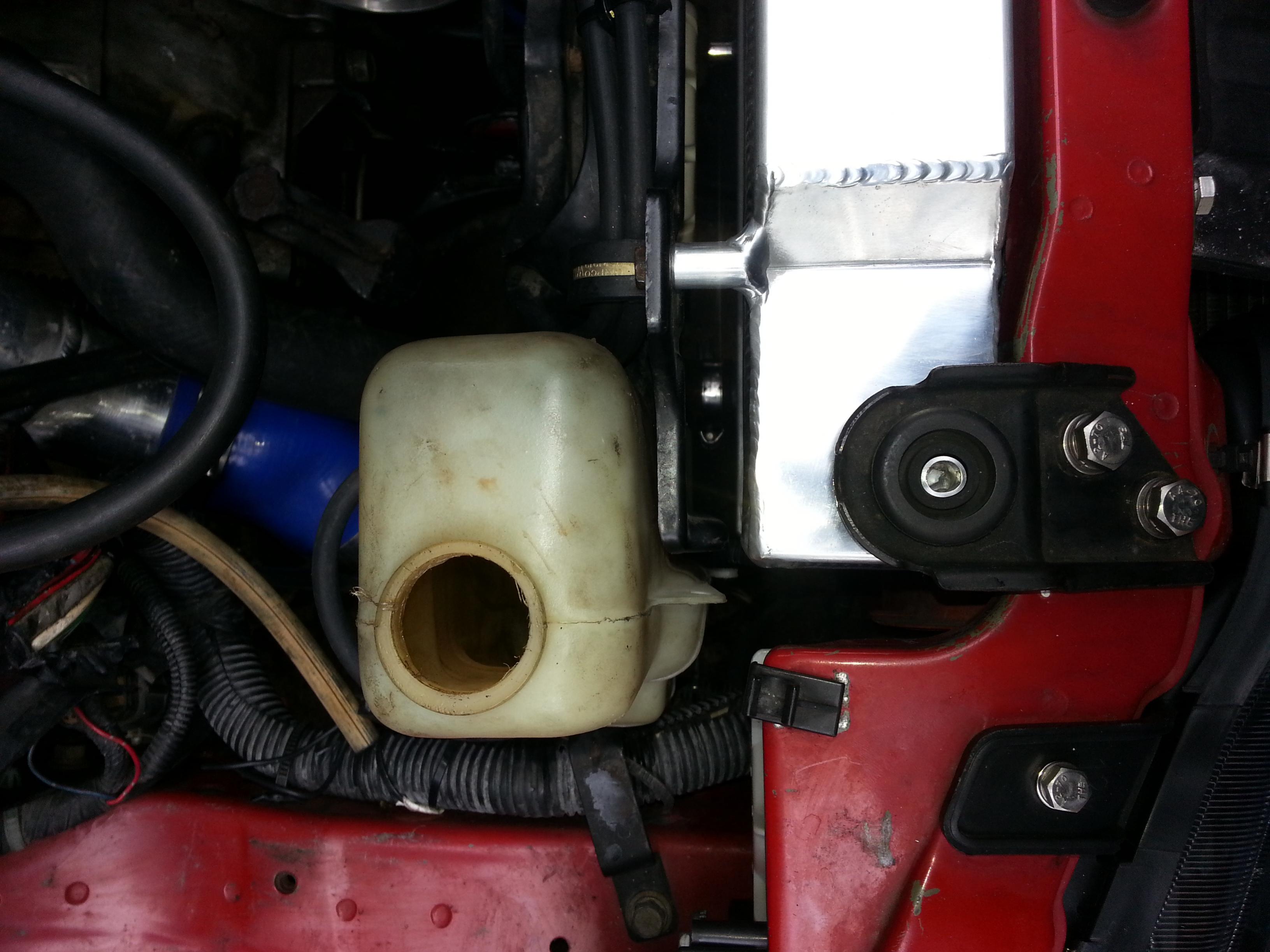

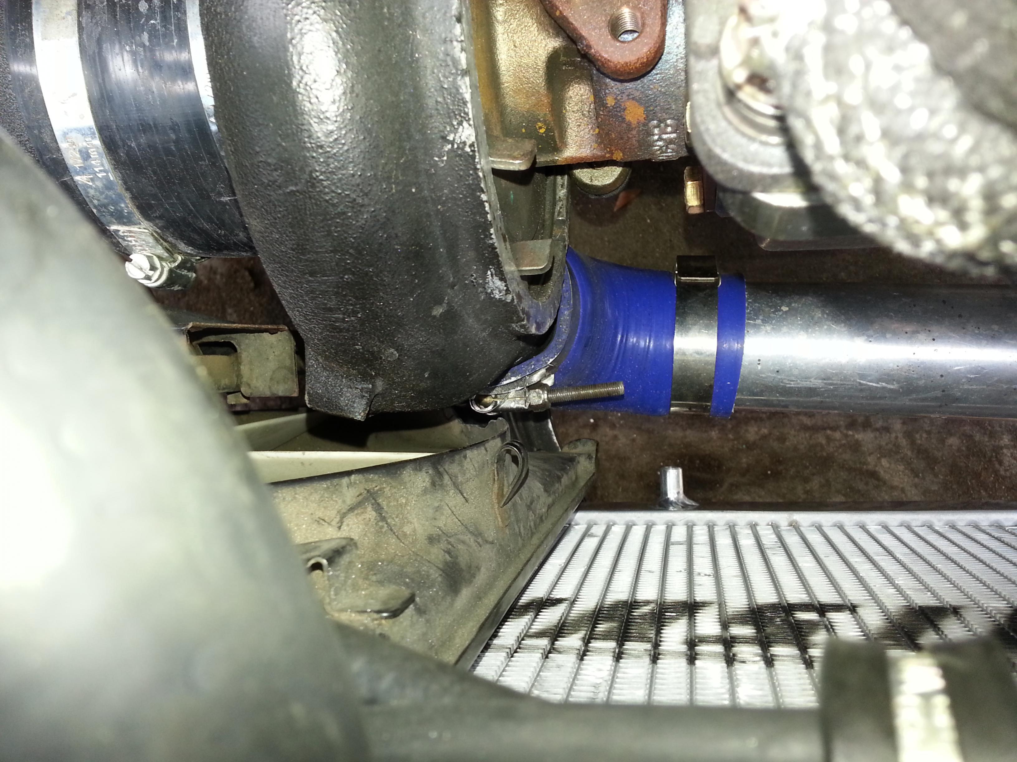

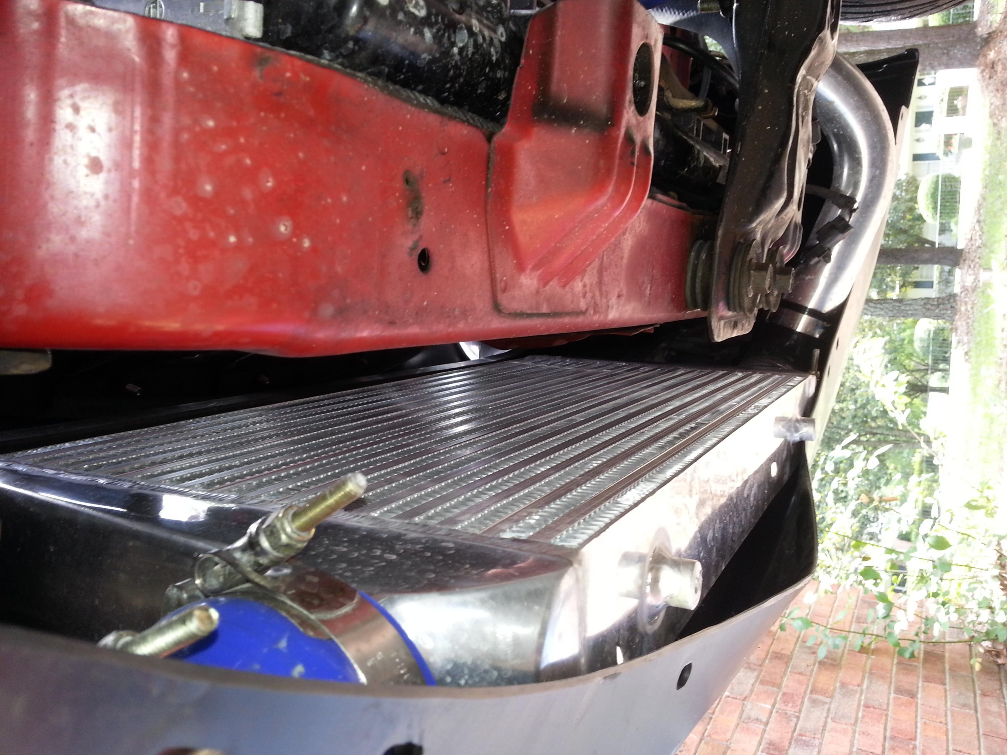

Well finished up the install today, and required more then just "bolt in" like advertised.

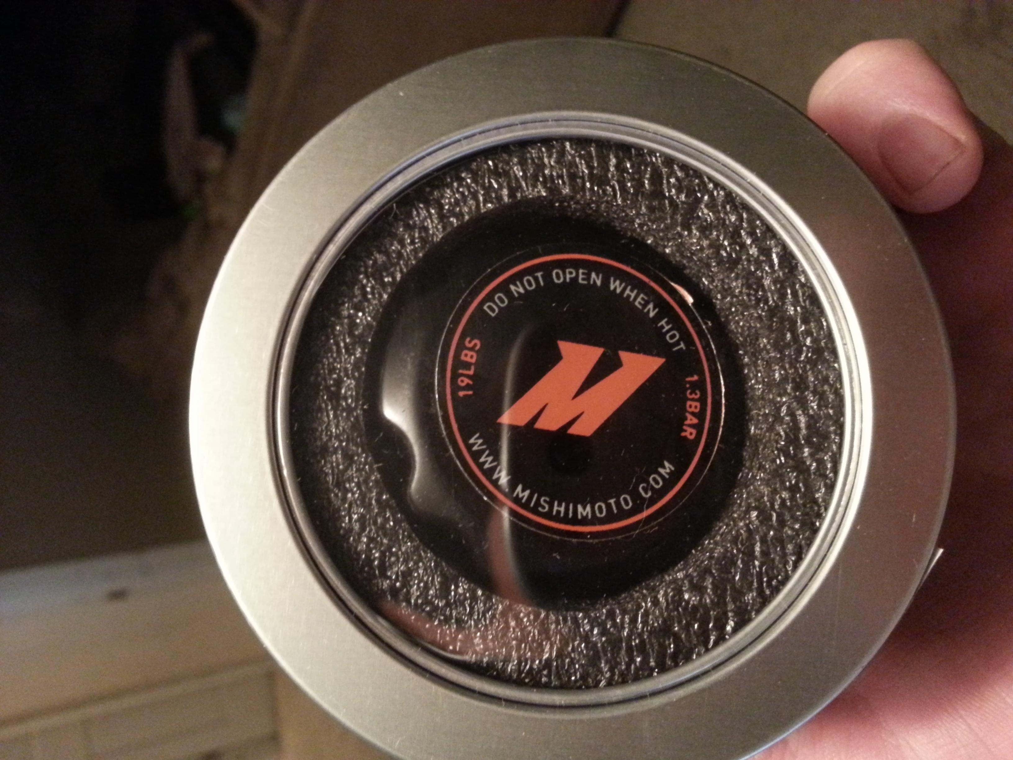

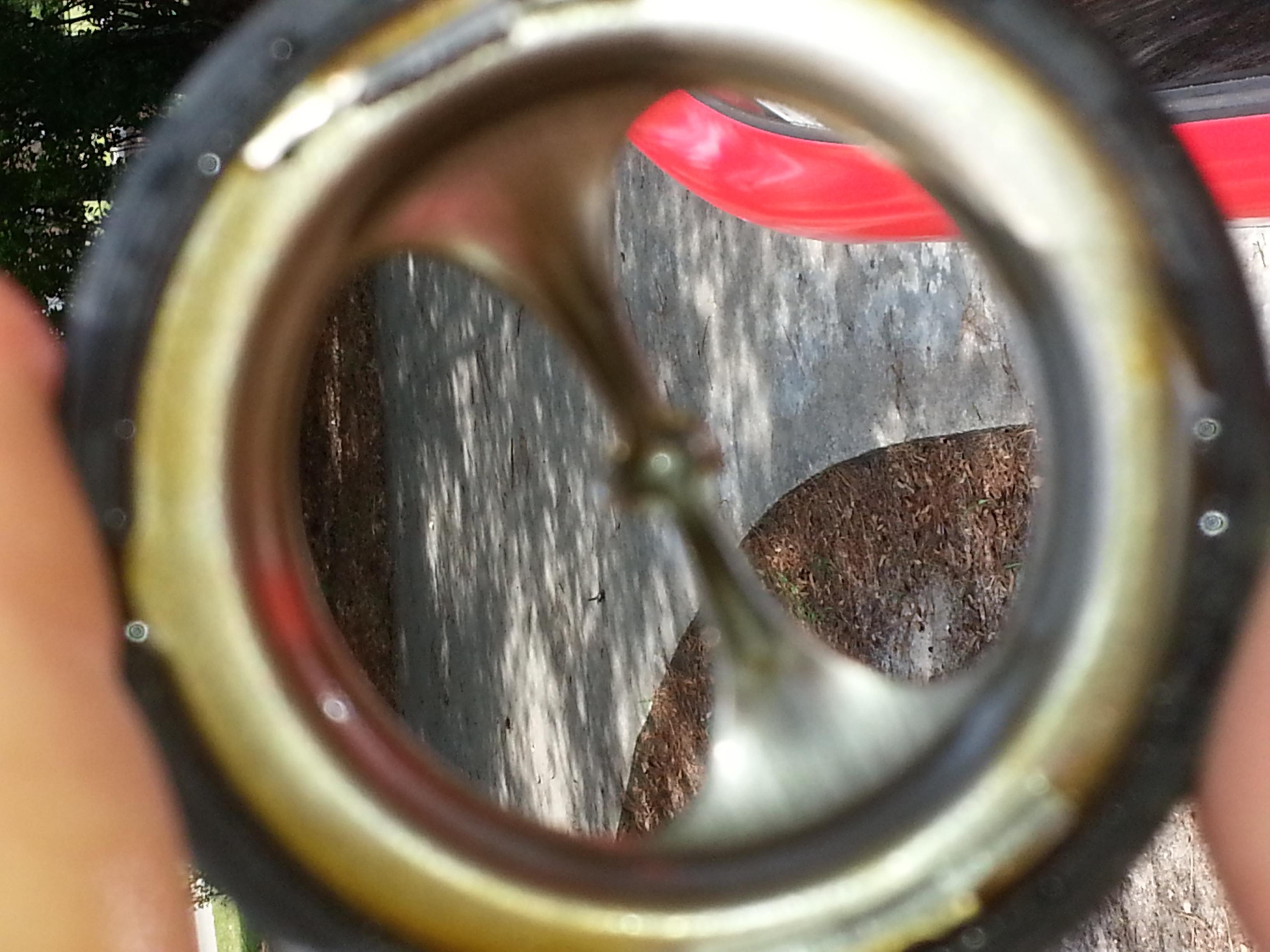

For starters the radiator looks awesome. I was very impressed with packaging and looks. And it was a direct bolt in however, it required cutting of the stock fan shroud to clear the coolant hoses, as well as notching the shroud to clear the t-bolt clamp holding on the i/c pipe, as well as slightly rotating the coolant overflow mount so that it would fit with the fan now being moved due to the radiator being 3 rows instead of 2. I also noticed that the fan stand offs pushed the fan farther away from the radiator then the oem radiator, haven't started the car yet so we'll just have to see if maybe I'll need to figure out a way to enclose it better.
I also was a bit disappointed in the radiator cap. It should be an easy fix but when you fully tighten the cap the decal on it is not facing the way I thought it would. It looks to just be glued on so maybe at some point i'll heat it up and rotate it so that the "M" is facing the way I want it to.
Here are the picts - I have still yet to go for a drive as wife had to leave for work and I'm playing with the kids.

Old 07-19-2014   #16
While I was looking for something to cut the fan shroud with I found a bunch of spare parts, including a brand new never opened Greddy radiator cap, a few FP couplers, and a few misc sensors, fuel rail, clamps.
Here are also more pictures of the radiator install, and misc pictures of things on the car.

well just did my first start up and will go for a drive once my wife gets back from work.
Started the car made sure there no bubbles or leaks, and then went inside to grab the laptop. My 2yr old got me distracted wanting dinner so I made her some food, then remembered the car was still running (10min) so went out and plugged in the laptop.
Temps were sitting at 203, I let it capture data for another 3 min, with me in the car and temps never moved.
