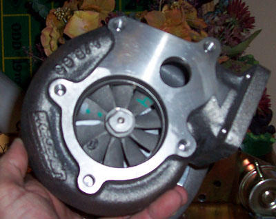

Old 03-09-2005   #8
TrboVan
Join Date: Mar 2004
Location: In Front Of You!
Posts: 24
Send a message via AIM to TrboVan
Re: Wastegate help
Thanks Jet!
Yes, here is the turbo.
