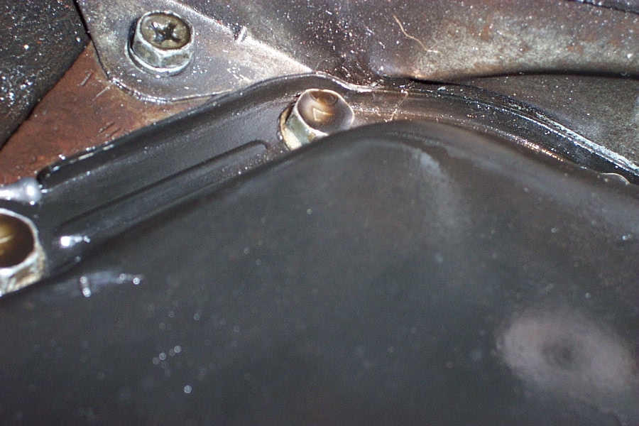

Well I did find a crack in the oil pan. The Black RTV actually seeped through and tried to seal it. It goes from the bolt hole all the way out to the bell housing area. I am going to price them tomorrow...or just have my buddy tig weld it and smooth it down. You can see the crack in the picture just to the right of the top center bolt of the oil pan.
I also found that the oil seal at the out-put shaft to the drivers side shaft was leaking good also. I thought I smelled Gear-oil also!
Anyway...I know what I am doing tomorrow!
