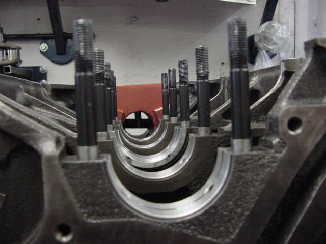

Here's a good pic of the pin around the ARP's on my motor.

Re: 7 bolt girdle
Nice, Carl can we steal that pic for our motor building page?
Thats funny I stold it from the qpr page. Ive got a few more if you want them
