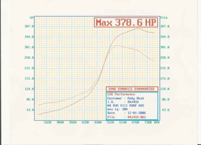

22psi, Pump Gas
378hp/308tq
Big thanks to everyone at LSE, Josh, John, Ryan, and Chris! They did a great job on getting this running with all the problems they ran in to.

Care to share the rest of the setup?

Built 2.0 Wiseco pistons Crower rods, SC61, HKS 280's, FIC 1600cc injectors, 3" TB, AEM, DnP Manifold, ect...

What kind of problems were you running into? Or is that top secret too?

The crank being shot and having to find another one. The turbo needing a rebuild. The manifold having to be re-welded.

Are you still on the stock manifold?
Those are pretty decent numbers for pump!

Stock exhaust manifold no, DnP. Stock intake manifold yes.

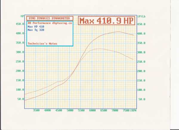

387 is actually 23 less then I was making with the meth before the rod bearing spun. 387 is still damn fun!
I think I'm done modding the car. The only thing left to do is put on some break in miles get the meth injection hooked up, put some c16 in it and turn up the boost.
Here's the dyno graph from the before the motor build. 29psi with methanol.
