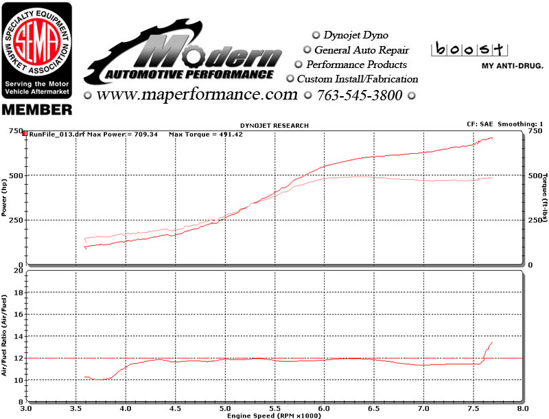

709whp from Modern Automotive Performance!
'93 Eagle Talon TSi AWD
MAP 2.3l Stroker
MAP Stage 4 Cylinder Head
MAP FMIC Kit
MAP 3.5" Downpipe
38 psi on C16 Race Fuel
Dynojet 224x Dynamometer (FWHP)
*Please note that the car should rev to 8500, however around 7500 in fourth gear the tires spun on the dyno Notice the power is still steadily increasing...
I *believe* this is now the highest recorded DSM HP number in Minnesota with the exception of Brent Rau!

Nice work! spinnin the tires on the dyno at 7500 is nuts.

Yeah, unfortunately we can't do any crazy strapping of the car.
Next time around I think we are going to pull it on, strap it down, spin it on the rollers to make sure its straight, and then deflate the tires and strap it tighter, then re fill the tires. I cant think of any other options outside of slicks.
I am kind of confused about the low torque numbers too, but with how well it holds torque all the way up to redline, I think it will still be insanely fast. The motor has pretty high compression.
Chris's car only made 537ft lb's, and that was a 2.4.
I think we might be able to get some more out of it as far as torque because we haven't even really touched timing in DSMLink yet.
Would having an overly ported head do it? That could explain the low torque numbers on both Chris's and Kyle's cars for what they were running. It looks like the upside to that though is that power holds forever with large cams, and keeps the powerband very broad.
Torque breaks shit anyways! lol
There is zero boost creep. It hit 38ish lb's and held steady.

We were wondering that as well, the T67 powered Spyder we have made 520+ ft/lbs and my old 2G made 537 at 686whp. However, earlier in the tuning process Kyle's car did make that same 537 ft/lbs but was only in the mid 600's in regards to HP. Any ideas?

Well, it's not like you want torque, since all it does is break shit. My T67 spooled fairly fast, which means more torque in turn.
Did you get any pulls where it didn't spin the tires? Spinning the tires can cause the numbers to do weird things. If it started spinning at 7500 in the pull above, you can see the HP, TQ, and A/F chart trends move up in a weird way after 7500.
I think I was running around 12-14 degrees of timing up top on my car.

Very true lol. We only made two pulls over 700whp as it was like 4am, however check out the A/F in the dyno graph above 7500 it goes crazy as you said.

I just went back and looked at the runs. Pretty much every one of them over 635whp was spinning the tires between 7500 and 7800. DSMLink showed wheel speed and RPM up to 8500, but the dyno was cutting off every single one. I didn't even really notice. On our "low boost" 25 or so lb's pull that it didn't spin (first "full" pull) it looks like it made about 450ft lbs (had a spike that said it was at 540ish) and 577whp. Horsepower stayed identical between 6800 and 8200 (within 5hp).
Spinning was the name of the game on our dyno. we really need slicks.(for the dyno AND for the track) I think the car has 725-740whp in it at its current boost level. It sure as hell should be making that.
