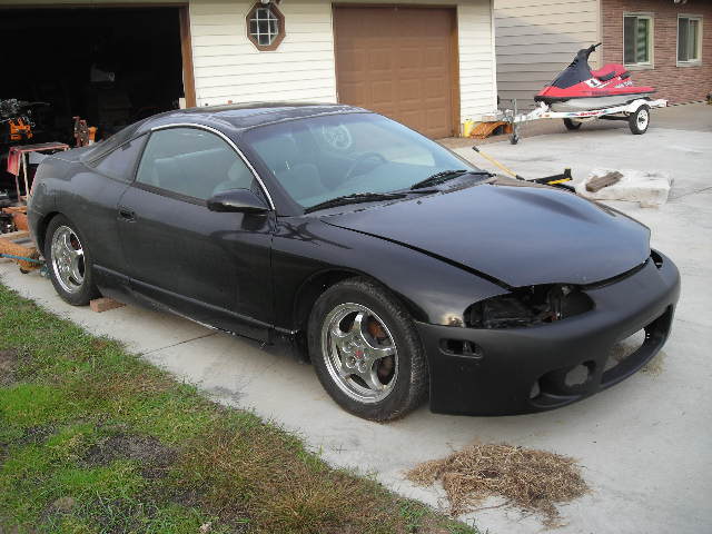

As some of you know I started the dsm addiction with a 95 Talon TSI FWD. After a while with that by buddys Eclipse spyder blew a rod and that is where my motor transplant went followed by the AWD swap.

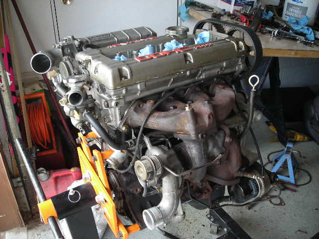

Now I am left with my 95 Talon and decided to build it to sell. I have so far gotten the motor all rebuilt 6 BOLT SWAP and ready to bolt into the car once the tranny is attached to it. Here is a list of things that have been done to the car so far.
Motor (ALL NEW)
6 bolt block
Rings
Main and rod bearings
Oil pump
Water pump
Timing belt
BS eliminate
Fresh 1g head
EGR blockoff
Emissions elimate
All gaskets
Exhaust
2g exhaust manifold
t-25 turbo (quick spool "remember all stock ecu and management" )
2g 02 housing
3" downpipe w/cat eliminate
3" catback
Intake and fuel
450 injectors
1g intake manifold
2g TB elbow
2g throttle body
Injen intake with filter
Interior
Black new replacement carpet
Dyed black center of seats
Black suade headliner and door pannel peices
Exterior
Black paint (needs some touchup that I might do)
97+ headlights
97+ front bumper
95 talon rear end
Chrome 5 spoke rims
lowering coilovers
Thumb nail wing eliminated
I have to put the motor and tranny in and it should be running soon here. Ill update anything new that comes along. Once done I will be putting this car for sale in the Classifides section.
