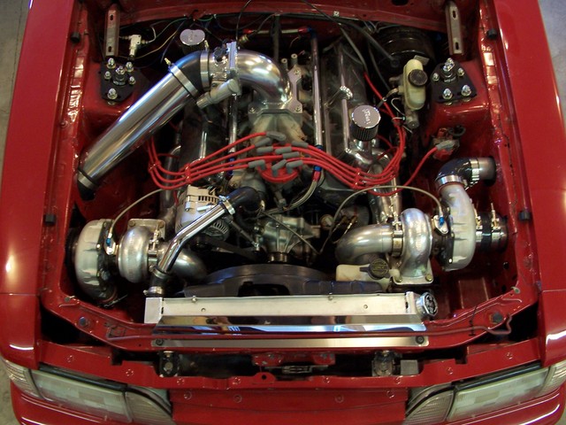

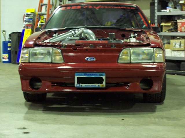

No replacement for displacement?
What happens when the V8 guys find turbos?
Some of you guys may have seen this car at the shop over the winter.

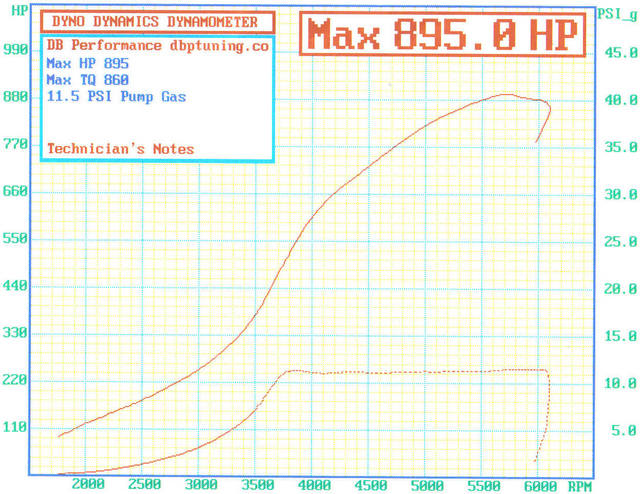

We had to stop at 11psi because the mostly stock ignition couldn't keep up. You can see it in the graph when it goes flat around 5700RPMs and we stopped the run not long after. It was fine at 9psi making 770whp. The plan was to shoot for 15psi on pump gas for now and maybe max the turbos on race gas someday.

I know I asked this before, but what does his car rev to?
I need a V8.
Old 06-08-2007   #14
Re: No replacement for displacement?
I need a V8.
7000 or so, we brought it out a lot farther than in the graph above on lower boost runs when it didn't misfire.

That was pump 92? Like.
Old 06-09-2007   #16
Yea, normal 92 octane pump gas. It was only 11psi. The motor was built low compression for turbo.
