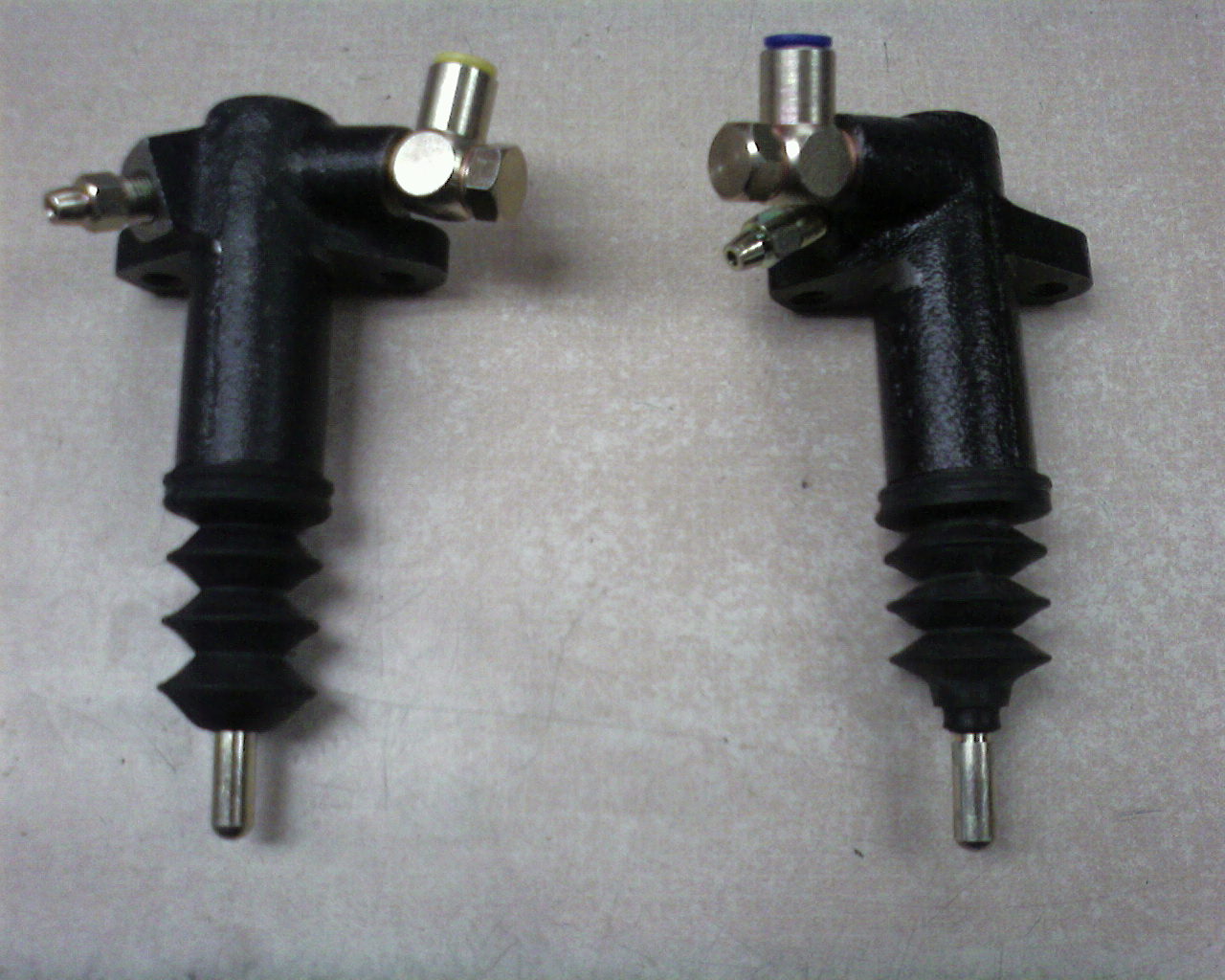

Turns out you guys were correct!
The only way to use the FWD slave cylinder is to run new metal brake line....which I am not willing to do now.
Here is a picture of the FWD(yellow cap) vs. AWD (blue cap)
