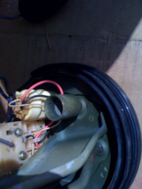

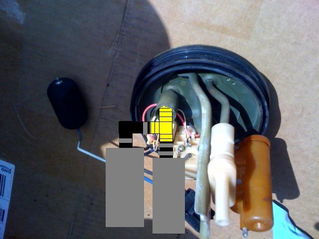

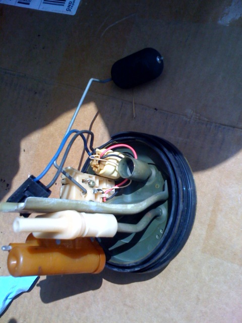

I have a 96 Talon AWD, so the fuel sending unit is under the back seat, passenger side. This past weekend Halon and I were going to install dual 255 fuel pumps (I'm switching to e85 and 1600cc injectors), but we discovered the fuel sending unit is a bit different than on a 1g, so we decided to just install a single 255 for now.

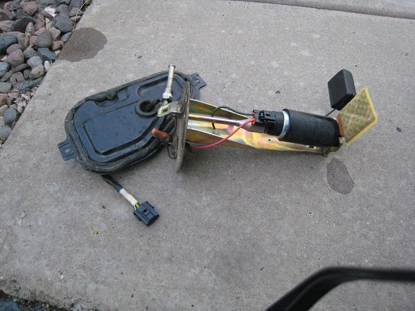

The first picture is of the 1g assembly, taken from Halon's thread. The next two are the 2g version, you can see how there isn't a long metal tube to cut off and connect fuel hose to. Has anyone done this in a 2g without spending $$$ on a custom fabricated unit?
I thought about cutting off the end where the pump mounts and welding on a small metal tube to make it look like a 1g setup, think that would work?

Why not find a piece of hose that is big enough to fit OVER that piece on top, run it to an appropriatly sized T. Then feed the two pumps into that? Curious to see how you gonna do this.
The evo one is similar, but the whole bottom section is plastic. Wondering how to do this on an evo next, possibly....

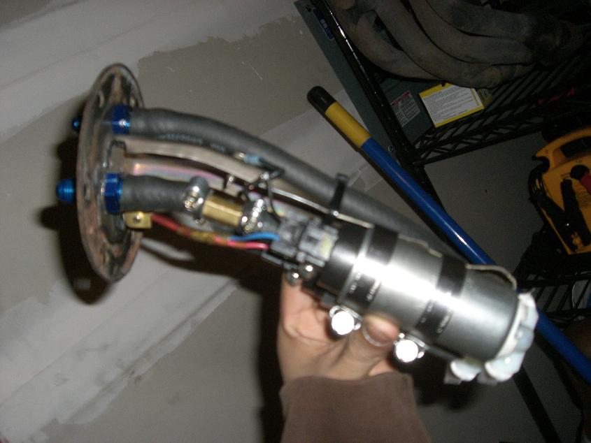

Use an AN bulkhead fitting, and just eliminate that socket part that the pump plugs into. As shown in my setup here

Also if you are planning on keeping the stock fuel lines, the Full Blown drop in unit has AN Fittings attached to it for running all new lines.

Wow, $500 for a drop in pump holder for a 2G? I'm sure those are flying out the door. Like others have said, running AN lines and bulkhead fittings will cost you about $50 in parts, but last forever, and best of all, look cool in pictures.

I also am going to do a dual walbro setup on my 2g. This is what my single setup looks like with 6an lines
I used this part...
The only problem is with the 2G there is no alot of room. The top of the fuel pump nipple is sitting inside that AN fitting(with hose around it) and its still sits too low.
I have a spare sending unit and 2 spare walbros. So soon I am going to fab my own and not spend $500 on it
