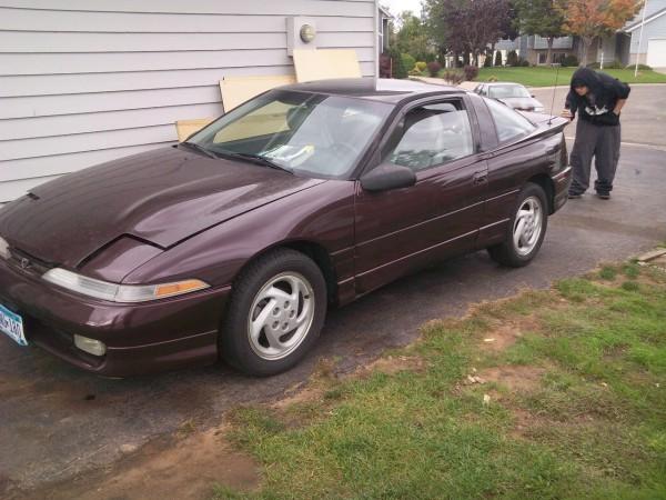

i picked up a 91 talon a few weeks back and its been a fun ride until things go boom i bought it running with spun rod bearings the head was still good so i picked up another engine another 7 bolt and it was ok ran find until i found out the o2 was bad and apparently ran it so lean it exploded a rod thru the oil pan all the exhaust valves are white .. so i got another engine a 6 bolt short block from grease monkey . I did the balance shaft delete.
so far had bought a gates racing Kevlar timing belt ,aem wide band, hallman es boost controller, dsmlink, meagan 3 in downpipe , fp evo 3 ,arp head studs ,boost Gauge ,oil pressure gauge, wallbro lph 255
things yet to buy are
injectors 650-1000 cc
fmic
adjustable fuel pressure regulator
cams
so this last week has been a real pain in the ass been thu 2 engines both were 7 bolts. learned my lesson about those . 6 bolts are where its at
got it running today at 4:40 pm it had a heart beat ...
now its all tuning witch i am new to so i think ill wait and have it done some where and watch them do it ... unless some one want to help me out and have some fun ...
