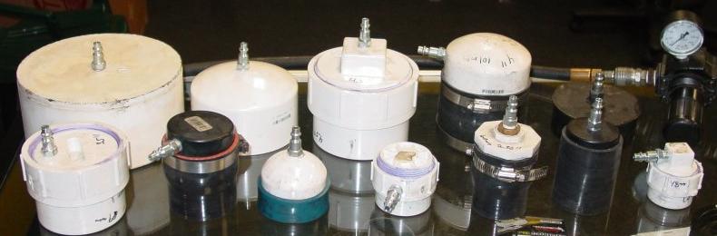

Here are most of mine. The giant 8" one was a joke.

Old 02-10-2010   #9
Re: Post your Boost Leak Testers, (Looking for 4")
8" one for testing hellboy.
Old 02-10-2010   #10
Here are most of mine. The giant 8" one is for My Car.
Fix.t
Old 02-11-2010   #11
Here are most of mine. The giant 8" one is for Toms Butt.
Fixt again.
Old 02-11-2010   #12
lol.
