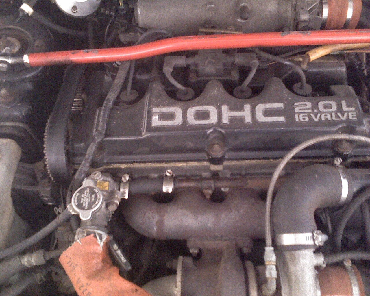

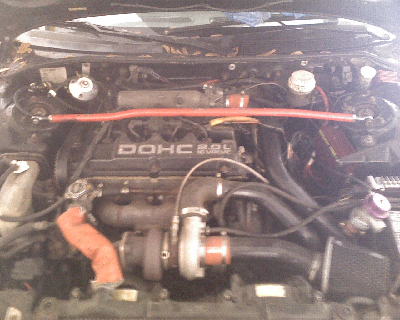

Ok so im 17 years old and have loved DSM's ever since i saw the first fast and furious movie. I recently purchased a 95 Eclipse GS. Thought it was the coolest car in the world with all of the mods. It had a swapped engine, Turbo, Blow off valve, short shifter, strut bar, front mount, short ram intake, custom exhaust, lowered 2 in, and has american racing rims. To a 17 year old who is looking for their 1st dsm that sounded like music to my ears; turned out i got screwed. I brought it to a family mechanic who took a look at it for free and he found that the engine was a bad swap, and the coilovers were heated down to compress so the car would be lower. Ultimately he told me that the car was unsafe to drive. Now I am in the process of trying to find a new engine, and coilovers to make my car driveable. I am also looking for a mechanic or any refrences to one who will do it for cheap because all of my money went into buying the car. If you could help me out with your suggestions i would greatly appreciate it.

From what i was told by the mechanic. It is a dodge neon engine (i feel stupid about not noticing that) and he said the turbo isnt housed right or something. I could take pictures if that would help

neon engine,
dsm 1.8 liter engine,
dsm 2.0 engine.
what does yours look like?

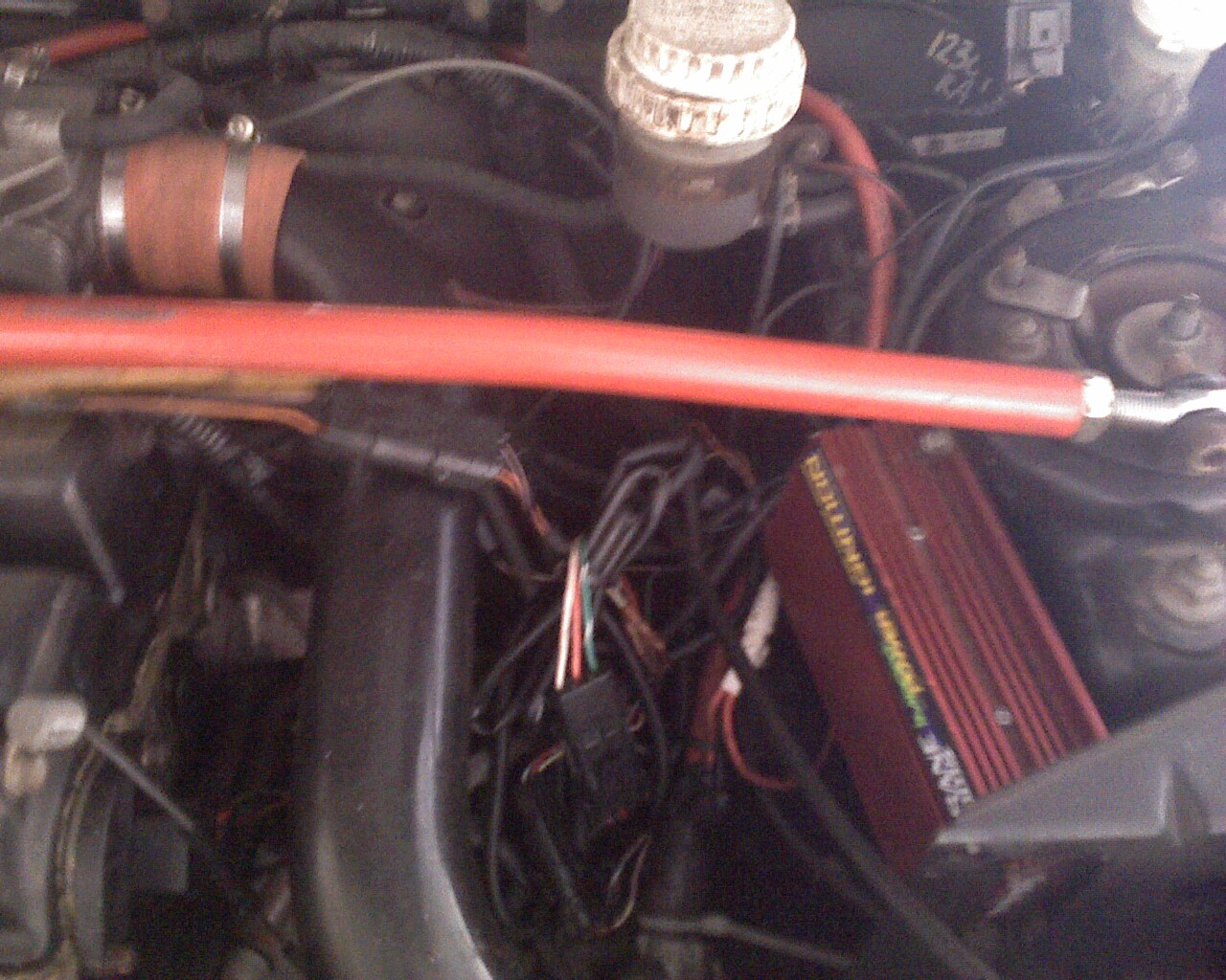

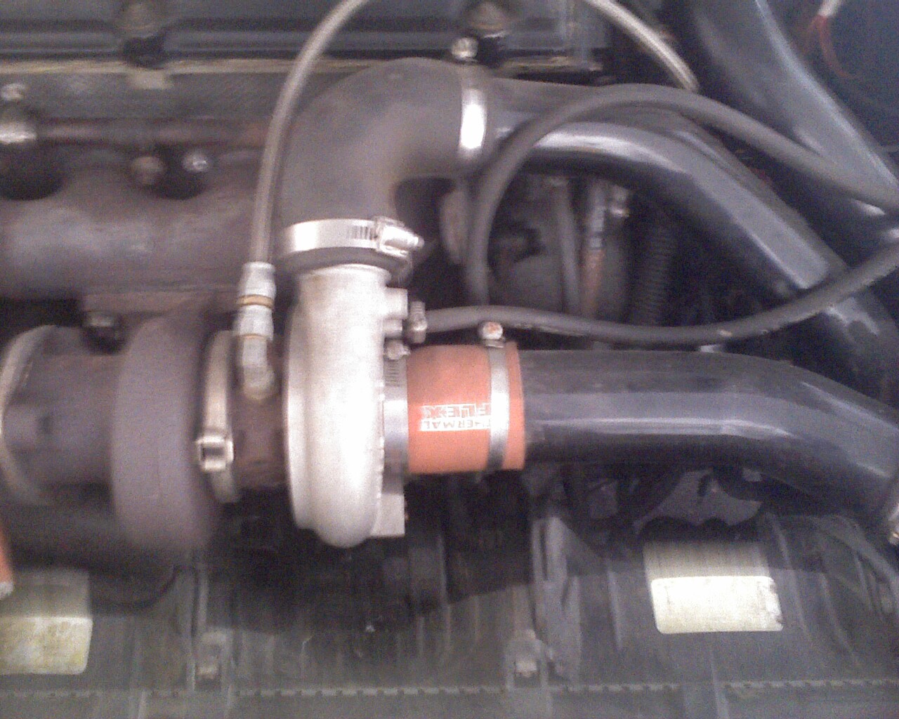

Ok give me a break im 17 and need to learn alll im looking for is help not criticism

If your Eclipse is a GS, then that isn't a swap, that's the engine it came with.
He might have meant that the engine was clearly removed and replaced (rebuilt or a motor from a different chassis). That would explain the wiring.

If your Eclipse is a GS, then that isn't a swap, that's the engine it came with. It has (what looks to be) a Hahn turbo kit on it. Other than the wiring being a complete fucking mess, that car shouldn't need any kind of engine swap at all, not sure what the mechanic was thinking...
Also, clarify a bit more what the mechanic was talking about when he said the "turbo wasn't housed right"
I would STRONGLY reccomend bringing this car to one of the site vendor shops (DB, MAP) and have a mechanic that knows what they are doing take a look at it.

looks to me like a turbo'd 420a engine typically found in the 2nd gen dsm's.
i believe the same motor from a neon is actually sohc, and mounted backwards. as well as a few other differences.
the 420a out of an avenger or sebring would be the same from my understanding.
im guessing that the car is did not have an engine "swap", but had the engine replaced. and a turbo kit added

Damn you guys are good. This is exactly what im looking for. So what your saying is the engine shouldnt be a problem just from first glance? and i want to do work myself but i dont wanna screw anything permanently. I can do the basics i.e. change oil, and tires. If i just get the coilovers replaced i should be good? I understand you need to look at it but i just kind of want just a little something. Also the wires i want to get cleaned up and shit and maybe someone could help me with that. They are attached to 2 cams which i have no clue what they are for.
