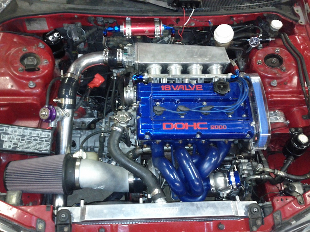

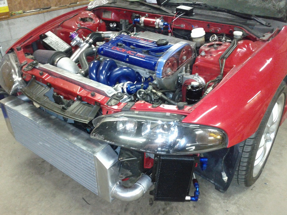

I am finally done with my build and just set up my dyno day at DBperformance in Roger,MN. I am going for 500-550 awhp and is still my DD. I would be lying if I said I wasn't nervous but I hope she doesn't blow up on me. I am bleeding the brakes and burping the power steering this weekend and she hits the dyno 10/14/11. Anyone have anything I should recheck before going there?
Here are some pictures of the finished product:

I have a borg s259 ett with a custom twin scroll t4 housing, DP t4 manifold,turbosmart 45mm WG, v-band exhaust, stock 6 bolt rods with evo 9 pistons, JMF race intake mani, VR speed FMIC, built head, a lot of bolt ons

Isn't that kind of a small turbo for a t4 housing? Or is the fact it's twin scroll gonna make it not matter? And your biggest hurdle is fuel system, having enough pump to keep up with the demand of 500awhp on a dyno dynamics.

I have a walbro 255 intank and an Aeromotive Tsunami inline pump. The exhaust housing is an .84 AR housing so shouldn't have any problem spooling.
