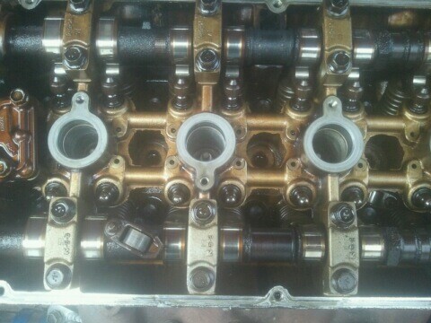

So hey guys yesterday i was driveing my 1999 gst eclipse, just a 16g,fmic, 3inch exhaust. I turned a corner went to shift into second and it just died? Was running fine all day. Towed it home and pulled timeing cover and valve cover timeing was on, But ALL the rollers for the cam and spring were off on the exhaust side! They were just laying in the head! the intake side of the cams was perfect everything was good? Tryed putting rollers back on and only 3 of the 8 stayed on when i re did them and tighted down cam? what do you guys think happened? thanks hope i uploaded pics okay

Yes the belt may be in 1 piece, but I bet the timing marks will not line up. I would guess the balance shaft belt let the ghost out or the auto tensioner failed. If you turn the motor over my hand and look at the cam gears with both pins up and the timing marks pointing at each other in the middle of the cam gears you can look down at the crank pulley and the timing marks should line up with 0 on the front cover.
~John
I think you hit it dead on, before i pulled valve cover i tryed turning it over compression was 0 and seen strings in the timeing cover, so if i redo the timeing and "say" my head is good, hould i be able to salvage the block even tho balance shaft belt broke?

I had the teeth on the timing belt on my 90 laser sheer off on the crank gear. You could crank the motor over by hand but the cam gears would not move. But when I took off my Valve cover it looked just like that.
So its at least some timing belt or tensior failure.

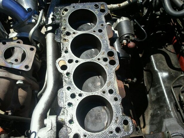

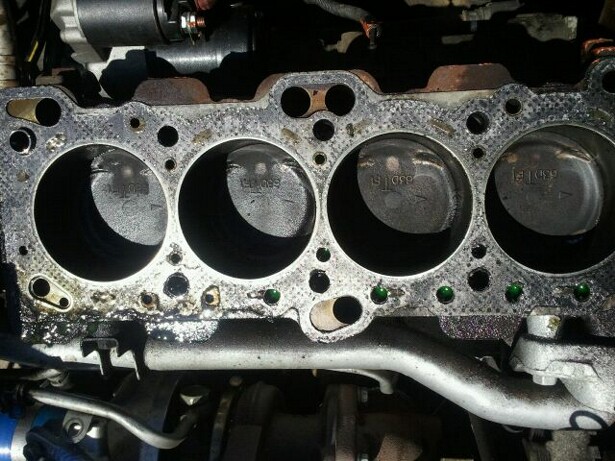

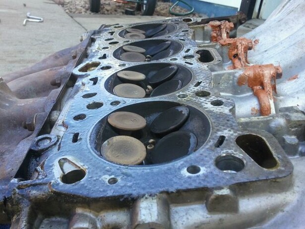

All right head off! EVERY VALVE BENT! 6 BOLT TIME ! lol or should i get a head and say fuck it?

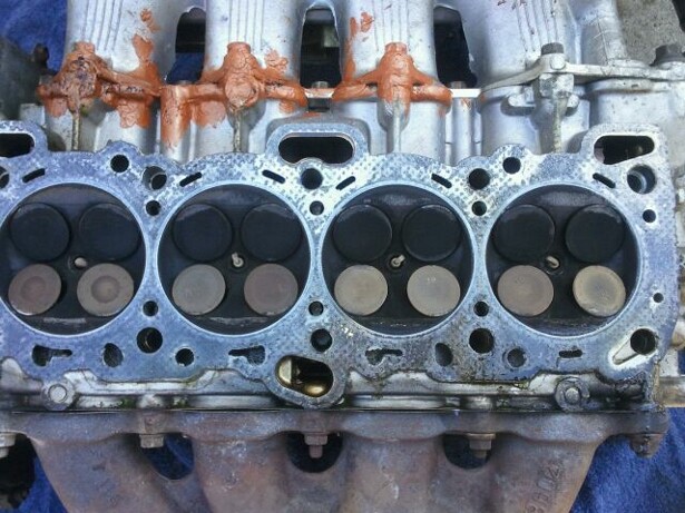

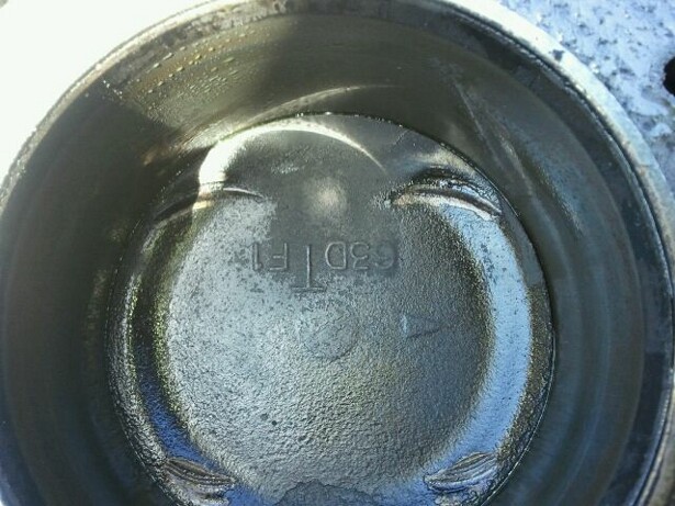

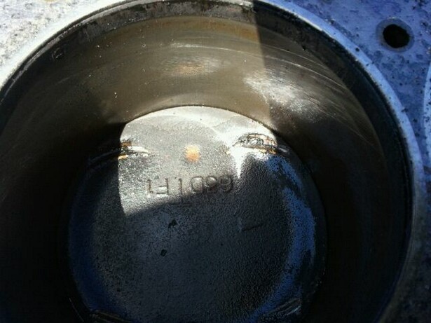

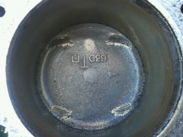

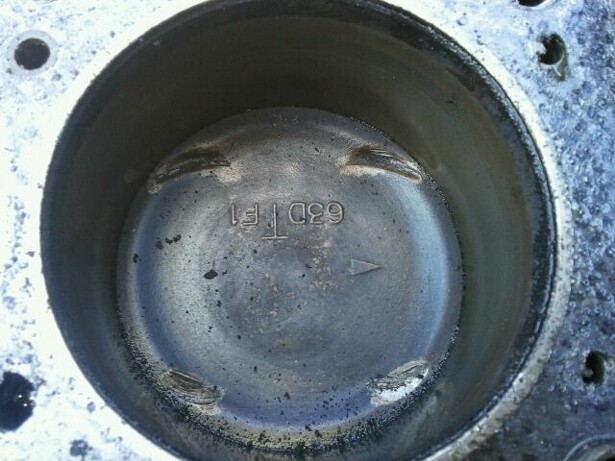

Soo more pics?

The head doesn't look damaged at all... If it isn't damaged, why replace it? Obviously have it gone through and new valves, etc though.
EDIT: Did Tom own this at some point? who the fuck else globs orange RTV all over stuff like that?
LMFAO i was going to say the same thing. hahaha
Orange RTV FTMFW!
Edit: does that look really odd to anyone else where the head meets the mani, almost like he stuck a 2g intake manifold on a 1g head? Looks like its dangerously close to a VERY large leak.

Fix the valves and let 'er buck.

Yea but for as much as it is to have it gone though i can get a new 7 bolt head from a buddy for 100, and put my cams and intake mani on and go, Do you think the pistons are to bad damaged? will it lower my compression at all? or even run right? thanks

lol yea idk i got it and it needed a flywheel/clutch, did that 2 months later this. So should i put the 200-300 into it for a new headgasket arps and gaskets,even though the pistons have a little valve marks where they hit, or just grab a 6 bolt? even tho im low on funds.

The little marks on the pistons are fine. You can clean them up a little and run it. My Laser had some pretty good marks on the pistons and I just cleaned them up, put new head on and ran it. No need to swap out the motor if everything else is fine.
