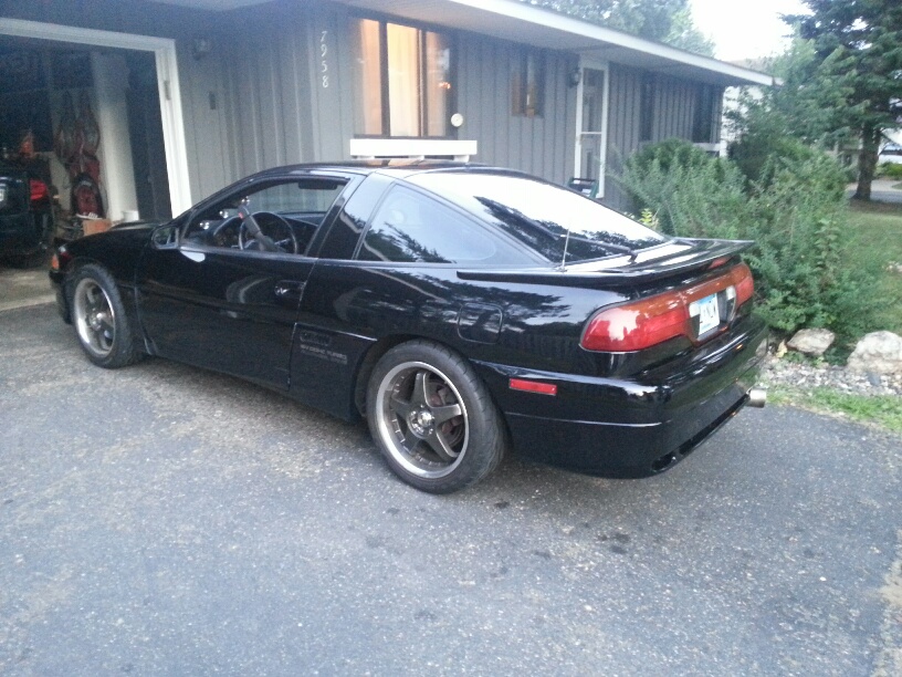

About a year and half ago I was looking for a project car, something I could spend some free time on and also wanted a vehicle that would be a fun street car to drive during the summer. At the time I really didn't want to spend a lot of money, looking at EVO's was my first option as I really liked my 2005 I had. Realized pretty quick that pricing for a quality well kept and low mileage evo was still quite high. So after some craigslist browsing for awhile I came across this Talon, looked really nice in the photos and best of all it didn't have any rust so I went and checked it out. Now as anyone can assume on a car this age it was not in perfect shape. It had an exhaust leak and slight misfire in the higher rpm's and smoked a little bit from what appeared to be oil.
Well after consideration and a little bartering on the price I ended up coming home with this.
The mods it came with were not much, it came with HKS 272/264 cams and really crappy 'slip fit' homemade exhaust and evo 3 manifold and some guages. Still had the stock intake with the huge maf sensor. But he also threw in new intercooler piping(short route) a rebuilt "bastard 20g". A crappy a/m 2g intake with maf sensor and some evo8 injectors.
I figured since this car had never been tuned I would get everything swapped over and start with the new parts the guy had to get some more power out of this car. First I ordered the intercooler to match the piping and bought new spark plugs and ordered some exhaust gaskets to fix the leaks.Then began taking everything apart.
