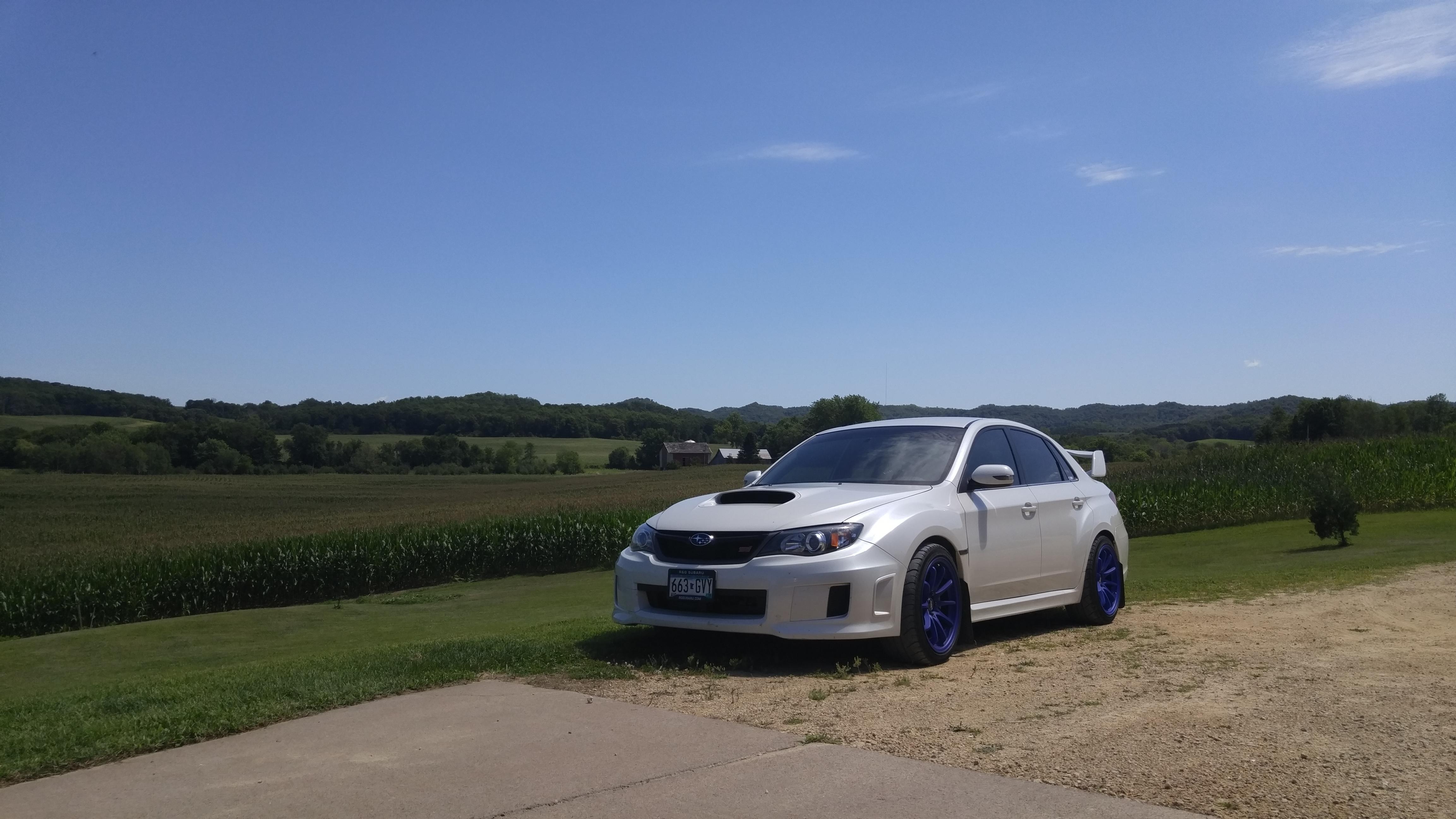

So i guess ill create a build thread for my 2011 Sti. Little backround on the car i bought the car back in August drove it till about october i pushed it a little to hard and spun a rod bearing. Then there my build started. So heres a list.
Longblock :
Stg 4 plus iag closed deck (oringed,pinned mains)
New oem Sti Crank
Manley turbo tuff I beam rods
Manley extreme turbo tuff pistons
King bearings all around
Killer b oil pickup,baffel,and oil pan
Je pro seal headgaskets
Iag (arp) 14mm headstuds
Gsc s2 billet cams
Gsc intake/exhaust valves
Gsc beehive springs
Turbo setup :
Ets rotated kit
Pte bb 6062
Tial wg
Ets Fmic
Tial bov
Speed density
Drivetrain:
Act 6 puck xtreme clutch
Act flywheel
Fuel :
Iag fuel rails
Injector dynamics 2150cc injectors
Walbro 450 intank pump
Aeromotive fpr
Wheel setup :
Enkei rp01
Mickey Thompson et street r slicks 245/45-17
Other goodies :
Aem boost,oil pressure,wideband gauges
Mishimoto radiator
