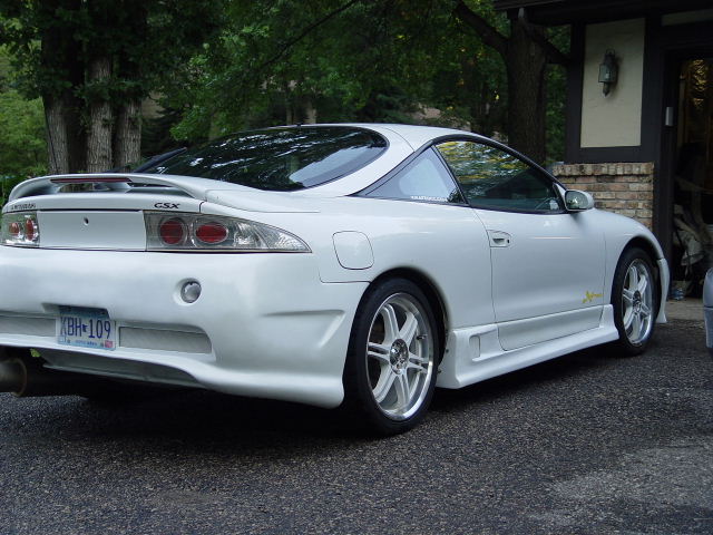

Here are some new pictures for you all.

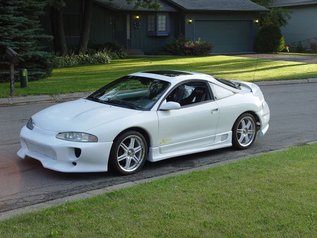

pict 2

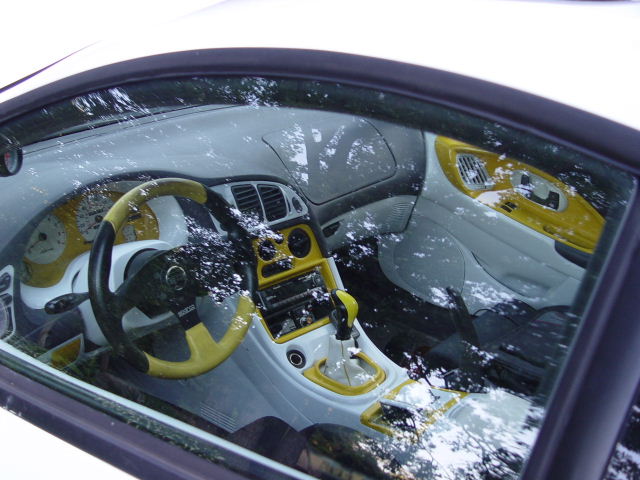

pict 4
File Type: jpg Exterior_Shot_of_interior_with_Window_up.jpg (67.9 KB, 93 views)

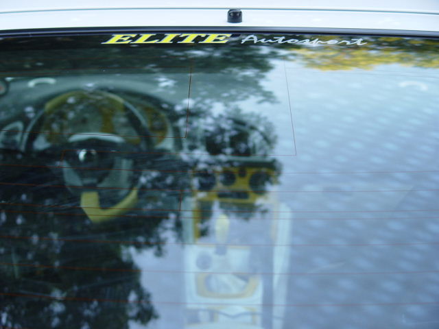

pict 5
Old 07-14-2004   #17
Enes
Enes's Avatar
Posts: 2,789
Now that looks toyt!!!!
get rid of some of the yellow, and it will be pretier !!
_E

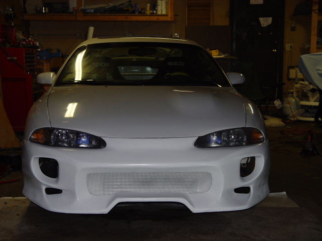

pict 6
File Type: jpg Exterior_Garage_Shot_Front_Hood_Closed.jpg (40.1 KB, 92 views)
