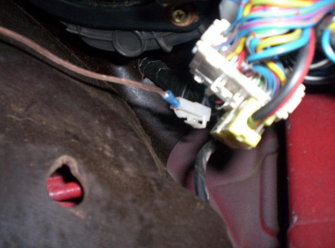

There should be a wire behind the passenger side kick panel you can splice into. i can get a pic of mine if you need it.

Re: A/F gauge hookup..
heres a pic you can see where I taped into the plug with a spade terminal

There is the 1G ECU pinout above.
The #4 pin on the far right plug is the Oxygen Sensor wire. Tap into that and then you just have to find a power and ground. You can use either pins 101 or 106 for a ground. Power I will leave up to you because there are numerous places you can get power from. I can't remember the best one or the one I used but I am sure somone will.
