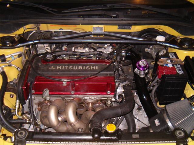

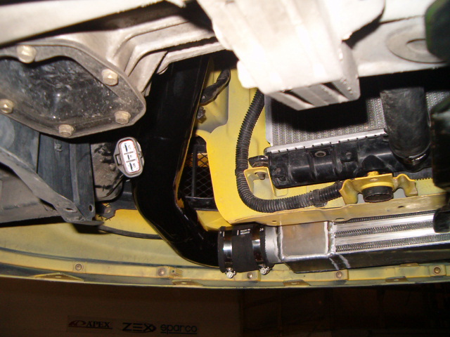

Setup i did awhile back figured i'd post up some pics. Don't have any dyno #'s yet or track time as the trans doesn't like to shift @ anything over 6500.
Garrett GT3076
SLS Manifold
SLS IC piping
SLS downpipe
Garrett 24x12x3.5 IC core
TIAL 44mm
FIC 750's

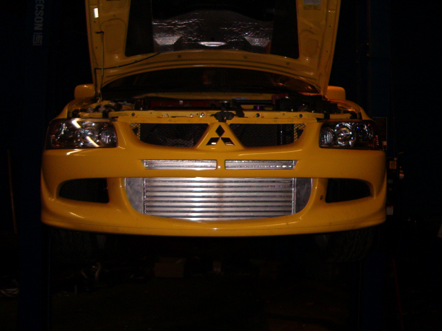

I don't think that IC is big enough, you can still close the hood.

Running just an AFC and stock motor for now.
As far as overall surface area a 1G DSM race core is actually a chunk bigger. The 24x12's just look so damn big.
