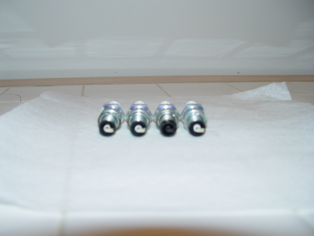

Ok just did a quick pull of the spark Plugs and a compression test.
Here is a picture of the spark plugs in order from passengerside to Driverside along with there compression. (done while motor is cold, spark and fuel disabled)
#1 - 180
#2 - 170
#3 - 190
#4 - 170
Oil level is normal, Coolant level is normal. However these spark plugs have 7 runs down the track and then 18 miles back to the house on them and look how White/Black they are.

#2 is definately having issues. You might want to do a hot compression test on the engine to see what you get. I would also swap the plug wire to see if it is arc'ing.

wow, that is pretty shitty compression for being a new block.

Jet what do you mean by swap plug wires/Arcing? Do you mean swap the wire that coincides with the spark plug that's "Black" to see if it's just that wire that's bad? or what are you talking about?

I am pretty sure he means put a new wire on that one (black) to see if the spark plug wire is causing the problem. He doesn't mean change the order.
