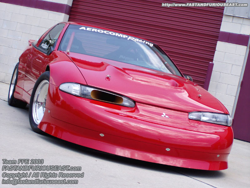

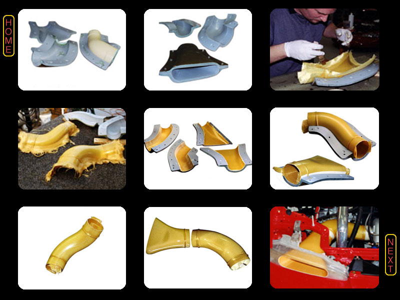

Is this kind of what you're looking at doing?
http://www.aerocompracing.com/induction%201.html

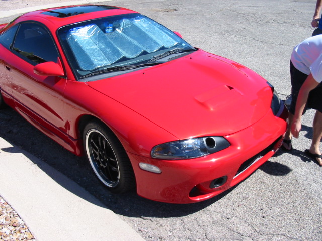

I am looking to do this too. This is one pic I have found. It alows you to keep a headlight so you an still drive at night with it(if you have to)(2G).

Yes! Brandon hit it on the head! Is this something I could purchase?

I think most everything on that aerocomp car was one-off and expensive. I would just run with Jet's explanation and that picture, that should get you there.
