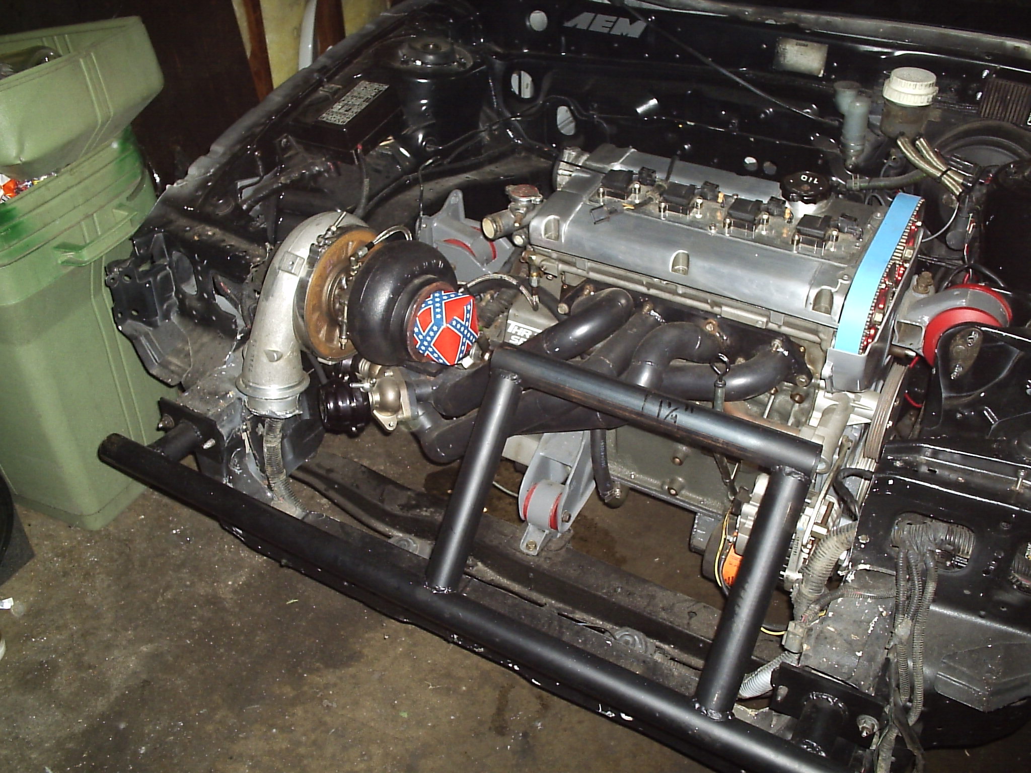

This my first build for a DSM, and i'm trying to do what I do. The motor is only 60% done but it's coming along, trans is built with all the goodies and PTT twin disk. It should be done next week. Once it's back, it's on to get a little body and paint work done. I made a little slide show.

Very nice! Quite a collection of quality parts!
Is that a jhm manifold? I probably got the name wrong, but he's that guy from wisconsin with the low 9sec 150mph 1g.

Thanks. Yep that's Jake, he's a cool guy. It's a JHRacing manifold. The design is crazy. I know it will help spool up but I want to see how much power i will gain from it.

Looks good, what turbo is that?

Is that little cooler up front the radiator? Car looks nice! I like the air horn
Thanks. Do you mean is the oil cooler in front of the radiator?

Looks good!! I like the color choice on the block, Our motors look some what simular..
Did you stick with the 2.0 or did you do a stroker setup?
I thought it might be an oil cooler, is the radiator just not installed in the slide show?

It's a custom spec triple ball bearing Comp Turbo. It's made from the ground up just for racing.

They do have a resemblance. That's some nice welding and fab work.
It's still 2.0 I'm not ready to jump to full drag car, I like to cruise the streets, and it will be capable of running laps at the track. My next setup I will have the motor destroked to 2.1 and have 11,000rpm red line. But that's years away. Right now it's a all around race car . No drifting.

Now for the turbo It's not that simple. These aren't off the shelf parts. Both wheels are custom. It's 70mm the same size as a baby 42r. I can only compare my turbo to turbo's of similar size because I'm actually the only person with this turbo, I never stated any rpm for spoolup. There is no secret I'm withholding. So it's a 70mm compressor wheel ( it's not a Garrett 70mm P trim or 42r wheel) and Comp Turbo's turbine, which is there own design and not a Garrett turbine, with Comp Turbo's own ceramic triple ball bearing CHRA.

Looks decent man, what parts did you use in the motor and what type of 'racing' is that turbo designed for? road racing? drag? Judging by the dual wastegates, it's probably fairly big...but how big?

The radiator is not in yet. Still have to do wiring, radiator, catch cans, and a number of a couple of things.
The engine has ross piston, crower rods, port & polished job, FP 4r cams, etc. Red line is 8500rpm. Ported and polished Forrester intake mani with Q45 throttle body.
The turbo is a .70 twin scroll T4. It's around the size of a 40r but will make more power than a baby 42r and spool up much ,much faster than both. It's big but will spool fast enough for me to lower the boost and do some road racing.

We aren't noobs around here, what turbo is it? TS T4 doesn't narrow it down much, nor does the .70 ar compressor cover.
