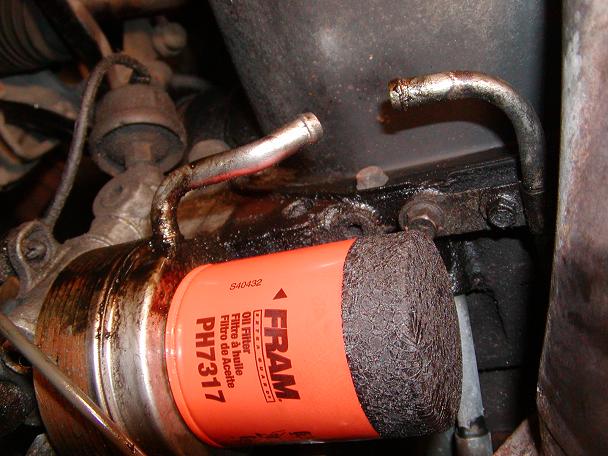

For some reason its alot harder to put your car back together when you wait a year. Glad I broke the timing belt on my 90 gsx to get me off my ass and steal bolts from it to fix my 98 gsx. If anyone happens to know WHAT, WHY, or HOW the following are supposed to be used that would be great thanks. <See Pictures Below>

1st pic......... Silicone hose and 2 hose clamps. Or get a 89-91 Turbo filter housing and a real oil cooler.

Yeah, he is right. There is supposed to be a hose connecing hte two lines in the first picture along with some hose clamps to hold it on.

And scrap that Damn FRAM filter! The check valves in those are made of rubber which expand, contract, deteriorate, flex and come loose; plugging your oil system and destroying your engine.
I work at a dealership, and one of our customers is batteling FRAM to pay for the engine/labor.
Get a WIX or Purolator. Purolator makes most OEM (Mopar, Ford, Etc.) filters.
