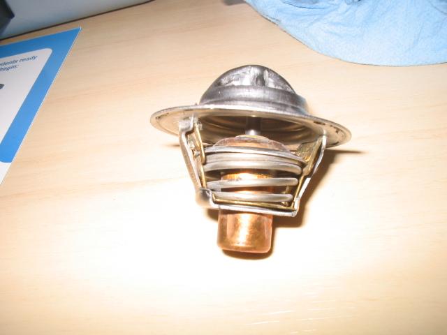

OK in my never ending quest to figure out what in the heck is going on with my car, I'm back to the thermostat again. My car runs hot mainly when driving on the freeways. Hot as in the needle starts to move past straight up and down and I get scared and stop. If I crank the heater, this helps quite a bit, but it sucks driving everywhere with the heater blasting.
So I've been reading up about how people drill little holes in their t-stat. Now I'm staring at mine, and the only spot there's any room to drill, is the big ring around the edge. But I don't see what that would do, that's not the part that moves up and down. Plus there's already a large opening in the top, where the rod connects to. Anyone able to clear this up for me at all?
BTW, car is a 91 tsi. Thermostat is a 160* one from AZ.
Other things I'm doing right now is replacing all the coolant. Going to go with a new mix of maybe like 65water/35antifreeze. Also dumping a bottle of water wetter in. It doesn't appear that I'm losing coolant, but sometimes I think I can smell some. But everytime I pop off the cap, it's full to the top, and the overflow doesn't seem to be budging at all.

Im assuming its a new Tstat. Drilling a whole in the tstat will let coolant flow through the engine even when the tstat is closed. So drilling into the metal ring will do what you are talking about.

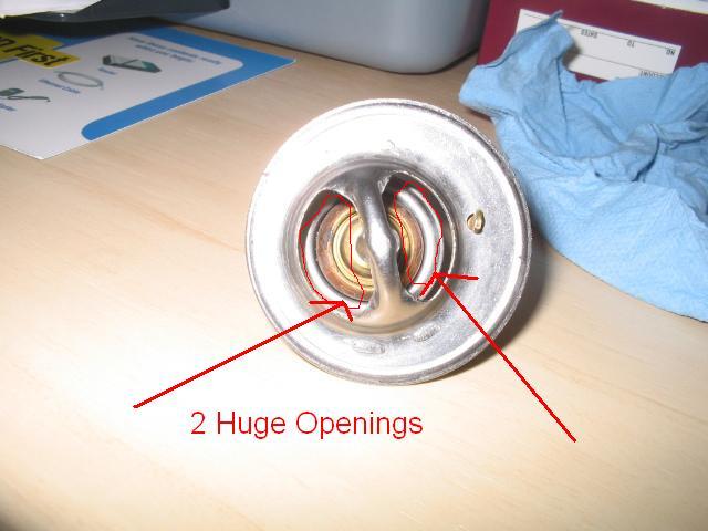

I understand that drilling a hole is supposed to allow coolant to pass while it's closed. But I am staring at this thing, and I don't see how that is the case. There are 2 huge openings at the top of this. This ring never moves, nor does anything ever seem to seal up against it. So I don't understand.

Drill on the outside of those 2 openings on the silver/metal part.
If you are wondering how it opens/seals, go boil a pan of water and stick the T-stat in with a pair of pliers. You can watch it work...

I did just do that about an hour ago actually, because I was curious. But I mean, the center piece is what seemed to move, not the big metal ring around the edge. And still, there are those 2 huge openings in the center, so I don't see what my little holes are going to do because coolant could already go through the big openings in the center. But I'll quit trying to understand I suppose, and just go drill the dumb holes. Thanks!!!!
