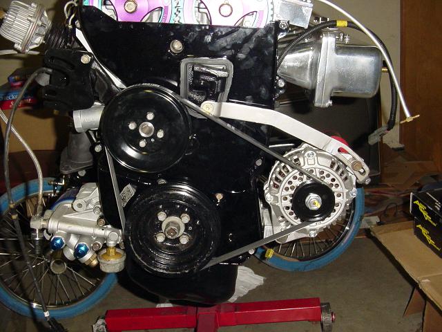

If you try to do it like a 1G relocation kit, the alternator will be hitting the frame. The 2G chassis necks inward right around the strut tower. You could cut and rebox in the chassis, or do some creative work with your own alt relocation kit and run it off the inner part of the crank pulley that normally runs A/C.

I can't even see how it would work. At least with the Jay Racing, you can see it mounted. I'll probably do something like that. Now that Shane mentions it, the shroud over the steering rack might be an issue, which means I'll probably have to mount it higher. Here's a pic of the Jay Racing setup:
