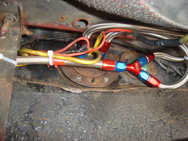

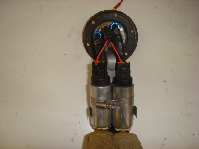

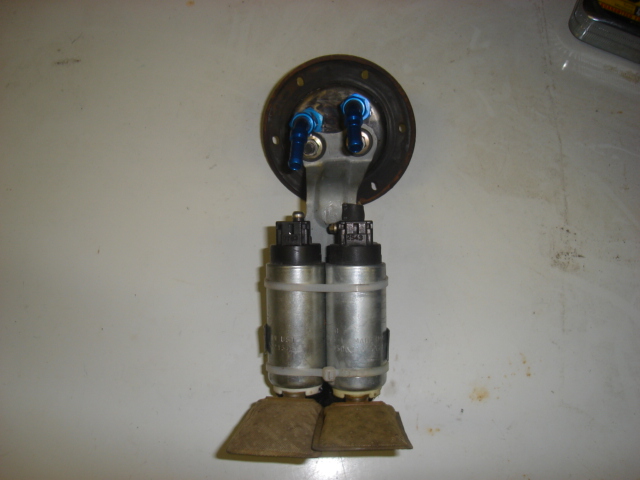

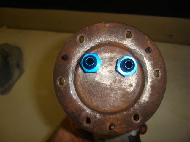

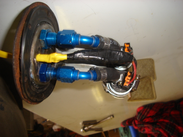

series is one inline pushed by an intank. paralle is 2 intanks Y-ed together.
Series will give you more flow at higher pressure parallel will give you more flow.
If I were you id try to find a fuel pump housing and mock it all up so you can keep your car together while you figure out the duals.
Heres some pics of how my dual intank parallel pumps went together mines FWD so Its a little different but it will give you an Idea.
