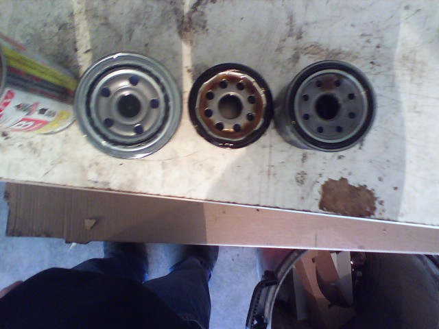

Just thought I'd quick share this info. Hell it may be common knowledge for some here, but today is the first I've ever heard of it.
Apparently the filters that came stock on the 2004 RX-8's and a few other Mazda's (miata, 323) will fit onto our cars. They are supposed to be significantly smaller then any of the Mitsu filters, and may be helpful for those who need a little extra clearance in that area. Next time I'm in town and at the store, I'll have to check it out and maybe snap a quick comparison picture of it next to our typical mitsu filters.
Anyhow, here's some part numbers for anyone else who is in need of the smallest filter possible for space saving purposes:

Shitty cell phone pic for comparison sake added to the first post. This one isn't the Napa Gold, and it isn't the cheapest Napa. It's the middle grade one. It was 3.99.
Basically the circumference of the 2G filter, but the height of the 1G filter.
