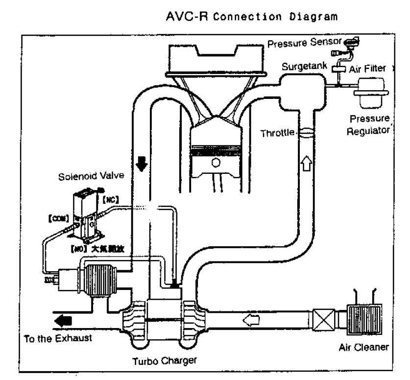

SCM6152E, External Tial 38mm wastegate mounted on the O2 housing. Mounted with gasket no visable/audible leaks, dumping to atmos.
You are running both lines on the w/g right? 1 coming from the intake manifold going to the w/g and the boost solenoid, the other just coming from the boost solenoid.
Originally Posted by shoutbox

Re: Cant boost over 1.5 bar...
This is how you should have the solenoid hooked up with your w/g.
If its not like that, you could also be having issues.
Old 04-28-2008   #16
Yes i have it hooked up like the diagram. Ill try the higher settings.
