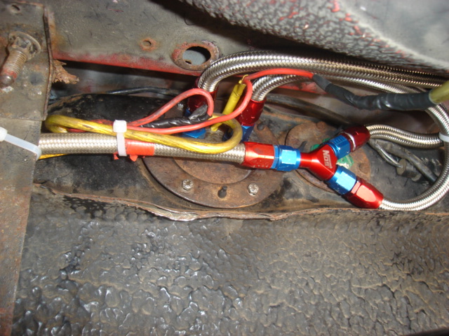

I use the twin intake pumps, 90 degree fittings out of the tank wit about 6-8" of -6 an line tbetween the pumps and the NOS y-block..then into the 1/2" hardline. You can see the y-block in the second video I posted in my build thread (did that on purpose for andrew) and if anyone cares to look closer at it, meet me up, or wait till the dyno/cruise. Reason I used that much -6 line between the block and pumps is I heard/red somewhere that the "pulsations" that occur between pumps could great issues, so with that long of line, it allows it more space to be filled, and negate those "dead" spots..if that makes ANY sense.

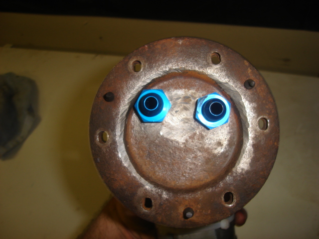

I used a Y. A T just didn't seam right to me and I didn't have enuf space inside the tank (FWD). I used two -6 bulkheads out of the sender a couple feet of fuel line and a Nos -6 Y.

I also ran a Y "NOS" brand fitting. I had around 8" of AN-6 from the tank bulkheads then it fed into the 1/2" line.
However with C-16, I was at the limit of my 880's for flow at the 50psi base pressure I had (even with a ported FPR), well atleast as well as my AEM could control them.
