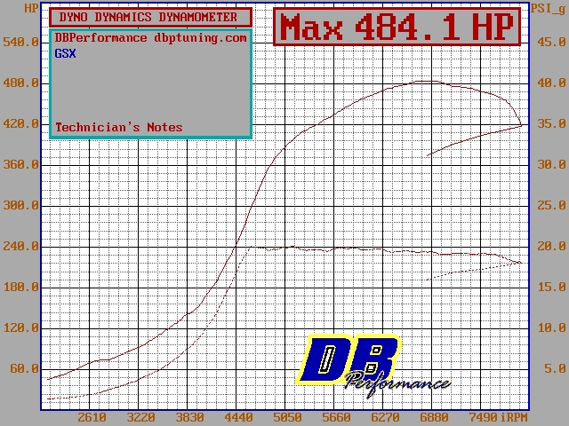

Here is one of my customer cars with a 2.4 stroker. He does have some FP cams, but it's 2.5" i/c piping, 1G TB, unported 2G head, stock 2G TB elbow, 3" off the shelf Apexi downpipe/cat-back. It's a real GT35R with the .82 A/R exhaust housing, no .63 or superchoker Mitsu bolt-on housing. It runs on E85 with some really low ignition timing because the owner doesn't know much about cars and likes to do 150mph highway pulls in 90 degree heat against anything he can find. Back when it was on pump gas making around 400awhp, we switched from HKS 272s to the FPs and really didn't see much difference on that fuel/power level.
We can get over the usual 450-460awhp on a single pump on E85 because of the boost it runs. More boost/fuel pressure, the earlier the pump maxes out. We stopped at that power level because of fuel running out though.
