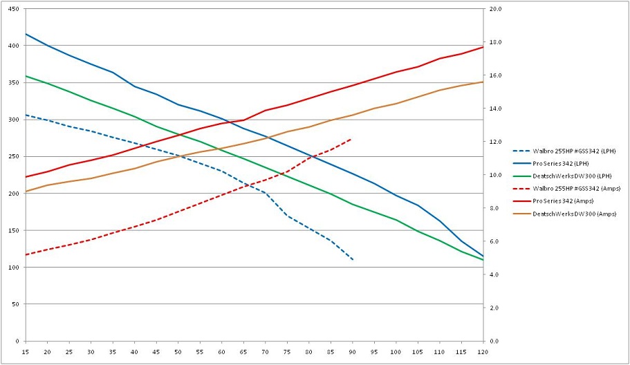

A flow chart for the Jay Racing "342," which is their competitor to the DW300.

So they posted some graph showing their pump is better?
Was there anymore info on the test?

Hrm, never saw that comparo before! Now I'm second guessing my choice of the DW300! Will interesting to see more real-world info on these.
