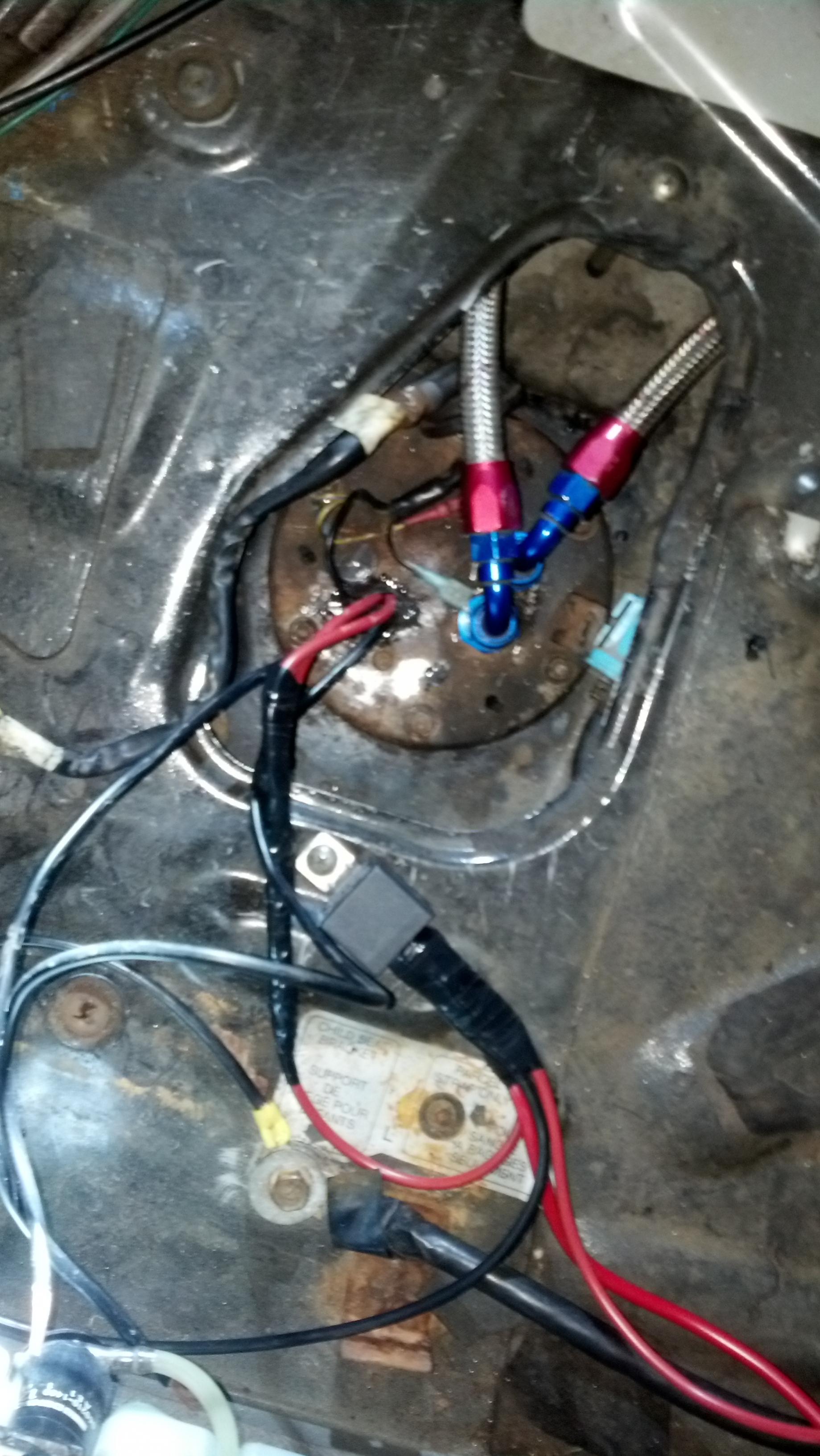

Not sure I'm completely following what he did. Its late lol. Here's a pic of my hanger. So if I don't do the bap dual 450s or maybe even cut the difference between the 450s and 310s and do the walbro 400 since it's quite a bit cheaper than the 450. Idk lol

Old 02-07-2013   #15
4seasons69
4seasons69's Avatar
Location: Circle Pines
Posts: 2,048
Re: boost-a-pump ?
I guess one of the main reasons I was considering the bap over different pumps was last time the car was on the dyno I was having a big voltage drop that was causing a large drop in fuel pressure. what should be mainly do to a dying alternator. Shane gave me a list of things to do to help prevent voltage drop to the pumps. Which I should have taken care of that list. I guess the idea of the bap was for a little added security in preventing any type of voltage drop to the pumps
